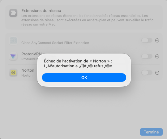

Unable to finalize Norton360 installation, blocked on “Network extensions activation”…but unable to uninstall with the Norton tool (error)
Detailed description:
Several weeks ago, I need to uninstall Norton360, to resinstall it my my Macbook Air M1.
But I had an error during the reinstallation, because I’m unable to activate the network extensions during the installation process.
I thought it was due to a wrong uninstallation, that could be resolved with MacOS 26 upgrade, but this is not the case. I still have this problem.
And when I try to uninstall it with the dedicated Norton tool, it doesn’t work either, uninstall failed with an error message.
I would also like to specify that I have the same problem on network extension activation with Proton VPN.
I tried all the solutions proposed on the Norton website (recovery mode, etc…), and today during a virtual chat session, it was proposed to look at MacOs logs and I indeed there is several messages in the blocking report section, about the Symbase.framework library missing
Product & version number: v25.10.1
OS details: MacOS 26.1
  • During the network extension activation try :
In french : “Échec de l’activation de « Norton » : L‚Äôautorisation a √©t√© refus√©e.”
Translated in english : “**Activation of “Norton” failed: Permission was denied.**“
  • During the uninstall process :
In french : “Echec de la désinstallation. Impossible de supprimer les extensions systèmes”
Translated in english : “Uninstallation failed. Unable to delete the system extensions”

Hello @Jul
Please confirm Norton Uninstaller does not help?
https://support.norton.com/sp/en/us/home/current/solutions/v20240130211511761
Please confirm RemoveNortonMacFiles does not help?
https://support.norton.com/sp/en/us/home/current/solutions/v102526177
Please confirm AI Mode does not help?
AI Mode
To resolve the Norton 360 installation and uninstallation issues on your MacBook Air M1, you must first completely remove all existing Norton files using the RemoveNortonMacFiles tool, and then adjust your macOS security settings to allow the necessary system and network extensions.
