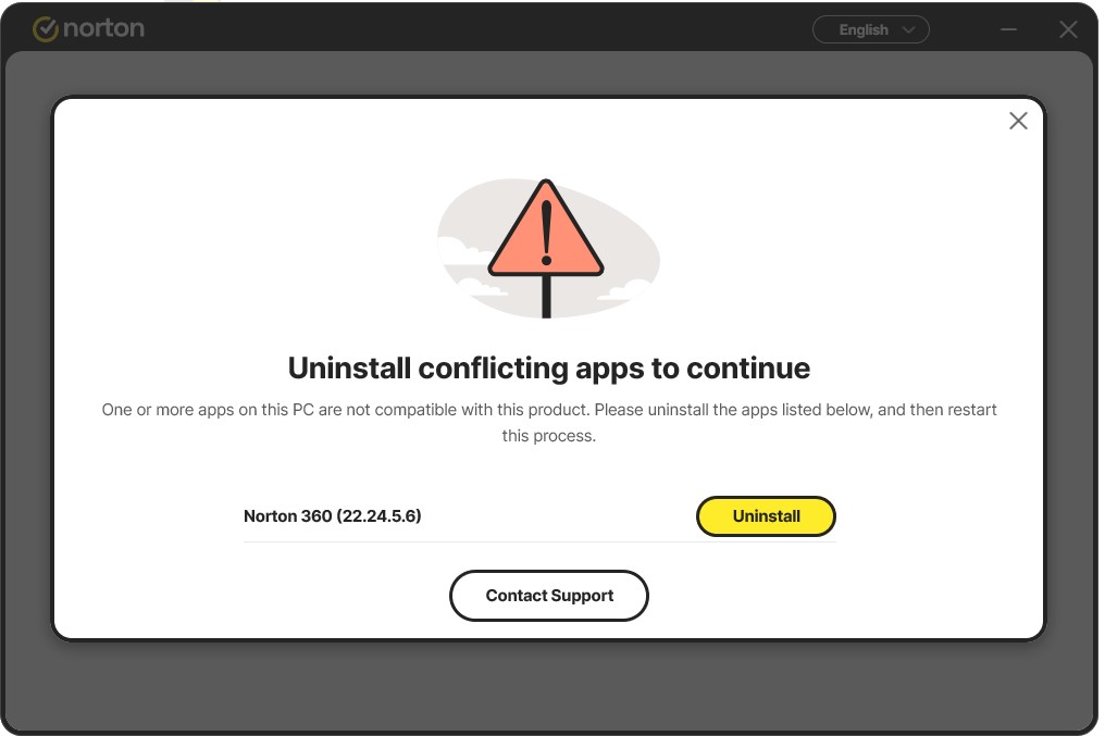

Today I reactivated my subscription, however I am unable to install because of the error during uninstallation of Norton 360 (22.24.5.6).
The error message is “Uninstall conflicting apps to continue”. It does give Uninstall button next to Norton 360 (22.24.5.6), but it doesn’t proceed with uninstallation.
On that screen it takes me to windows apps & features page where even if I select norton and selct uninstall, it says “Windows can not find C:.…\InstStub.exe”

Please find attached screenshot.
For the remove tool, try the older tool found here.. www.norton.com/nrnr .. Use the Advanced Remove only option and then restart your computer before trying to reinstall.
Thank you Peter, for your super useful and super helpful reply. I was able to proceed with this tool. Thanks so much again.
You are welcome. Glad I could help.
The Norton Remover tool was designed for the newer ver 24 and newer 360. Apparently it cannot handle the older ver 22 products.
