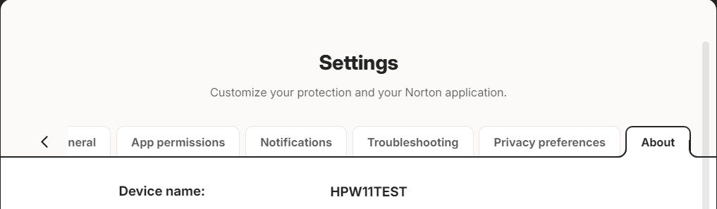

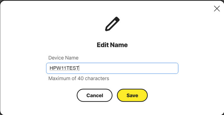

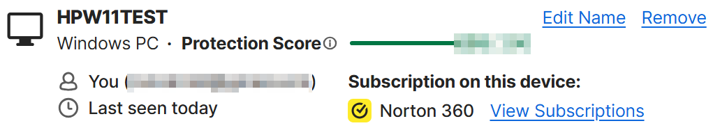

fwiw ~ I did a test with one device whose identity I already knew. I renamed it on the My Devices page, restarted the PC, and the new name then appeared under Norton Settings → About. So there does appear to be a way to use the Norton client itself to correlate a physical PC with its My Devices entry.
That said, I’m not suggesting this is a definitive 19-device solution — I’ve only tested it once, and I started with a device I already knew. It would need to be repeated on the other machines to establish whether this is consistently practical.

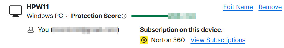

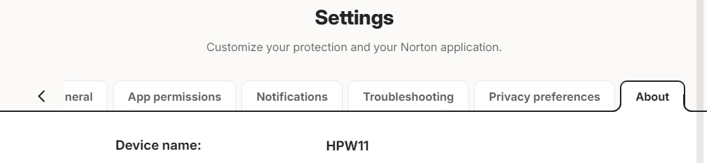

Note: the My Devices entry for my test machine originally was the Windows System Name (HPW11). I then renamed it to HPW11TEST on the My Devices page. The Windows System Name remained HPW11. After restarting the PC, Norton Settings → About showed HPW11TEST. So, at least in this case, the Norton device name appears to have initially been populated from the Windows System Name, but thereafter exists independently of it.
