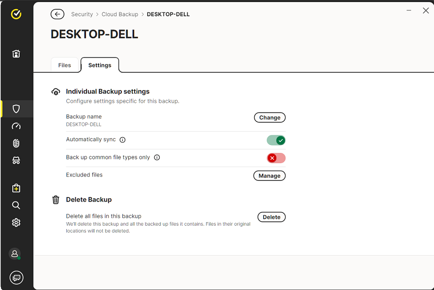

Hi, first time on this board (so traet me gently!), but I have used Norton for decades. First version was on floppy discs! Now having problems managing my Norton cloud backups since new release. Screenshot shows my issue. “Seagate Backup1” is full and backup set has everything greyed out. I can only “Restore”; not sync, manage or delete anything. Went online and, in desperation, DELETED the 74.9Gb backup (it is my “last resort” backup after 4 other copies, so not critical). Online Norton CP shows it deleted, but as I can’t seem to sync to Norton Control Panel, it still shows the same. How do I sync, so it will show empty storage and I can start again?
Or amI being stupid and missing something? I’ve wasted an hour trying to sort this already though!

You can no longer use local backups and you must use all of your cloud backup before it will open the local drives up. Based upon your screen shot, you have only used 0.1 Gb of your cloud storage. By deleting the backup, you freed up 74.9 more Gbs of cloud storage, so you have to backup 74.9 more Gb before your drives will show again.
Norton is forcing us to do cloud backups only. We are working to have this changed and most are reverting back to the previous version.

I’ve needed to opt Reset to Default…to clear My Backups and start over.
Note: there may be other way to clear My Backups. Sorry, I’m not aware…at this time.

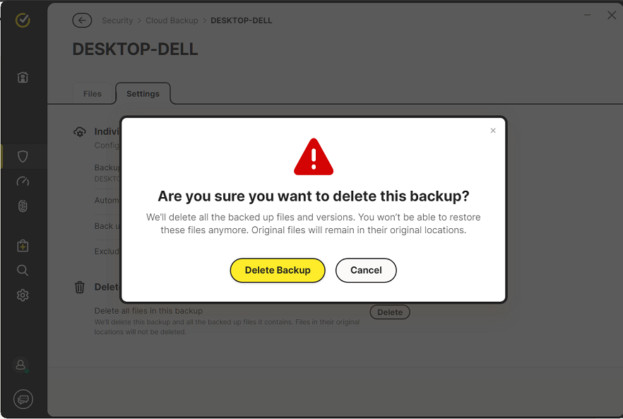

I’m curious…had you tried Delete Backup.
Note: afaik…Delete is not working…creating need to go online to Delete.
I’ve gone online to Delete and opted Restore to Default…to start over…a few times.

Delete Backup window does nada my side. I don’t know whether that’s expected or just me. Cancel works.
Reset to Default → No backups created yet
Thanks bjm. You are correct, the local “Are you sure you want to delete this backup” option
you showed does not work. The “button” (Delete Backup) reacts to a click, but nothing else happens. “Cancel” works. Looking at the other options you described.

Don’t ask me how I did it but, eventually, after almost giving up, I managed DELETE all backup sets and this did register both locally and online.
I created a new backup set and all seems to be working as it should, for now at least.
