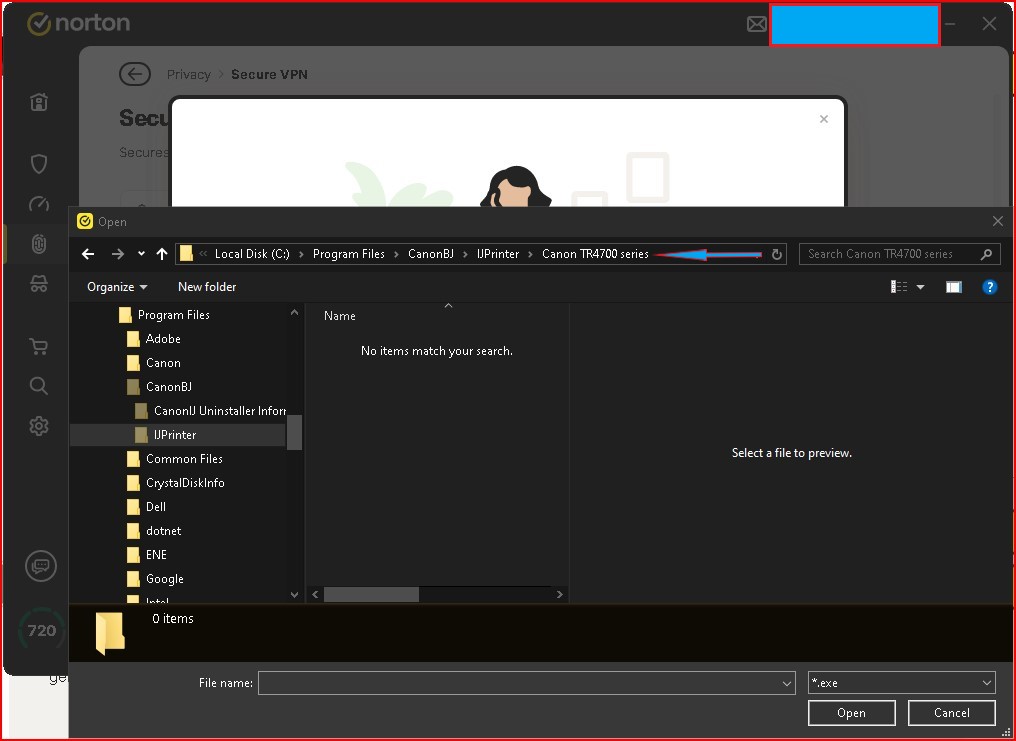

I am getting lost in item 3. After clicking Add Application in the new window, only thing I can find about printing is Printing_Admin_Scripts, right click properties A drop down list shows, but there is no Shortcut Tab. That is where I am getting lost.
There isn’t a shortcut, you will need to find the directory where your software is installed and add the exe file that starts the printer from there. Please review my screenshot as an example. My software for my printer resides in C:\Program Files\CanonBJ\IJPrinter/Canon TR4700 series. Hope that helps!
