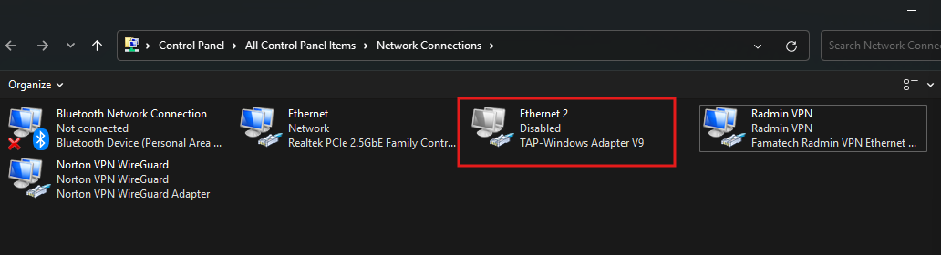

i had same problems, but after disabling “TAP adapter” - working perfect
