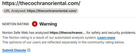

Website False Positive Been Waiting on Norton to fix 2 months now, HELP!
Website is giving false positive, and I cannot get anyone from Norton to help, myself and web developer have submitted multiple false positive reports and NOTHING. Should we just give up or is there some hack here?

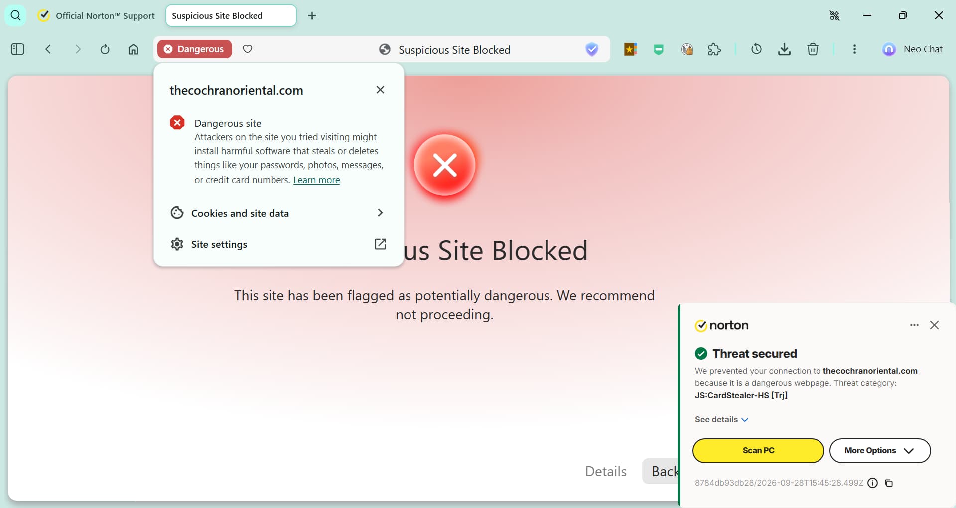

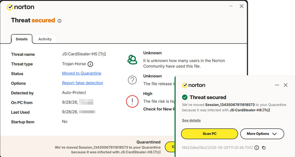

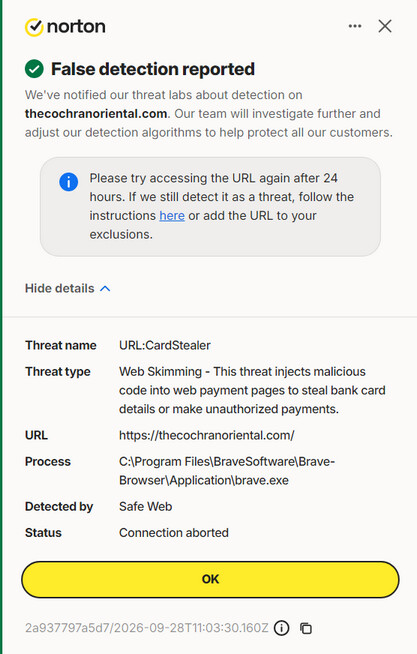

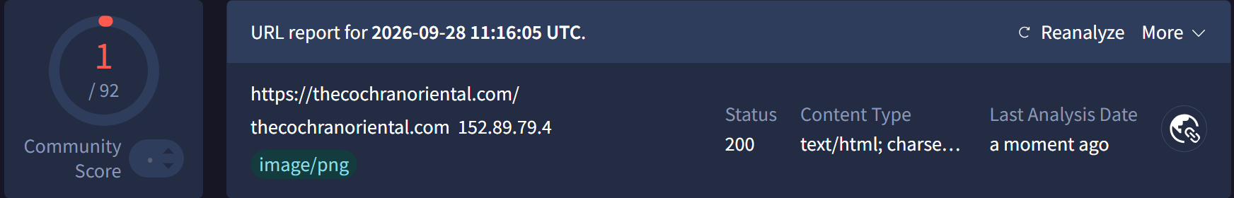

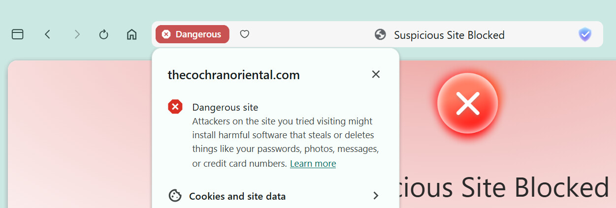

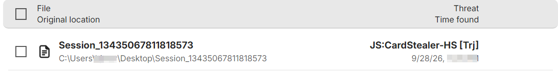

We’ll try to call attention:
https://thecochranoriental.com/

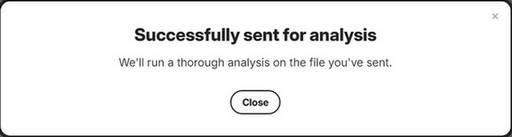

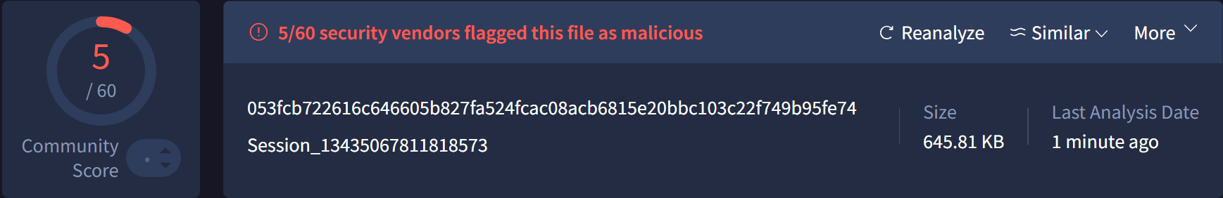

Threat name: URL:Phishing
URL: thecochranoriental.com
Alert ID: 20fc891232ab
2a937797a5d7/2026-09-28T11:03:30.160Z
610c812b2eaf/2026-09-28T11:24:47.827Z
f4623dbe05b2/2026-09-28T11:25:48.700Z
File: Session_13435067811818573
File size: 646 KB (661,309 bytes)
SHA256 checksum: 053FCB722616C646605B827FA524FCAC08ACB6815E20BBC103C22F749B95FE74
Date/Time: 9/28/2026

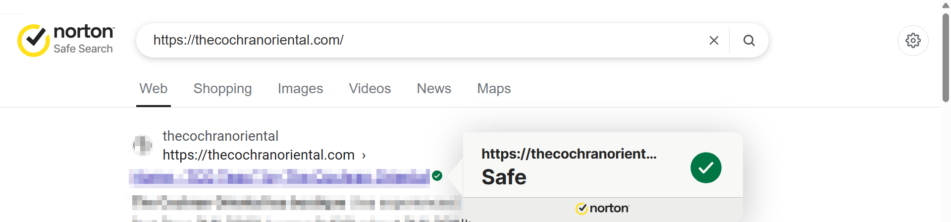

Hi @user13898
Thanks !

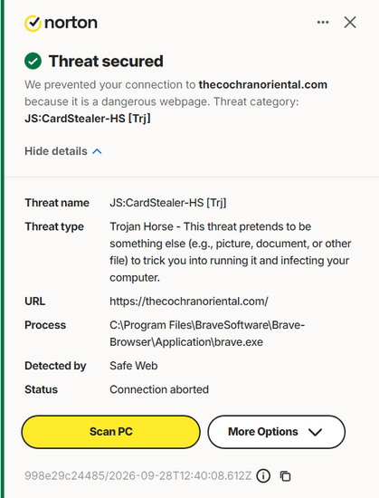

998e29c24485/2026-09-28T12:40:08.612Z

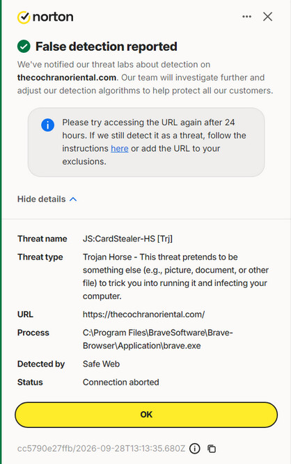

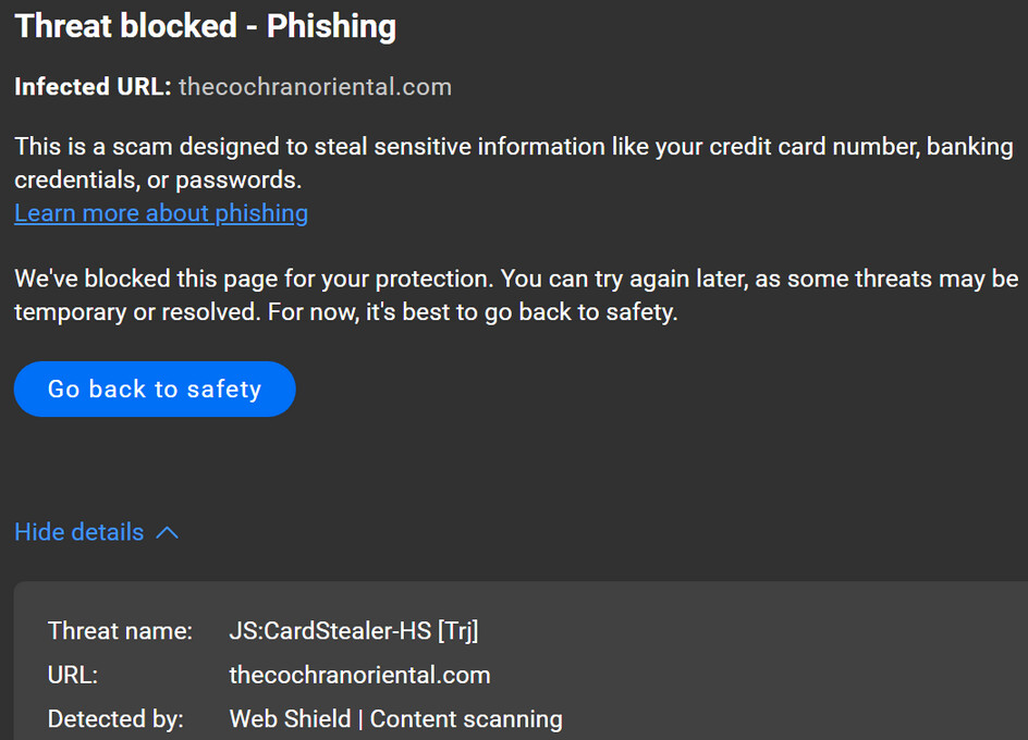

Threat name: JS:CardStealer-HS [Trj]
Detected by: Web Shield | Content scanning
cc5790e27ffb/2026-09-28T13:13:35.680Z
274deba90fd8/2026-09-28T14:23:46.182Z

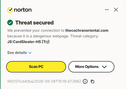

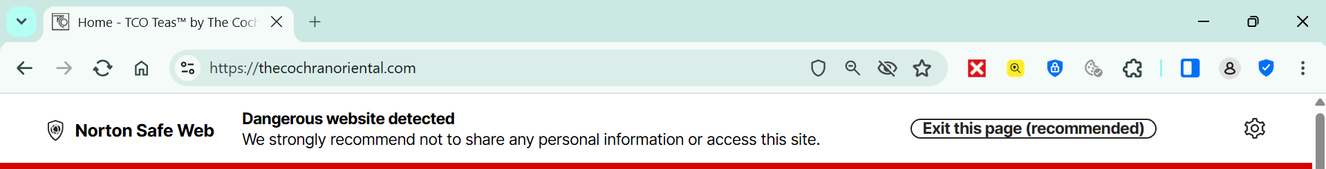

992137cd40ba/2026-09-28T15:19:47.396Z
+ 5 hours
92311e3bb5a6/2026-09-28T17:41:59.520Z
788e1343c1d7/2026-09-28T21:16:56.190Z

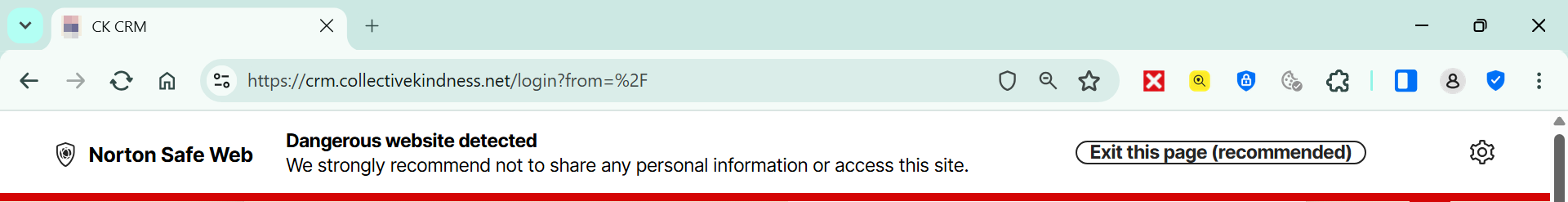

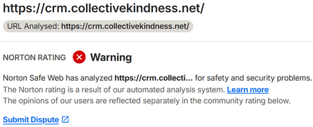

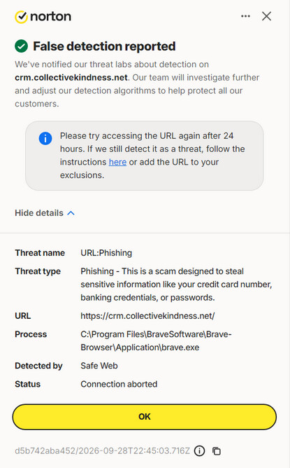

norton websage really needs to fix their bot detection
there is no reason why my site crm. collectivekindness. net is tagged as warning.
securi reports as having no isssues
Hello @user13912
Understanding Norton - Site Re-Evaluations
https://crm.collectivekindness.net/
https://crm.collectivekindness.net/login
URL: crm.collectivekindness.net
Alert ID: c1d0cddb32c2 | 7d048591ae19
d5b742aba452/2026-09-28T22:45:03.716Z
c93f518a194a/2026-09-28T23:04:10.715Z
ccc2ee213a94/2026-09-28T23:15:42.066Z

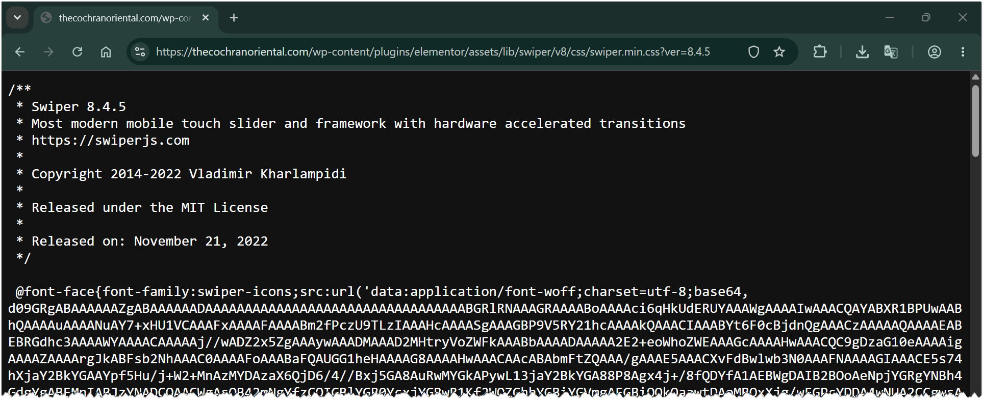

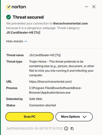

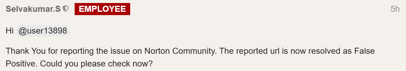

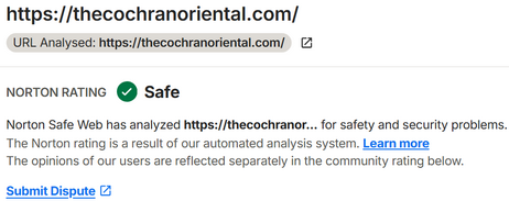

Hi @user13912
Thanks !
2a61f9dfcfb5/2026-09-29T10:17:15.702Z

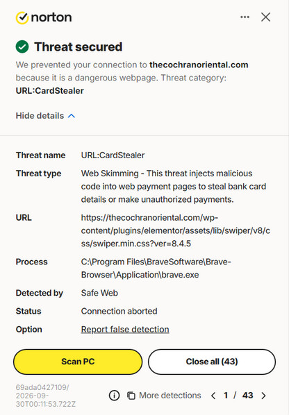

69ada0427109/2026-09-30T00:11:53.722Z
def1b78d9435/2026-09-30T00:11:55.016Z
d89a25f2fd5c/2026-09-30T00:11:55.086Z
08548d503a5d/2026-09-30T00:11:55.130Z
3146bef9da02/2026-09-30T00:11:55.219Z

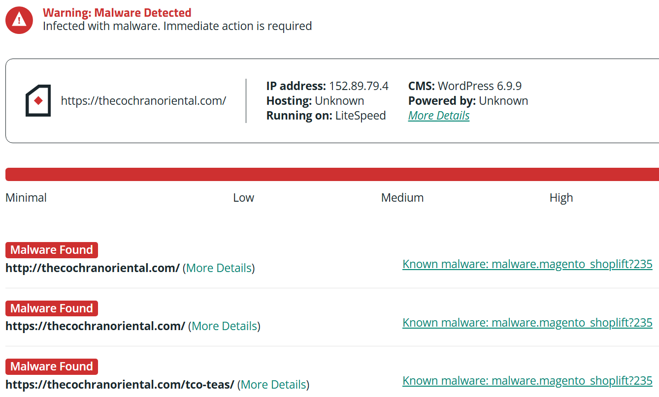

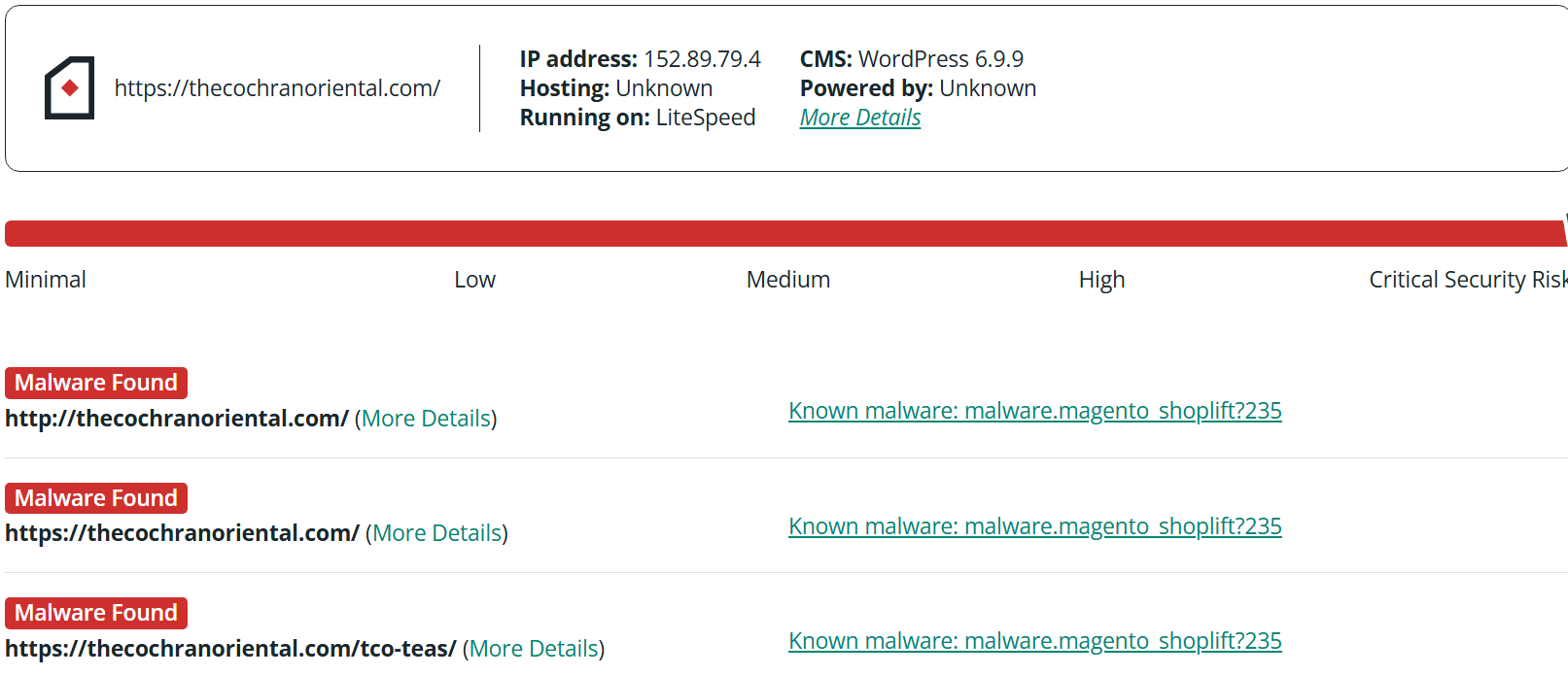

https://sitecheck.sucuri.net/results/https/thecochranoriental.com
This is from my developer, I sent this to Norton, you saying we still have problems?

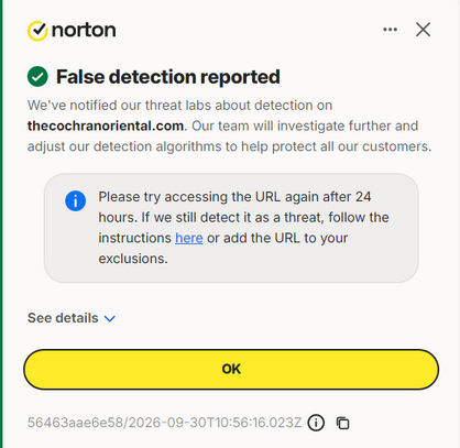

Hello @user13898
fwiw ~ my understanding = thecochranoriental.com is under internal review.
Hopefully, we’ll hear back soon.
Threat name JS:CardStealer-HS [Trjl
Threat type Trojan Horse - This threat pretends to be something else (e.g., picture, document, or other file) to trick you into running it and infecting your computer.
URL https://thecochranoriental.com/
56463aae6e58/2026-09-30T10:56:16.023Z

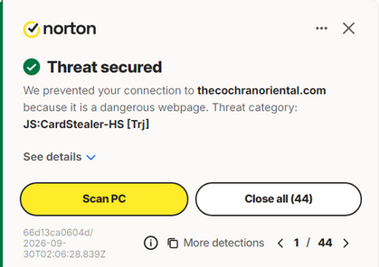

Threat blocked - Phishing
This is a scam designed to steal sensitive information like your credit card number, banking credentials, or passwords.
fwiw ~ Sucuri free tool Re-scan = Malware Detected
