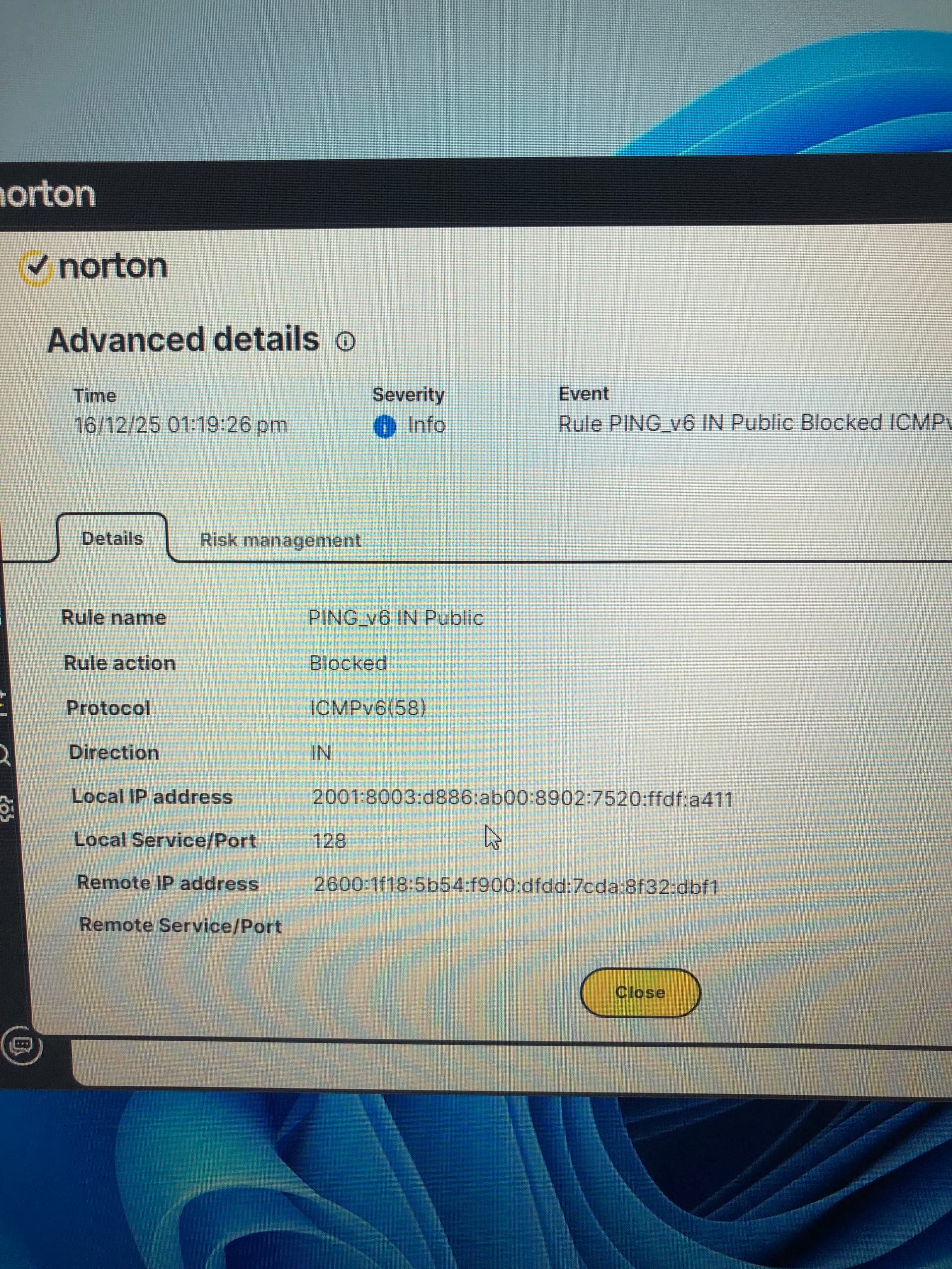

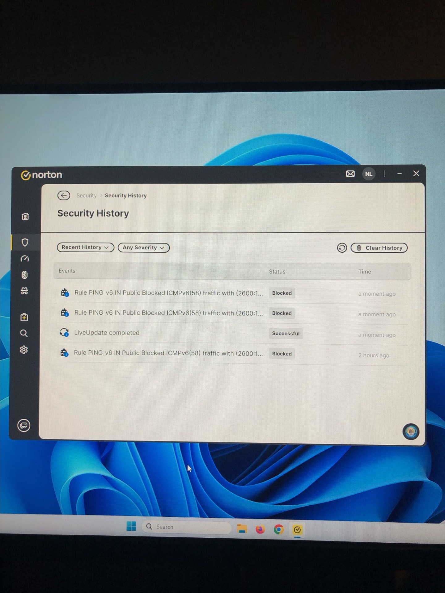

After updating to the latest version I have been noticing these blocked attempts every hour. I was a bit worried as I was unable to find anyone else with this issue.
Is anyone else using the PUBLIC firewall and having this issue?. I have made no hardware or software changes since the last Norton update
The IP address that is being blocked is coming from
OrgName:        Amazon.com, Inc.
OrgId:          AMAZO-4
Address:        Amazon Web Services, Inc.
Address:        P.O. Box 81226
City:           Seattle
StateProv:      WA
PostalCode:     98108-1226
Country:        US
RegDate:        2005-09-29
Updated:        2022-09-30
Comment:        For details of this service please see
Comment:        http://ec2.amazonaws.com
Ref:            https://rdap.arin.net/registry/entity/AMAZO-4
Any help? Have no idea what’s going on here.

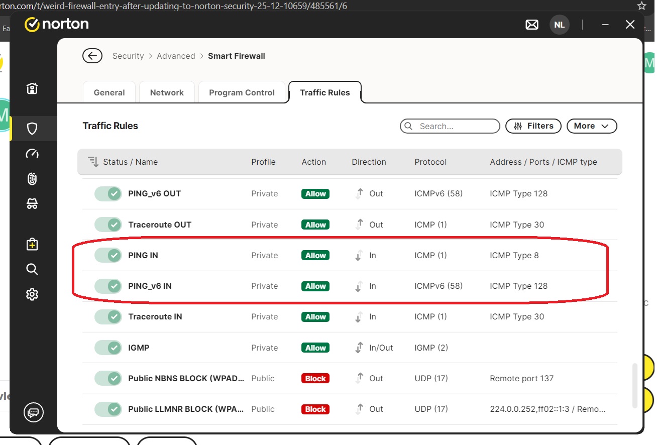

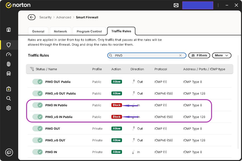

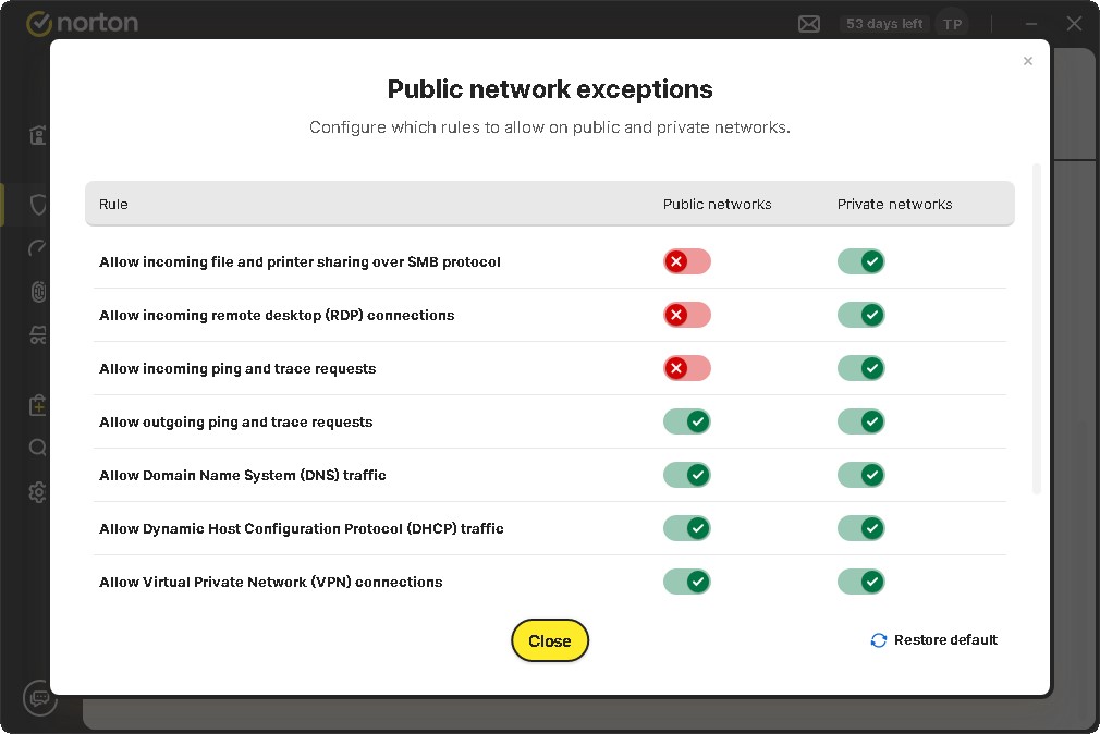

May we suggest, changing your network to Private and rebooting, then recheck. Additionally, is your connection WiFi or via Ethernet? I have IPv6 disabled at my routers and devices because its not a widely used protocol yet. Most ISP’s don’t require it as well. Pinging IPv6 if from outside is another device testing the connectivity of your device front facing the internet. That itself can be of concern, however, your history entries show its being blocked as the default rules in Norton firewall are hard coded for. Please review the screenshot below.
I am aware that changing to private allows these pings to go through and not be blocked. I looked at the Public VS private firewall settings and confirmed this. So to fix the problem I need to change to a private network which I don’t want to do or add a rule that allows those pings in a public network.

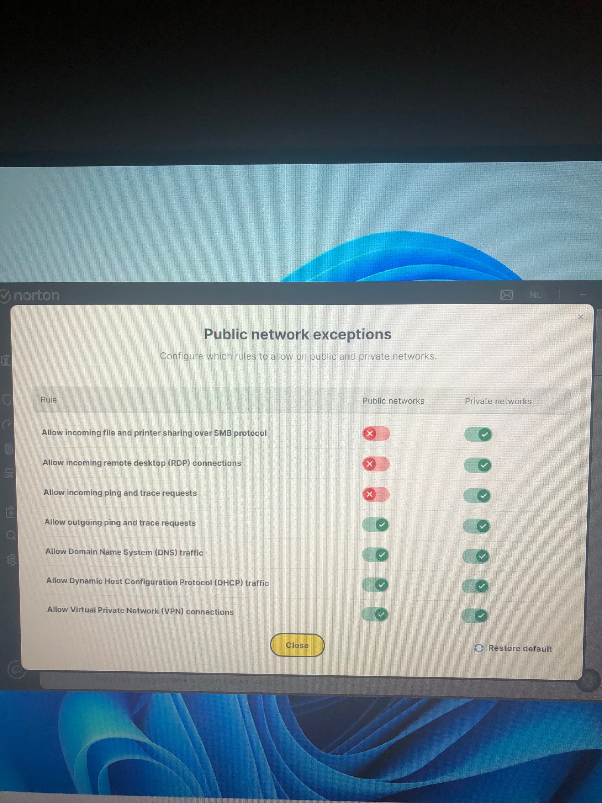

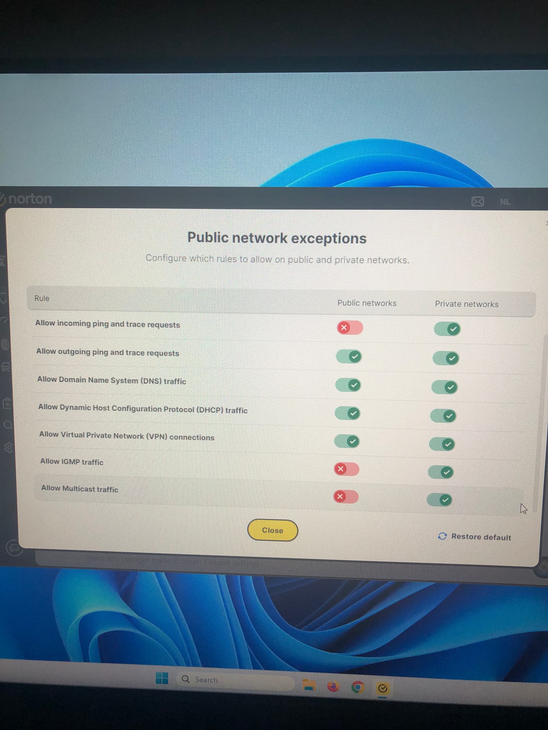

@Mykola You may also want to check your Public network exceptions. Without creating a new rule I’m not sure changing these will make a difference. You can test and see what your results may be.
I am not sure which of these public settings will change anything but I will try. Worst case scenario I just switch to a private network.
When you set the network to private the firewall allows these pings. So how bad can it be?

I would still like to know why I am getting these entries. I have been using Norton for 20 years and never seen this type of firewall activity
I forgot to say I am running an ethernet connection and ipv6 is enabled.
Why are you seeing these entries? Some outside device is probing your IPv6 connections. Norton is preventing that as your router firewall is rendered moot.
