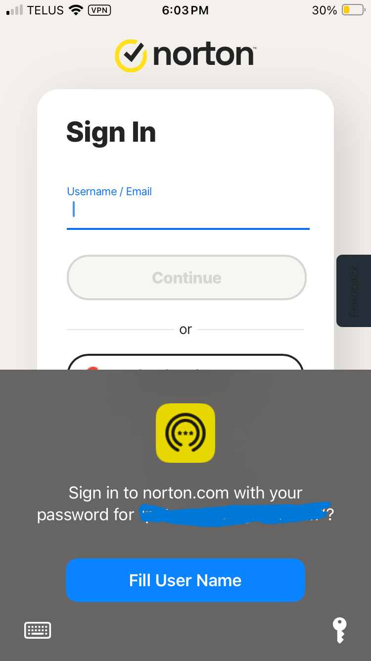

The Norton Password Manager on mobile devices installs as a separate app. It is not installed as a browser extension.
Once installed you can call up the vault access when you try to enter a login on a website or a supported app. I see an entry towards the bottom of the page offering to use the passwords.
