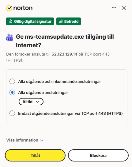

Why is this window coming up all the time, and what to do to cancel it
Issue abstract:
Detailed description:
Product & version number:
OS details:
@ The IP address shown in your screenshot indicates it is in Los Angeles, California USA.
https://www.ip-tracker.org/lookup.php?ip=52.123.129.14
It also does NOT appear to be a blacklisted address. Are you using Teams when this occurs? This appears, to be a Norton Firewall alert that something wants permission to connect to your network. If you are unable to verify its usage and need tell the firewall to block it. Check your Norton history for entries regarding this program.
