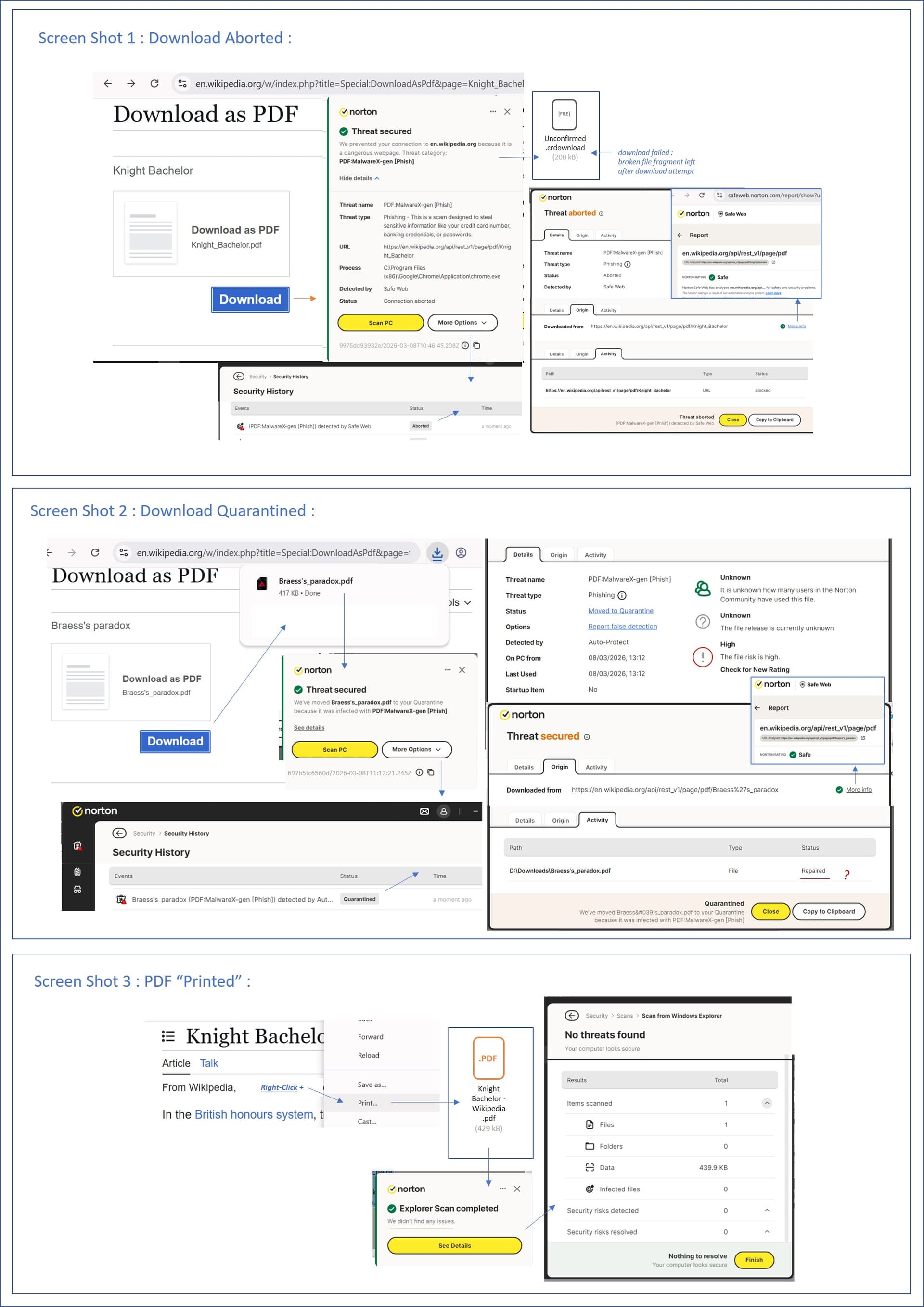

then one of (at least) two things will happen :

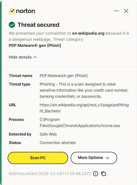

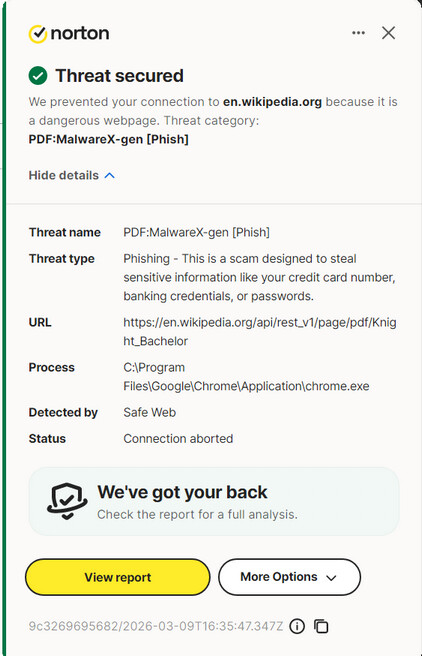

a) the download is aborted and the file cannot be downloaded at all
(see screenshot 1 with notes below)
or :

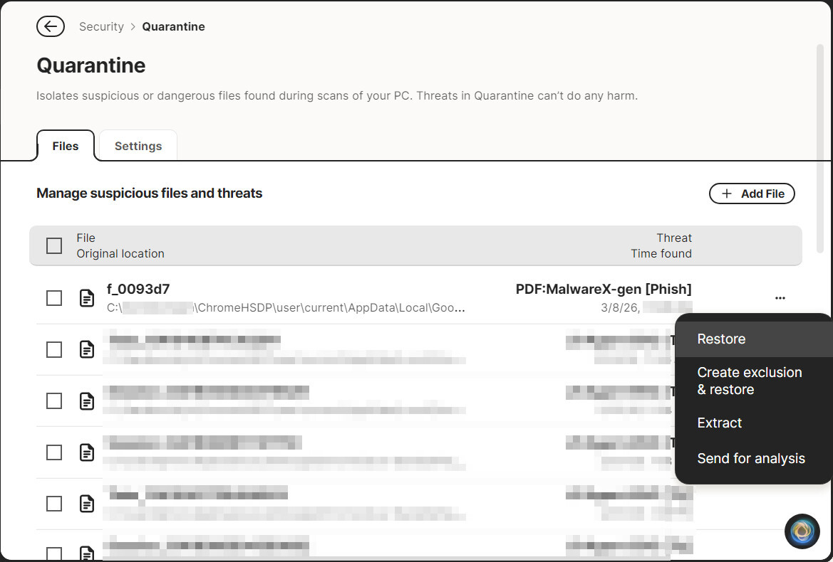

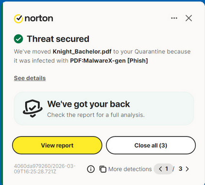

b) the downloading file is sent to quarantine,
and the event log then describes the file as having been “repaired” (?)
(see screenshot 2 with notes below)
Such .PDF download attempts always get flagged from certain Wikipedia articles,
(even after the articles themselves periodically get altered by editors within Wikipedia itself),
while pdf’s from other articles never seem to get flagged.
We are unsure how a legitimate website such as Wikipedia can be flagged for creating phishing pdf’s…?
Our initial thought was that perhaps certain hyperlinks within them are being regarded as dangerous…

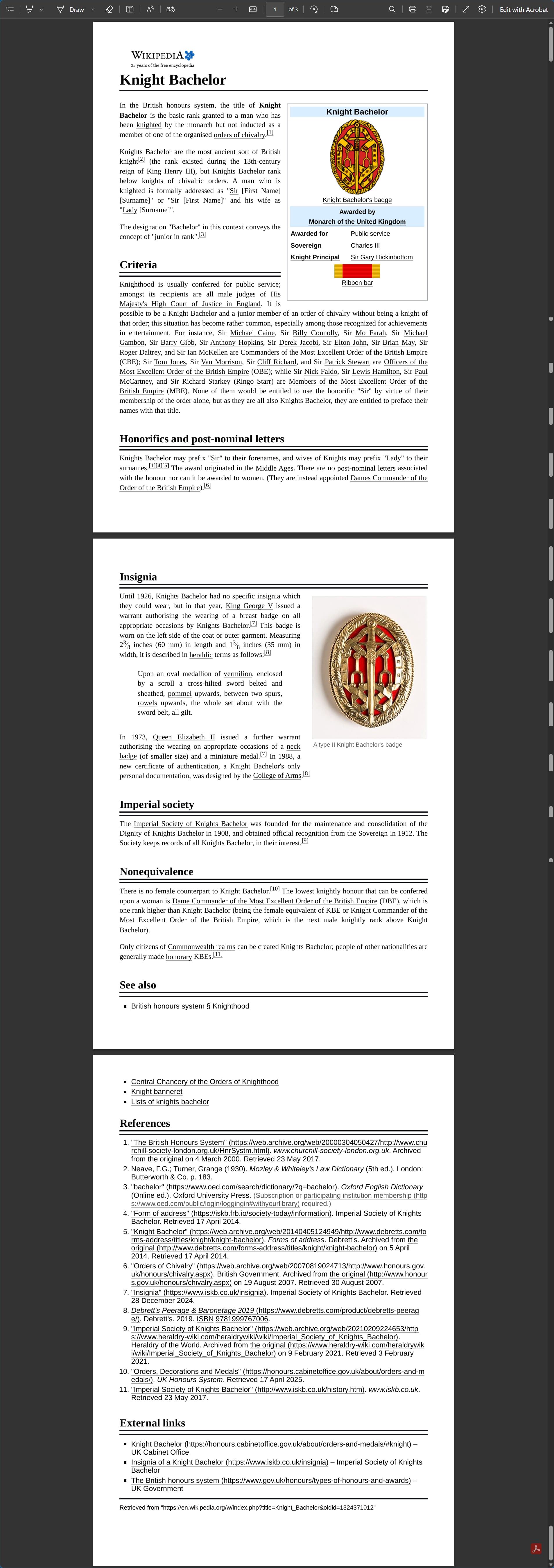

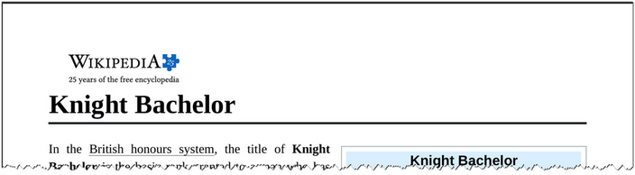

but this is almost certainly NOT the case, because whenever we use the browser’s basic :
Right-Click > ‘Print as PDF’ option
in order to simply have the browser itself create a direct .pdf of the same article
(which creates a resultant file containing essentially the SAME INFORMATION as the downloaded one : namely SAME text + SAME images + SAME hyperlink references, etc…),
Norton does NOT flag these ‘printed’ .pdf’s as containing any threats…(!?)
(see screenshot 3 with notes below)

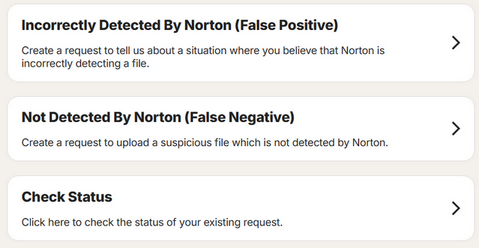

We know that we can upload the problematic files to support .norton .com
however what we would first like to ask is if other Community Members,
and especially the Norton Administrators here,
could attempt this for themselves with the two articles which we have noted at the top of this post, i.e. if you can test the issue ‘first-hand’, as it were,

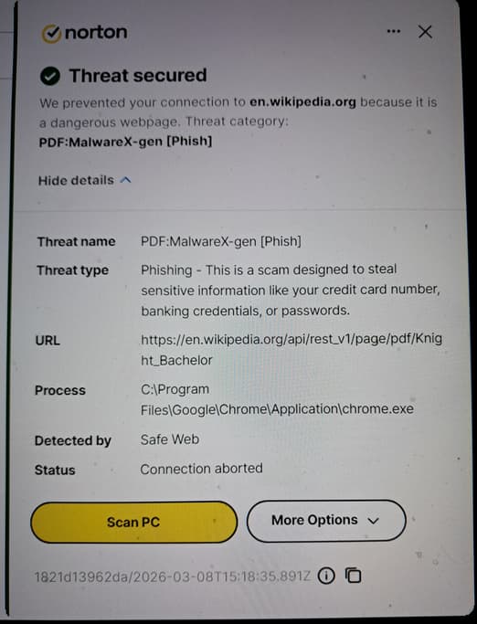

fwiw ~ as test:
Download as PDF → Download
1821d13962da/2026-03-08T15:18:35.891Z
fwiw ~ as test: Norton 360 Safe Web disabled
4001155532ac/2026-03-08T15:28:28.847Z

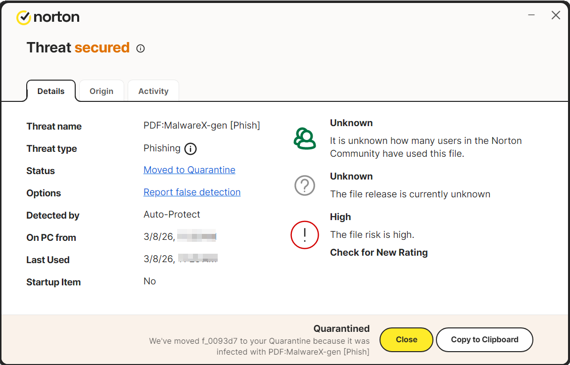

Threat name: PDF:MalwareX-gen [Phish]
Threat type: Phishing - This is a scam designed to steal sensitive information like your credit card number, banking credentials, or passwords.
Status: Moved to Quarantine
Options: Report false detection
Detected by: Auto-Protect
On PC from: 3/8/26,
Last Used: 3/8/26,
Startup Item: No
Unknown
It is unknown how many users in the Norton Community have used this file.
Unknown
The file release is currently unknown
High
The file risk is high.

Hello, BJM !
Thank you so much for your prompt personal test of the issue & for your reply : )
I’m glad to see confirmation that the issue is repeatable
and that it is not simply a glitch in our own system configuration!

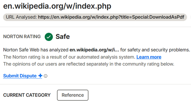

(It is also strange that hitting ‘more info’ in the detailed results
also shows a ‘safe’ result at safeweb .norton .com,
which can be seen in our original screenshots 1 + 2 above)
(and, we personally clicked on ‘report false positive’ in the norton GUI for the first time earlier today, so are also waiting to see if that will have any effect…)

The Norton Safe Web portal reports on the reputation of the entire URL you submit, including its specific parameters, but it uses the base domain’s history to inform that rating.
For the specific Wikipedia URL provided, here is how the portal handles it:
  • Granular Analysis: When you enter the full URL into the Norton Submission Portal, Norton evaluates the safety of that specific request (in this case, a PDF download trigger).
  • Domain-Wide Reputation: Because the URL belongs to wikipedia.org, a high-reputation domain, the portal will primarily report the “Safe” rating associated with the parent site.
  • Parameter Awareness: The portal’s AI content analysis examines the “text, code, images, and other hidden elements” triggered by those specific URL parameters (like action=show-download-screen) to ensure the download itself isn’t a masked threat.
  • Community Watch Data: If other users have reported that specific “Knight Bachelor” PDF link as containing a “drive-by download” or malicious script, the portal will flag that specific URL even if the rest of Wikipedia remains marked as safe.
Summary of Scope
Input Type What Norton Reports On
Entire URL Evaluates the specific file or action (PDF download) for immediate threats.
Base Domain Reports the general trustworthiness and historical safety of Wikipedia as a whole.

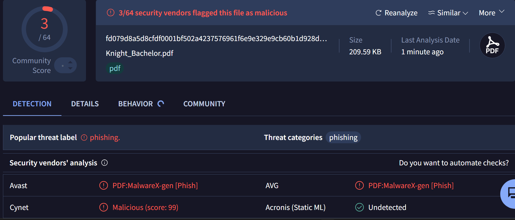

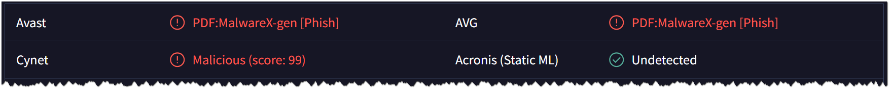

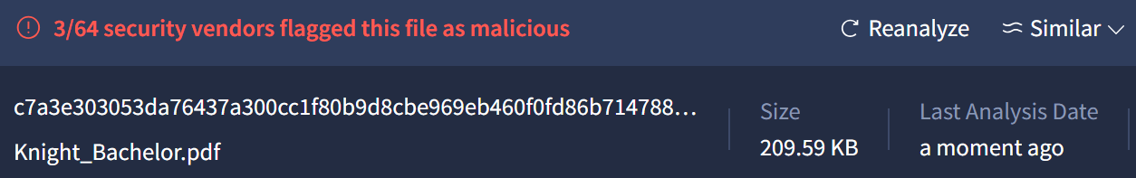

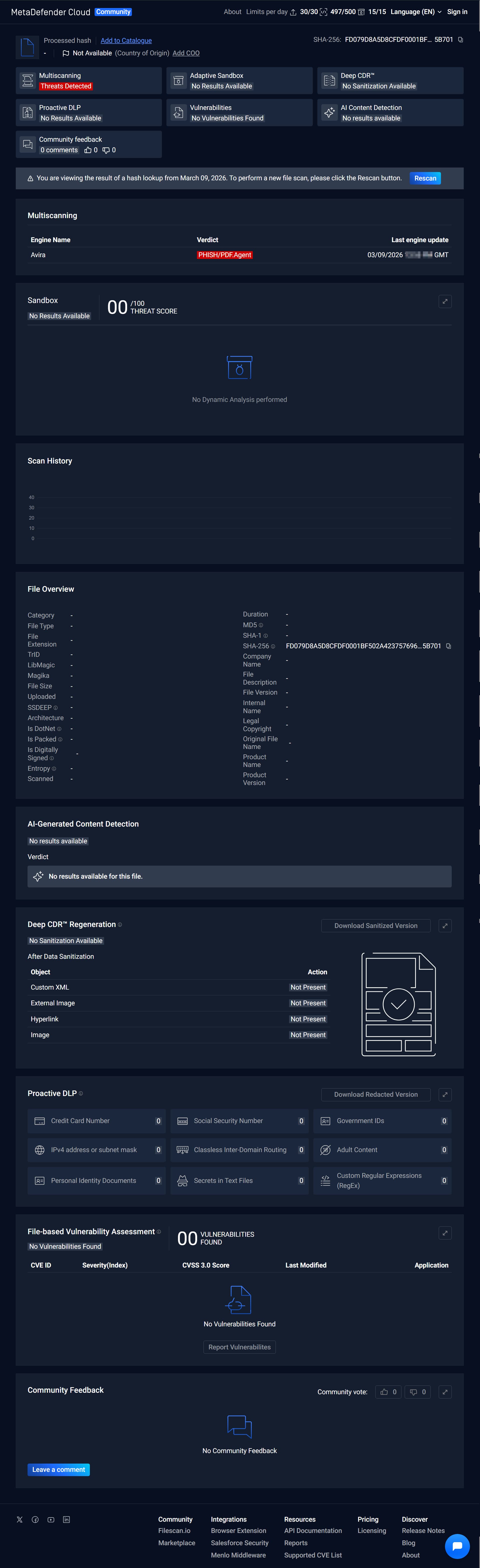

https://www.virustotal.com/gui/file/c7a3e303053da76437a300cc1f80b9d8cbe969eb460f0fd86b71478804cb81c9

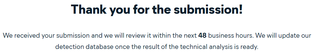

ok, I didn’t know that - thank you for the elucidation.
Regarding your testing at Virus Total… that didn’t occur to us. It is interesting though that only 3 vendors flag this as problematic (and in fact is that not really only two, since don’t Norton and Avast use the same (or at least similar) databases now?)
Thank you for submitting the file(s) to Norton Support - I expect the technical team there will look into the issue more robustly since an experienced Administrator like yourself is submitting it !
I hope their analysis answers the question of what Norton is finding in the downloaded .pdf’s that it is NOT finding in the locally-created .pdf’s of the same articles.

9d041eca40b2/2026-03-08T17:55:48.232Z

4060da979260/2026-03-09T16:25:28.721Z
d1bdf1486853/2026-03-09T16:25:32.285Z
75a8ad4501aa/2026-03-09T16:25:42.758Z
9c3269695682/2026-03-09T16:35:47.347Z
Status: Aborted
Detected by: Safe Web
Origin
Downloaded from: https://en.wikipedia.org/api/rest_v1/page/pdf/Knight_Bachelor
Activity
Path | Type | Status
https://en.wikipedia.org/api/rest_v1/page/pdf/Knight_Bachelor | URL | Blocked

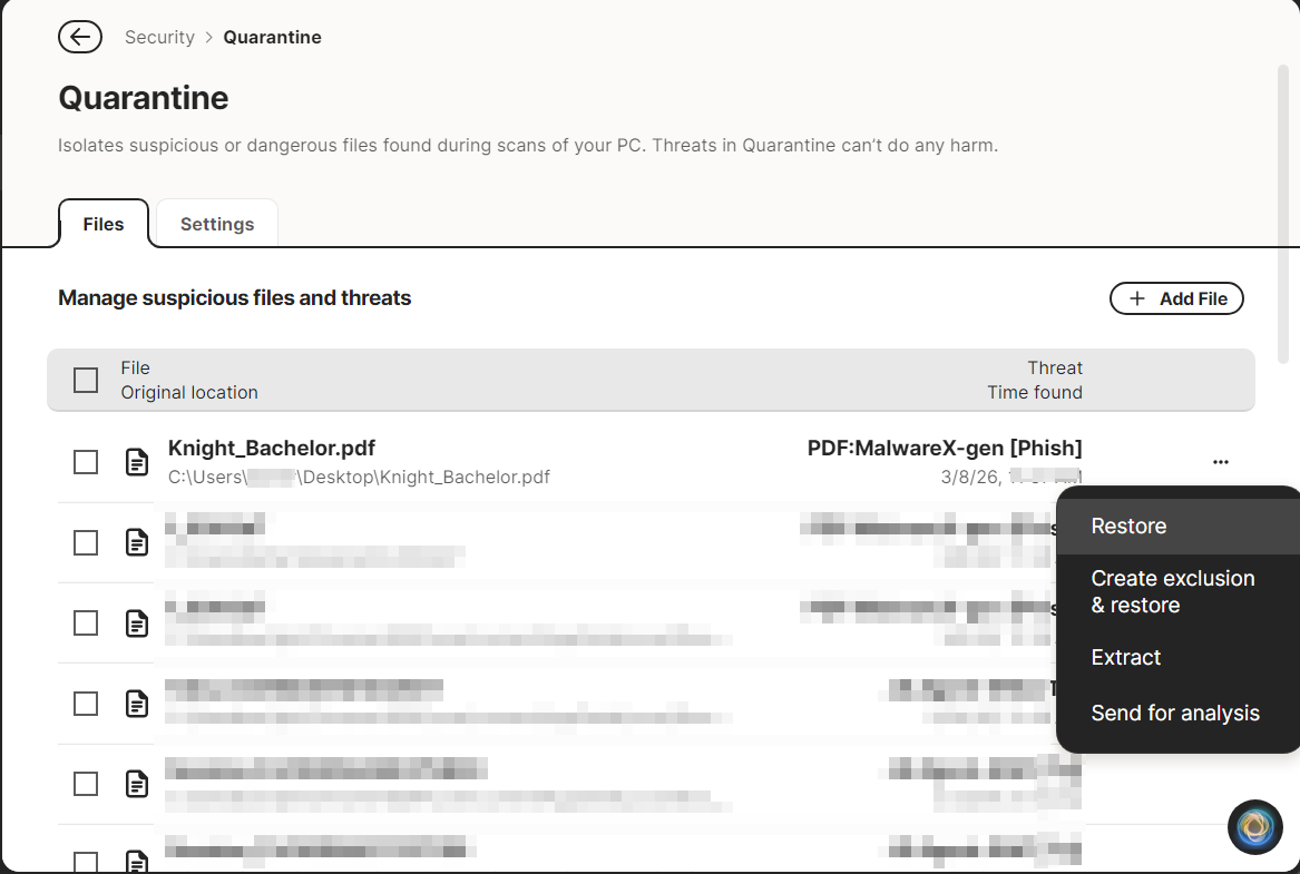

fwiw ~ as test: Create exclusion & restore + Disable Auto-Protect
File: Knight_Bachelor.pdf
File size: 210 KB (214,620 bytes)
MD5 checksum: 09457C58692EEC1EB6BA13091109AA7A
SHA1 checksum: 9C5D0DEB08D6003C4AB7B559981F742BC1F3F682
SHA256 checksum: FD079D8A5D8CFDF0001BF502A4237576961F6E9E329E9CB60B1D928DD3A5B701
Date/Time: 3/9/2026

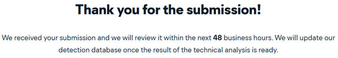

By the way, @bjm , I would like to ask whether you ever received any personal reply from the norton technicians with respect to the files and url’s that you initially submitted for analysis last month ?
NN
Hello @nn123
fwiw ~ my understanding:
  • Lack of Confirmation: The current Norton Submission Portal does not send automated confirmation or status update emails, even when an email address is provided.
  • ID-Less Submissions: The new platform (specifically for Norton v24 and newer) does not generate a visible tracking number upon submission, making it impossible to check status manually.

with respect to these two links,
it seems that the second one redirects to the first in any case : )
(although I cannot see where the Request ID is generated - the ‘Check Status’ button asks for the user to enter such an ID, rather than providing one…)
Anyway, as far as I can see, the Norton GUI itself has a :
  • “Report False Detection” button in the “Threat Secured” pop-up window
    which comes up as a threat is intercepted, as well as a
  • “Send For Analysis” button in the quarantine list
    (when you hover over a file in the list, a three-dots icon
    appears at the right side, leading to a drop-down menu)
both variants lead to the same place : namely a further window where the file is automatically pre-attached, with radio buttons for whether the user wants to submit (what they think is) a false positive or a false negative, and a space for adding free text notes on the issue.
I guess this option is even easier (and safer) than going through the website and uploading the file, albeit a .zip/.rar, since the user would need to disable their AV in order to create the archive in the first place!
p.s.
submitted that one final file through the gui. hopefully it will give some greater elucidation to norton technicians on this wider issue, due to being so much more ‘insidious’ than the others!
