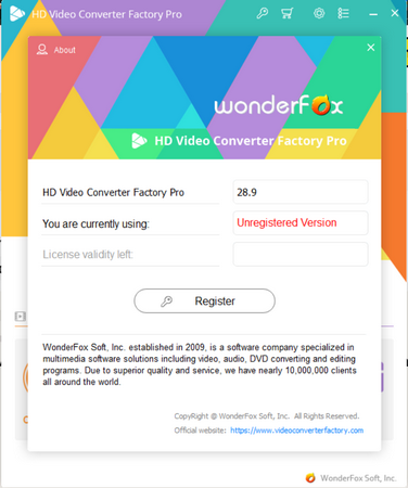

WonderFox HD Video Converter Factory Pro 28.9 installed on W11.
The application installed, launched, and successfully performed a manual update check without triggering Error 12175. However, my copy is unregistered, so I did not test license activation or license verification functions.
