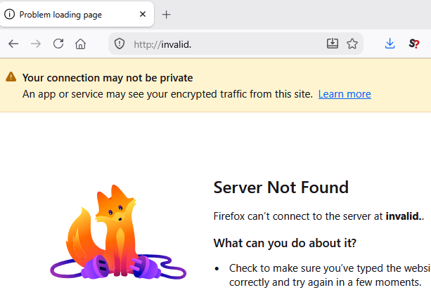

Also, screenshot of Firefox’s warning message. Only seems to display if Firefox can’t connect to somewhere, and SSLKEYLOGFILE is set. The URL in the screenshot is guaranteed to never connect anywhere, so is a good way of testing to see if the warning is coming up or not; be interesting to hear if other Norton users are also getting this warning. From the date of the article it links to, it looks like this warning might be relatively new.

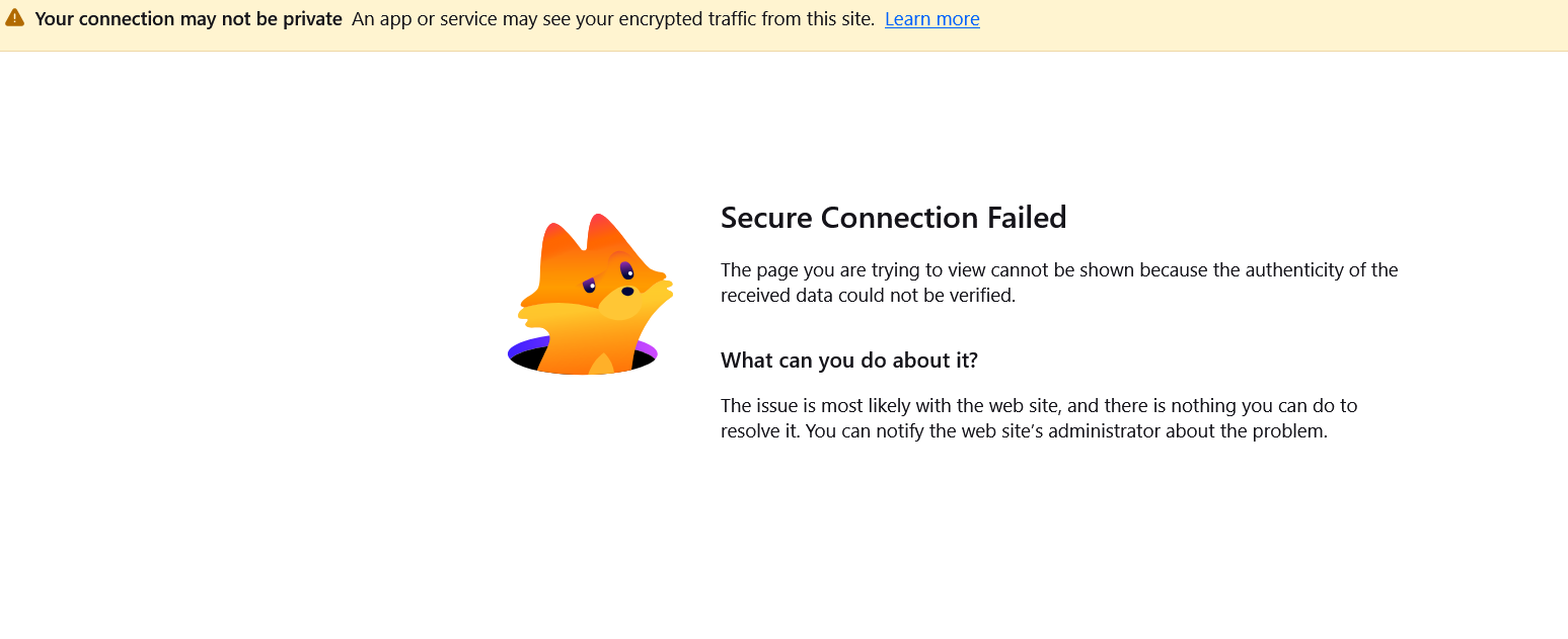

Yeah I can confirm occassional connectivity problems with sites too, such as “Content-Encoding Error”, which then disappear upon refresh. Was originally how I encountered the “Your connection may not be private” warning in fact. Has only been happening in recent months.
Amazing; thanks for all this. This would strongly suggest that an SSLKEYLOGFILE of \\.\nllMonFltProxy\… is from Norton and not malware. I’ve run whole system scans with Norton and MalwareBytes as well and neither detected anything.
Also, can confirm upon updating to Firefox 155 this warning has been made more prominent; I’m now seeing the following too—
The timescales mentioned appear to match when the “Your connection may not be private” warning was supposedly implemented in Firefox; the article it links to suggests Firefox started warning about SSLKEYLOGFILE from mid–late June 2026.
