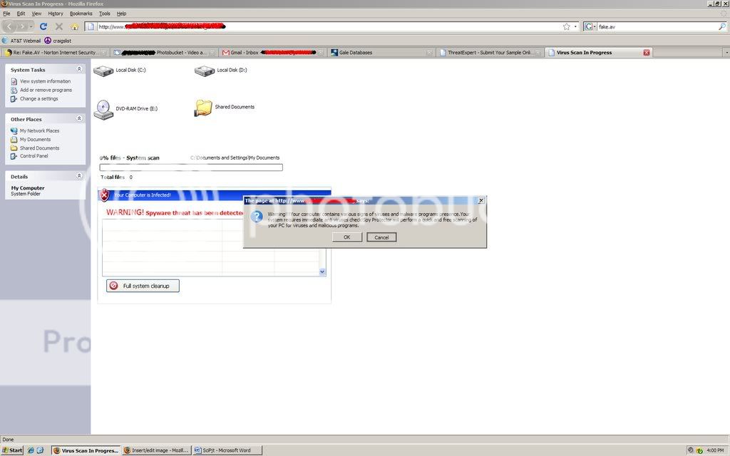

All did not even flinch when I downloaded the file and the site claimed to scan my system and showed me a list of ... 100320 infections ... I thought that Norton 08 blocked 100% of Fake AV scanners...
It also saved a file on my computer:
http://www.virustotal.com/analisis/32b6ae67d4bec770a8ca74a247b491f0
[edit: removed link per the Participation Guidelines and Terms of Service. Please do not post links to malicious websites]
Message Edited by Tim_Lopez on 11-29-2008 06:39 PM

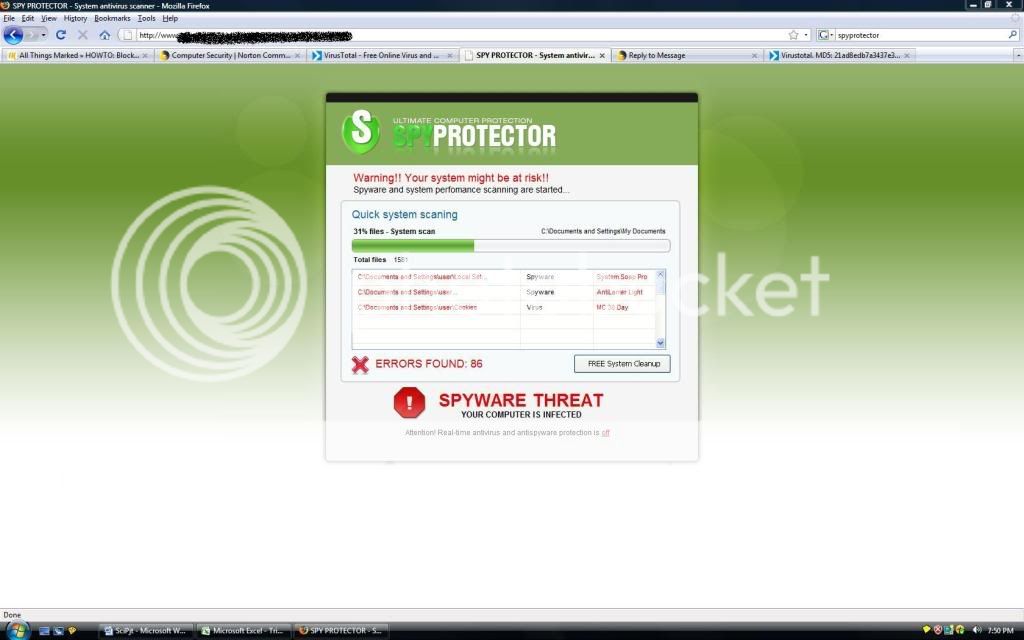

I took a step further, and installed this spyware just to check my findings on another thread of mine.
Again, AGAIN it is Windows Defender that takes action and cleans this crap, while Norton Internet Security 2009 sits on its **bleep** and does NOTHING!
Symantec should be really ashamed, their antispyware engine is so substandard and behind the curve it is astounding!
Message Edited by TomiRed on 11-29-2008 07:14 PM

This sucker managed to call home and report something to [Removed Link]
When you trace this address, it is located in the town of Herndon, in Fairfax County, Virginia.
If you direct your browser there, it downloads a file g347.exe.
This is the Virustotal analysis for it at the moment: link
[edit: removed link per the Participation Guidelines and Terms of Service. Please do not post links to malicious files]
Message Edited by Tim_Lopez on 11-29-2008 06:44 PM

Re: Fake.AV
The cached version of a older version of this web page was updated. As a result, I could no longer access the original website to obtain a sample. I found a similar website and downloaded the file.
The VirusTotal anaylsis is here: http://www.virustotal.com/analisis/5bcb220d7dcb4b5aba08786ace0fd9a6
Looking at it, Symantec once again fails to detect this variation.
I executed it from within Sandboxie. It failed to start; as you will see in the posted screenshots. Apperantly it tried to disable essential services; such as COM+. It also tried to disable the Recycle Bin! and tried to hijack Windows Explorer =(
Such behaviors should be reconigized by Bloodhound! Or be incorporated in the signatures!
Message Edited by Tech0utsider on 12-02-2008 08:03 PMMessage Edited by Tech0utsider on 12-02-2008 08:04 PMMessage Edited by Tech0utsider on 12-02-2008 08:08 PM

Re: Fake.AV
Allrighty. I reliazed that running Sandbox w/o Admin priv. resulted in the errors =(
I have recorded several screenshots. SpyProtecter was activily running in memory and SONAR did not flag a single thing. Shamful. I'll leave it up to you guys. In the mean time, I am seriously considering SpyProtector KIS09. It may have "many" false positives, however I can deal with those, since the FPs stem from malicious program alerts. Maybe 2010. =\
Kudos to Sandboxie!
And the Main GUI has some interesting sound effects, like shattering glass when closed and mines going off when files are being detected as malicious...=P Message Edited by Tech0utsider on 12-02-2008 08:31 PM
好评1 Stats

Re: Fake.AV
The first time, I executed the Sandbox with Restricted Privileges. That is why Sandboxie reported that several actions had failed; I simply did not have the permissions to ... disable the Recycle Bin ... or disable COM+
So, I executed it as an Administrator, which is not the default option in Vista. I used the context menu option. This time, SpyProtecter hijacked most of my computer. However, as you can see in the screenies, SpyProtecter had failed to create at least 1 temp. file, where malware often hide, such as in the case of Vundo/Virtumonde, which I was complaining about in another thread. Vundo/Virtumonde infects the browser cache and executes from there.
That was the only obvious pitfall of my experiment. SpyProtecter was unable to create that paticular file. That could have triggered Norton. However, I doubt. =\
The Heuristics were set on Aggressive. Despite that pitfall, Norton should have been able to detect the actively running malware, which is known to download a malicious payload.
And Norton was the only security software loaded. Windows Defender was disabled via MSconfig and Services.msc. SpyProtecter is not a security suite ...
And Sandboxie was not perfect. It allowed SpyProtecter to create a shortcut on my desktop. Other than that, I was ok. Phew!
