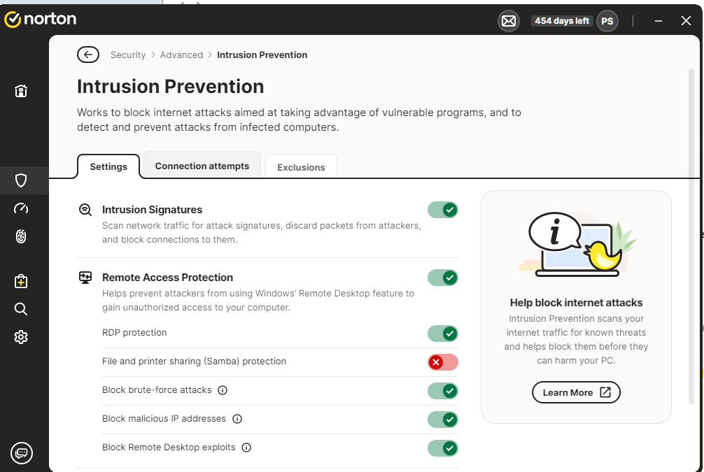

This is what worked for me. I have a file server and it was updated the other day, all my other PC’s are Win 10 and can all access my network drives. However, my Win 11 laptop can’t access those drives.
I went to the server and it had the same message on it that you posted. I went into:
Security>Advanced>Intrusion Prevention (select the ‘gear’). I ended up just turning off Remote Access Protection. I had tried other settings and even setting an exclusion for the laptop’s IP but no dice. As soon as I shut it off my network drives came back on-line to the laptop.
Holy s##t!
It was fixed for quite some time, but I had to reinstall win11 pro on the SAME laptop & the problem has started up again… I can’t even remember how i fixed the problem last December!
AHA - disabling “File and Printer sharing protection” works!

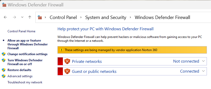

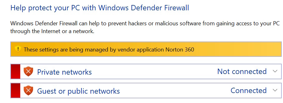

What a bunch of BS! now i’m getting this on WIN11 machines from Windows Defender:

…“this” is my W11 machine
Note: Proton VPN was a trial…since, removed.
not on MY PC’s, with the latest updates from Norton!!
Proton VPN trial was not from Norton
regardless…this is normal
& what has Proton VPN trial have to do with the fact that “… managed by vendor application Norton 360”???
Well, nothing. I was simply noting that my Recent networks here listed Proton VPN.
weren’t you referring to “managed by vendor application Norton 360” here
Hi globus5000. refer to my December, 2024 post (second from the top of this page)

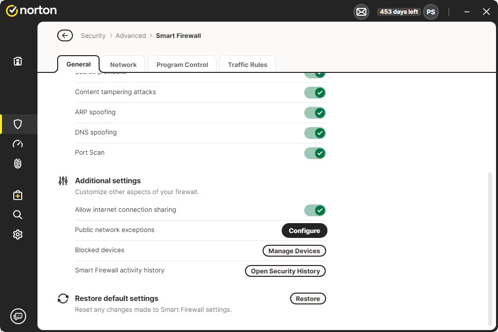

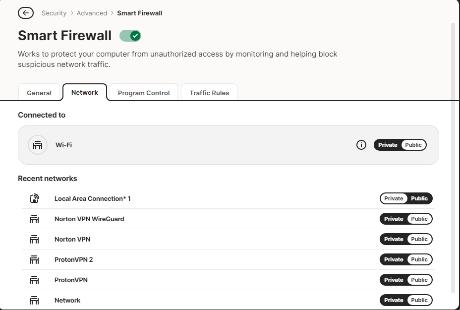

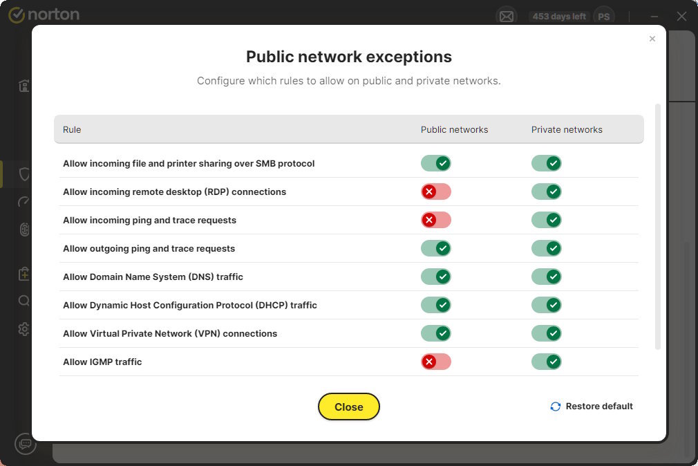

these are the settings that DO NOT block PCs on the same LAN:
I forgot to add this to my post above… but if you use your laptop on a Wi-Fi network you do not control, simply put everything on PUBLIC!
