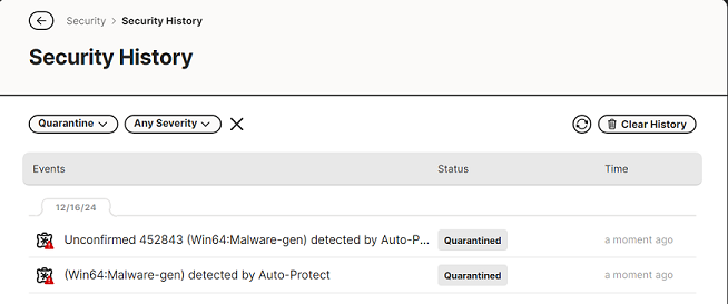

Hello @Ajaypal_Yadav , @SoulAsylum , @Dolphund , @SteveM_Humphrey
On one of my v24 machines my quarantine has about 20 entries ranging in date from recent back to 2018. I used notepad to look at the contents of the vault.db file in C:$AV_NLL$VAULT. There are about four full-screen pages, and to me it looks entirely like Asian-language symbols (e.g. Chinese, Korean, Japanese).
