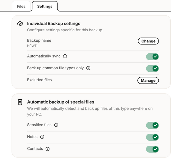

In Norton 360 v24+, “Common File Types” refers to standard media and document formats that the software automatically includes to simplify the backup process. While Norton does not provide a public exhaustive list of extensions, these are generally recognized as the following:
  • Pictures: Common formats such as .jpg, .jpeg, .png, .bmp, .gif, and .tif .
  • Music/Audio: Standard files like .mp3, .wav, .wma, .m4a, and .aac .
  • Video: Formats including .mp4, .avi, .mov, .wmv, and .mpg .
  • Documents: Standard office files such as .pdf, .doc, .docx, .xls, .xlsx, .ppt, and .pptx .
Special File Types
In addition to common files, v24+ includes a separate category for Special File Types, which are often excluded by default unless toggled on :
  • Sensitive Files: Items containing addresses, bank details, or passwords .
  • Notes and Contacts: Saved contact lists and digital notes stored on your device .
Important for Your Adobe Files
Adobe project files (like .aep, .prproj, or .psd) are not typically considered “Common File Types” in these broad categories . To ensure they are backed up, you must manually add the specific files or their containing folders using the Manage Files option in your Cloud Backup settings
