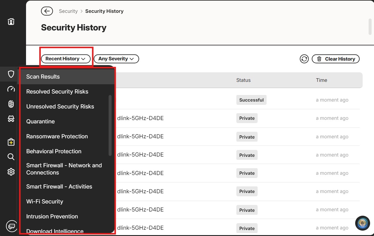

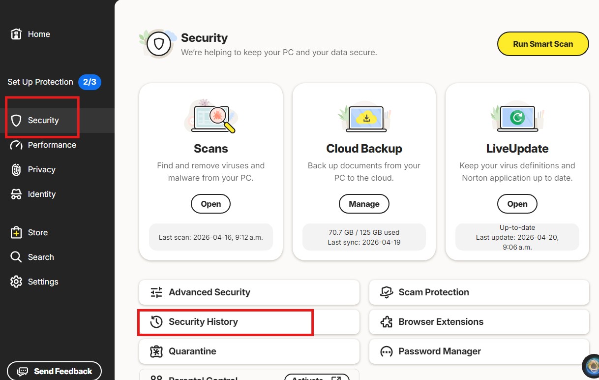

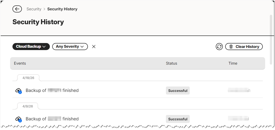

You can check your Norton Security History for your backup status. From the 360 interface click on Security on the left side and then click on Security History. Then click on the drop box that defaults to Recent History, and scroll down to and click on Cloud Backup. That will show whether your backups have been successful while you were not logged into the Backup in the 360 interface.

What does Cloud Backup → History report?

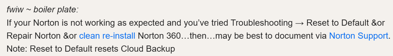

fwiw ~ boiler plate:
If your Norton is not working as expected and you’ve tried Troubleshooting → Reset to Default &or Repair Norton &or clean re-install Norton 360…then…may be best to document via Norton Support.
Note: Reset to Default resets Cloud Backup

In brief my history says that last cloud back up ran on 16/04/2026 14:43:34 when it say up to date.
