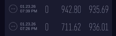

This fix worked for me! Try it, if you are using a Realtek driver’s card. You can verify in “Device Manager>Network adapters” for the driver’s developer. Realtek’s website has the drivers with the NDIS version that works correctly with Norton. If you see a (NetAdapterCx) version, just download a previous one that doesn’t have that description.
In realtek website go to “Downloads > Communications Network ICs” and then choose the “Family Controller Software” for your port/card type; USB, PCIe, 1GbE, 2.5GbE, etc.
“I was experiencing the same issue/bug. From ~940Mb up/down service, down to ~710Mb/940Mb. Upload doesn’t seem to be affected. After months with the issue and uninstalling Norton to fix it, tried again with Norton’s most recent version but the bug was still there.
My network card has Realtek drivers. Tried the Realtek’s (NDIS) version of the driver and it started working correctly. The (NetAdapterCx) driver version is the one that cuts the download speed, together with Norton installed. If you uninstall Norton, the card with (NetAdapterCx) drivers works correctly. Not sure if the problem is with Norton, Realtek or Microsoft’s Windows (NetAdapterCx) but they need to troubleshoot this issue.”
Test at 7:26 PM is (NetAdapterCx) and 7:39 PM (on top of the image) is with (NDIS).
Greetings!”
