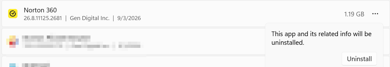

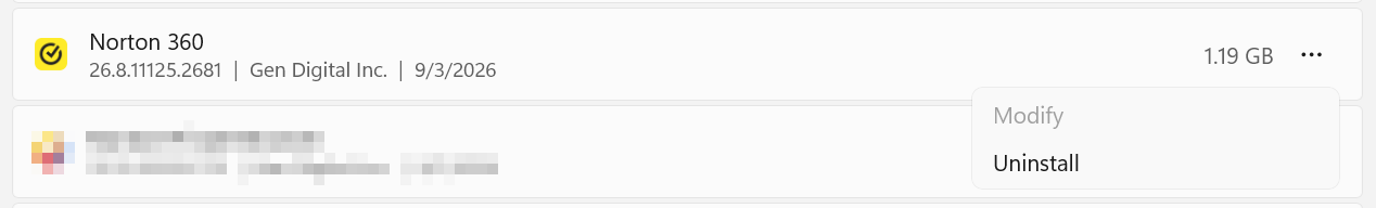

6
use Installed apps → Uninstall
ActAS
September 4, 2026, 4:04am
7
Thank you, but as mentioned earlier Norton is blocking the uninstall.

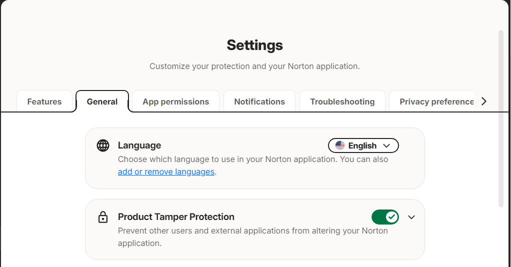

try Product Tamper Protection off/red?
ActAS
September 4, 2026, 4:10am
9
I tried that earlier tonight and I still couldn’t remove Norton.

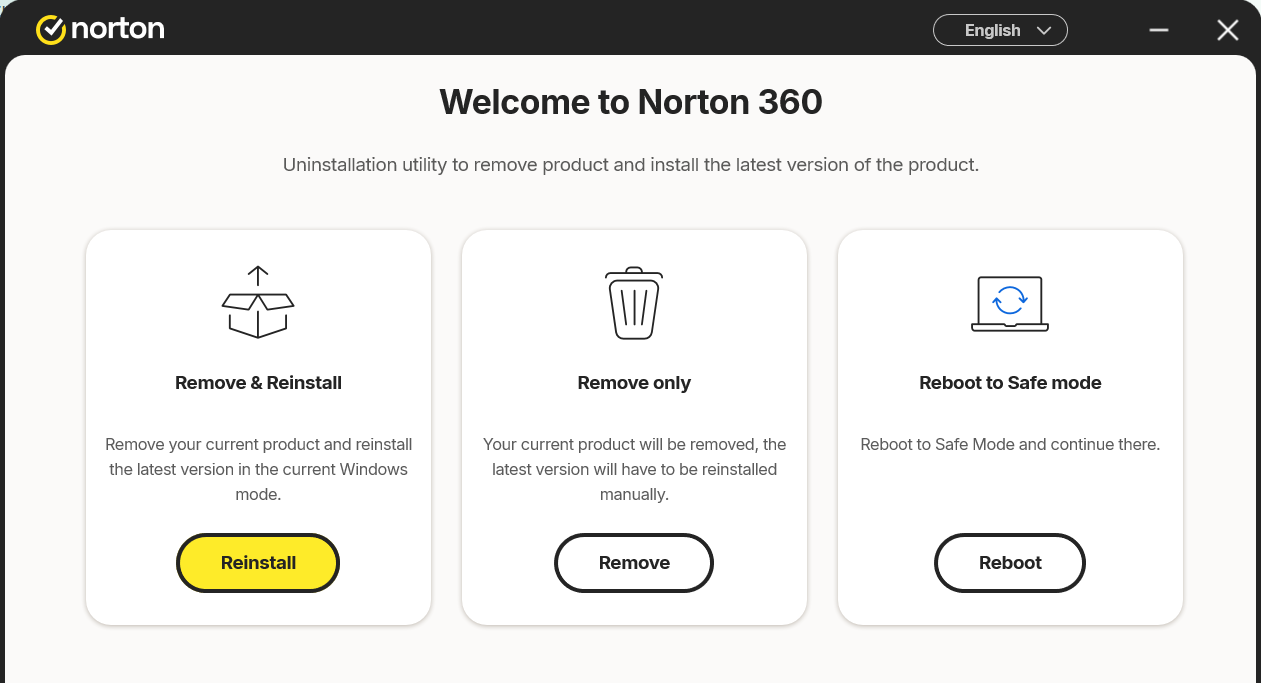

Hello @ActAS
Restart (not Shut down) machine
Safe Mode
The quickest method to boot Windows 11 into Safe Mode is to open the Start menu, click Power , hold down the Shift key, and click Restart . Once the PC restarts into the Windows Recovery Environment (WinRE), navigate to Troubleshoot > Advanced options > Startup Settings > Restart . On the subsequent screen, press 4 or F4 to enter standard Safe Mode.
If you require internet access during troubleshooting, press 5 or F5 for Safe Mode with Networking . Alternatively, you can use the System Configuration utility by searching for msconfig , selecting the Boot tab, checking Safe boot , and restarting the computer.
You need a BitLocker recovery key to boot into Safe Mode if your drive is encrypted.
Because Safe Mode modifies the normal Windows boot path , your computer’s security hardware (the TPM chip) notices the change. It treats the environment as potentially untrusted and will prompt you for the 48-digit BitLocker recovery key to decrypt the data and let Safe Mode load.
Is there a way to bypass it?
If you are locked out or simply do not have the key, there is a known command-prompt workaround that forces Windows directly into Safe Mode without triggering the BitLocker prompt:
Restart your PC into the Windows Recovery Environment (WinRE) (usually by forcing a restart 2–3 times while booting, or via an installation USB).
Navigate to Troubleshoot > Advanced Options > Command Prompt .
If it asks for a BitLocker key here, look at the bottom right and click Skip This Drive or hit Esc .
In the command line, type the following command and hit Enter:
bcdedit /set {default} safeboot minimal
Close the prompt and choose Continue . Your system should now bypass the key request and boot straight into Safe Mode.
Note: Once you are done fixing your PC in Safe Mode, you will need to open Command Prompt as an administrator inside Safe Mode and type bcdedit /deletevalue {default} safeboot so your computer can boot back into normal Windows
Using msconfig will trigger the BitLocker recovery key screen when your computer restarts.
When you check Safe boot in the System Configuration (msconfig) utility, Windows changes its boot configuration data. During the reboot, your system’s hardware security chip (TPM) detects this change in the boot path. It immediately assumes something has altered the operating system and locks the drive, forcing you to enter the 48-digit recovery key before it allows Safe Mode to load.
Using msconfig is actually the most common way people accidentally trap themselves in a BitLocker recovery loop . If you do not have your key, do not use the msconfig method.
What happens if you get stuck?
If you already applied this setting and are trapped on the BitLocker screen:
Tap Esc or click Skip this drive to get to the advanced troubleshooting menu.
Open the Command Prompt .
Run this command to force Windows back into normal boot mode:
On an encrypted drive, reboot into Safe Mode will trigger the BitLocker recovery key screen.
Because BitLocker is tied to the motherboard’s TPM chip, the hardware monitors the exact configuration of your boot sequence. The moment you tell Windows to deviate from its normal startup and load diagnostic drivers instead, the TPM registers a configuration shift and seals the drive until the 48-digit recovery key is entered.
When the BitLocker Prompt Will Appear
Method to reach Safe Mode
Triggers BitLocker?
The Consequence if You Have No Key
Yes
High Risk: It locks Windows into a boot loop requiring the key.
Windows Settings (Shift + Restart > Startup Settings > F4/F5)
Yes
Low Risk: Asks for the key before Safe Mode loads, but you can press Esc / Cancel to return safely to normal Windows.
Norton 360 Remover Tool (“Reboot to Safe Mode” button)
Yes
Variable: If the tool doesn’t automatically suspend protection, the TPM trips on reboot and halts at the key screen.
The Exception: Temporarily Suspending BitLocker
A machine avoids the recovery prompt during a Safe Mode reboot in one of two situations:
The drive is unencrypted (your PC BitLocker is disabled).
Protection is suspended beforehand: If an administrator suspends BitLocker for one reboot using the Windows command manage-bde -protectors -disable C: -rc 1, the TPM allows the system to bypass the key check for that single restart.
The Workaround if No Key
If your machine has BitLocker active and you lack the key, you should avoid msconfig and Safe Mode.
To break offline deadlock without triggering BitLocker, you should stick to the Command Prompt network reset from your normal desktop:
cmd
netsh winsock reset
netsh int ip reset
Use code with caution.
This clears Norton’s stuck firewall filter directly in live Windows, bypassing the need for Safe Mode altogether.
