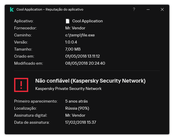

Why doesn’t Norton have this cloud verification tool like Kaspersky?
This tool works like this: I have a file and I want to know how many people in the cloud have this program, if it’s safe or not, so I right-click and it shows me this screen.

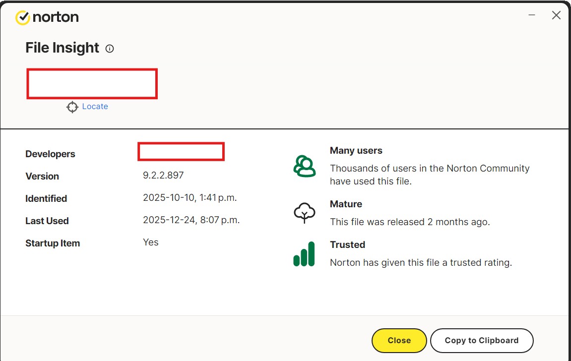

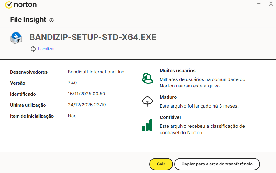

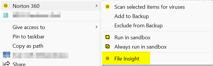

It looks like you want to check a file that is already on your system. Norton has the File Insight feature that you access by right clicking on a file, and click on Norton 360 > File Insight. If you are on Windows 11 you first have to click Show more options on the right click window to see the Norton options.

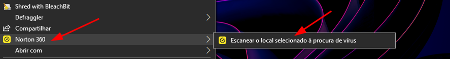

Escanear o local selecionado å procura de virus
Scan the selected location for viruses.
Did you try against an executable?
Norton 360’s File Insight feature is a reputation-based system that helps identify the trust level and potential safety risks of files on your computer by leveraging information from the larger Norton user community.
