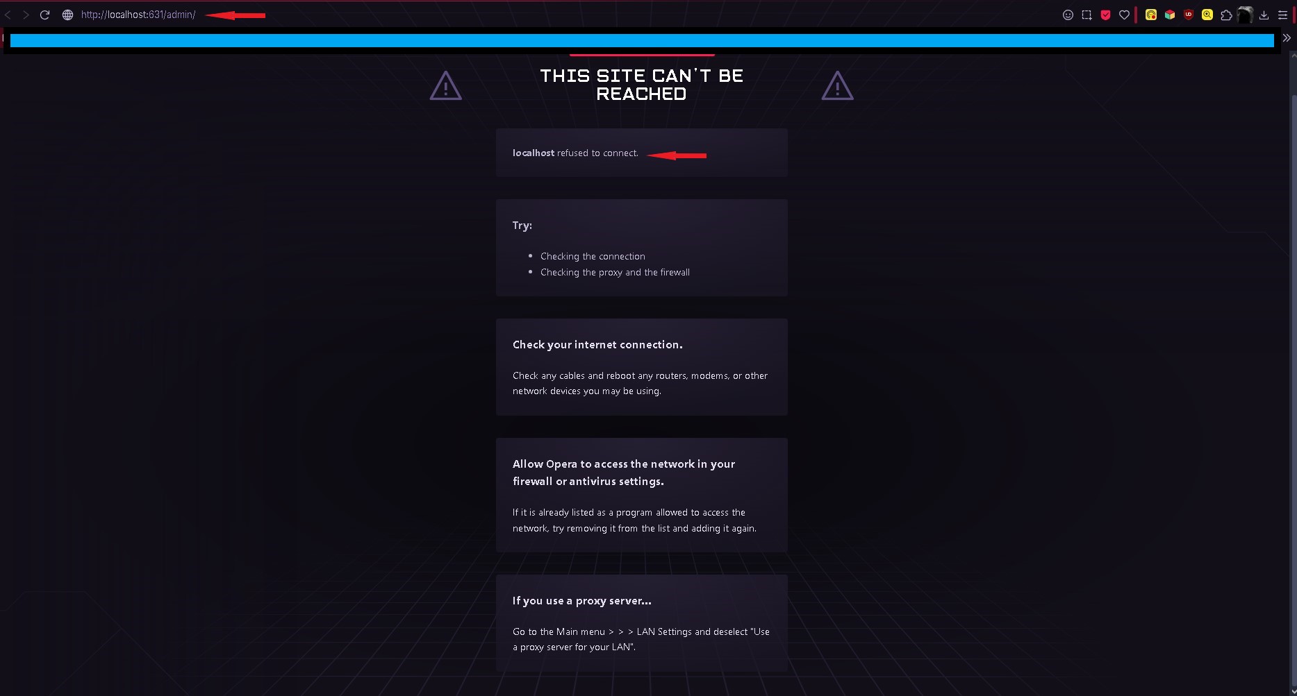

I get this on Opera GX using the admin site you linked: *Localhost refused to connect- NOTHING shows in my Norton history IE: Firewall activities or connections. The remote website is the culprit. Nothing Norton is doing is preventing this connection.
Thanks, now I don’t have to bang my head against the wall, trying to figure this out. Let hope that they only need to replace a part. Might have to try Opera, saw it advertised on one of the YouTube channels the other day. Take care.
You are most welcome as always!!
