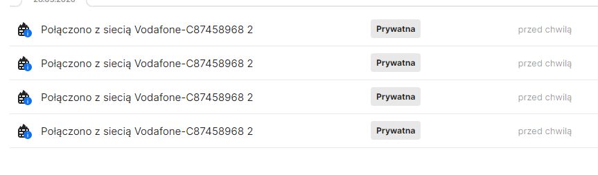

Constant reconnections to local network
As in topic. My norton in history shows constant stream of connection to my local network → this pc is my home pc that never connects to any other network (maybe norton VPN from time to time if you count). I noticed that around the time this logs happens → i get really annoying sound stutter.
Before I wrote this post → I reset the history and this is the effect:
Yup, connection spam and the UDP(17) traffic block spam have been happening since v24 was first a thing and has yet to be fixed.
@Tomasz_Zwolinski @RaveBlack As we all know Norton has ignored the UDP (17) flooding issue for a very long time. Its not a priority for whatever reason. The only workaround is disabling IPv6 in method # 3 below: ** This does NOT affect the performance of Norton in any way.
