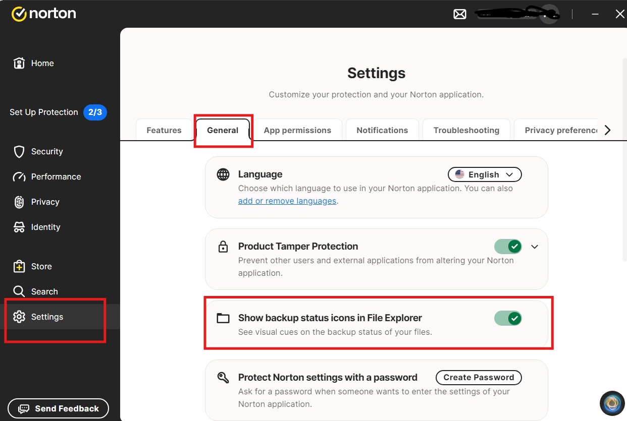

Now I have green checkmarks on all my files.I can’t find a backup setting to turn them off. Any ideas?
To turn off backup overlays from the main 360 interface click on Settings, General tab, and turn off Show backup status icons in File Explorer.
That and a desktop refresh solved the problem. Thank you, BJM and Peterweb!
