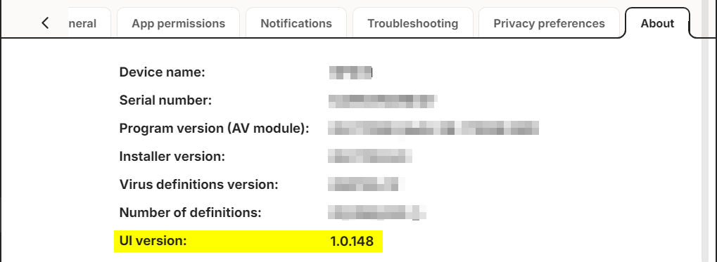

I just opened Norton. It said I needed to restart to update, but after the update I am at 1.0.145, not 1.0.148. Probably fine though.
Hello @FatBear
Please run Norton LiveUpdate + Restart (not Shut down) machine.

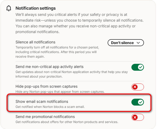

Hello @FatBear
Care to share screenshot?

The “endless snowfall” of notifications you are experiencing is tied directly to the newly enhanced Safe Email / Scam Protection module, which monitors network traffic and loudly flashes a popup every time a junk mail server attempts to deliver mail.
Norton v26 utilizes a unified interface wrapper, but its underlying notification engines fire differently depending on your specific plan tier and how you check your mail:
The Premium Double-Engine Penalty: If you run a higher tier plan (Advanced or any LifeLock bundle ) AND you use a local desktop email application (like Microsoft Outlook or Thunderbird, your system runs a Double-Layer Notification . Norton’s cloud servers flash an alert when they tag the message on the web server, and your local Norton software flashes a second duplicate alert moments later when your local client downloads it to your hard drive.
The Standard Single-Engine Stream: If you run a standard tier (Standard, Deluxe, or Premium ) with a desktop mail client, your local PC hardware ports are pushing a Single-Layer Notification for every single piece of junk filtered out by your computer.
(Note: If you run a Standard/Deluxe plan and ONLY use browser webmail like Gmail, these alerts are actually fake browser scareware scams mimicking Norton, as standard tiers do not possess cloud webmail scanning code).
The Permanent Fix (No Security Lowered):
You can completely silence the visual punishment instantly while keeping your background cloud and local antivirus scanners 100% active and protecting you.
Open your main Norton v26 application window.
Click the Settings (Gear Icon) located on the left-hand navigation pane.
Select the Notifications tab from the settings menu.
Locate the row labeled “Show email scam notifications” .
Click the green toggle switch on the right side of that row so that it flips to a red ‘X’ .
(Optional for Cloud Users) : If you want to stop background cloud synchronization processing entirely, log into norton.com, open the Safe Email / Scam Protection Pro tile, and click the ‘X’ to disconnect your email addresses from the web servers.
Once the toggle is set to the red ‘X’, Norton will continue aggressively shielding your data entirely in the background, giving you your quiet desktop back.
For a higher-tier user who only uses a local client like Microsoft Outlook or Thunderbird and has not registered their webmail in the cloud, that application toggle acts as the gatekeeper for their notifications.
When the Toggle is ON: The local Norton software monitors the computer’s physical network ports. Every time Outlook pulls a scam email down to the hard drive, Norton flashes an on-screen desktop banner—causing that single-layer notification.
When the Toggle is OFF (red ‘X’): The gate is closed. The local Norton engine still quietly intercepts and blocks the scam email threats from harming the PC in the background, but zero visual notifications are allowed onto the desktop screen.
