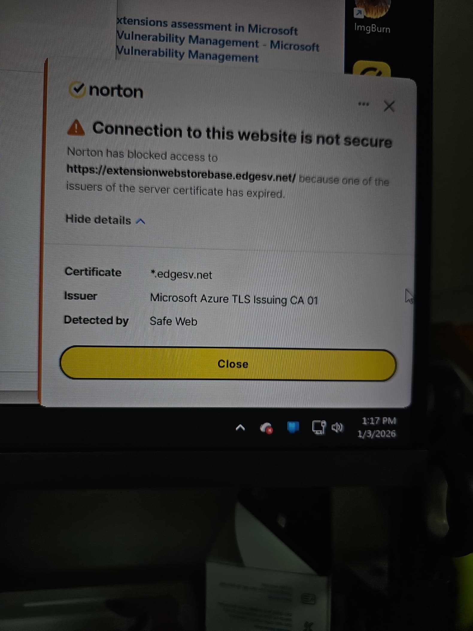

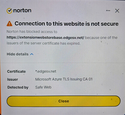

I keep receiving this pop-up that says “Norton has blocked access to
extensionwebstorebase.edgesv .net because one of the issuers of the server certificate has expired.” I contacted Microsoft who said that the the URL has been removed and Norton is giving me a false positive. Has anyone else had this issue?

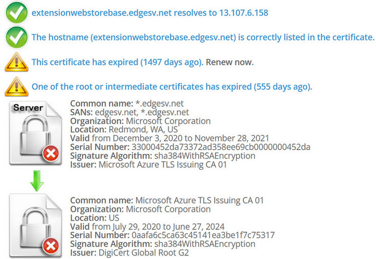

https://www.sslshopper.com/ssl-checker.html#hostname=extensionwebstorebase.edgesv.net
as test: Norton 360 v24 - Safe Web disabled
I have the same issue. I just delete the warning. However, Norton’s failure to fix this known issue is why I am probably not going to renew when my current subscription expires.

Yes, I have been dealing with it for a couple weeks or so.
Hello @esox07
…dealing with what?
I keep getting this pop up several times a day.

You are seeing this Norton pop-up because the URL in question, extensionwebstorebase.edgesv.net, is a known obsolete domain previously used by Microsoft Edge for extension updates, and its associated security certificate has genuinely expired.
Norton is accurately detecting the expired certificate and blocking the connection as a standard security precaution. However, this specific instance is considered a false positive because the URL is no longer in use and poses no actual security threat.
Here is a breakdown of why this is happening and what you can do:
Why the Alert Appears
  • Expired Certificate: The primary reason for a security alert is that the server certificate or one of its issuers for extensionwebstorebase.edgesv.net is out of date. Security software like Norton is designed to block connections to sites with expired certificates to protect you from potential risks, as outdated certificates can indicate an unmaintained or potentially compromised website.
  • Obsolete Domain: Microsoft has confirmed that the extensionwebstorebase.edgesv.net domain is obsolete and no longer in use. Microsoft Edge, for various reasons (likely related to remnants of extensions or internal update checks), still occasionally attempts to connect to this old URL.
  • Norton’s Action: Norton Safe Web is doing its job by identifying the expired certificate and blocking the connection attempt. Since the URL is obsolete and safe to ignore, the warning is a false positive.

While the certificate did expire a long time ago (over 1400 days), the problem lies in the fact that Microsoft considers the domain obsolete and likely has no intention of renewing the certificate.
The expectation is not that Microsoft will renew the certificate, but that they will eventually issue an Edge browser update that removes all references to the defunct domain from the browser’s code.
