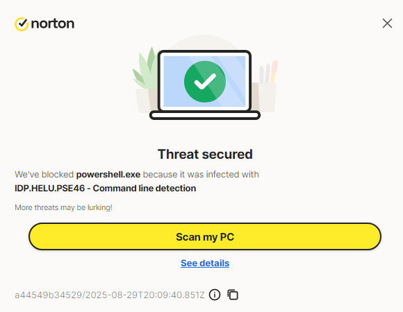

Issue abstract: getting a false positive when using powershell in windows 11 pro
Detailed description: Trying to run Gemini CLI in VSCode. As soon as Gemini tries to connect, Norton stops it from running.
Product & version number: Everything is up to date as of 29/8/2025
OS details: Windows 11 Pro
Details
Threat name: IDP.HELU.PSE46%s_cmd
Threat type: Miscellaneous - This is malicious software that could harm your data, computer, or network.
Status: Threat detected
Detected by: Behavioral Protection
On PC from: 12/03/2025, 13:21
Last Used: 29/08/2025, 21:09
Startup Item: Yes
Many users
Millions of users in the Norton Community have used this file.
Mature
This file was released 6 months ago.
High
The file risk is high.
Activity
Path | Type | Status
C:\Windows\System32\WindowsPowerShell\v1.0\powershell.exe | Process | Terminated
559CB6880484BD6FED96EFCF5B4274CE | File | Deleted

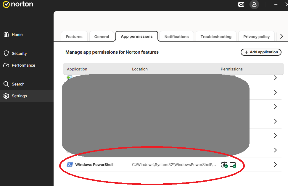

FYI. I’ve added Windows Powershell and the correct path to App Permission section of Norton. I’ve also added the path to antivirus exclusions, but it makes no difference.

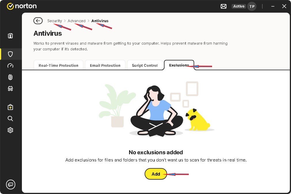

Have you added the folders where you are creating code to the Norton exclusions settings as well? Is this area what you are referencing?
Thank you for your reply SA. Much appreciated. Yes I have the latest Gemini CLI 0.2.2, and also yes, I added the paths (for powershell and my project directory) to both the exclusions section as per your screenshot and the App Permissions as below.
