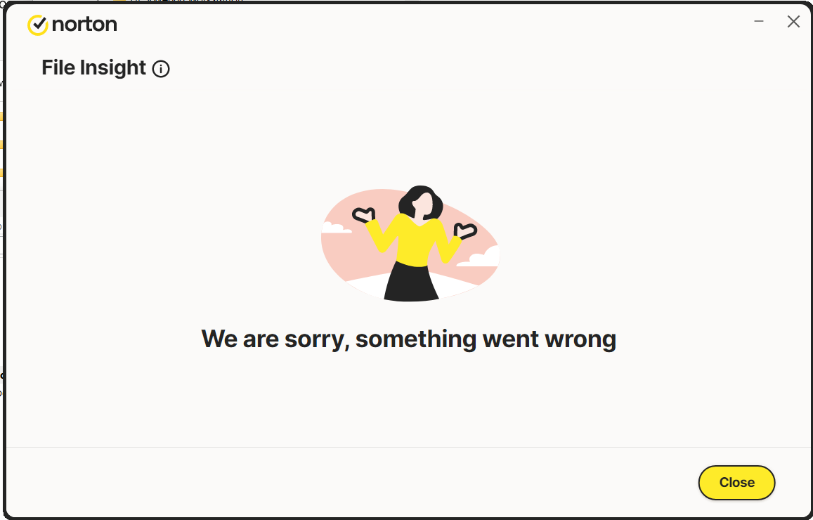

File Insight Open Lately With "We are sorry, something went wrong"
Issue abstract: File Insight Open Lately With “We are sorry, something went wrong”
Detailed description: File Insight Open Lately With “We are sorry, something went wrong” for the paste month or so.
Has File Insight been deleted from Norton 360?
Product & version number: Norton 360 25.5.10141 (build 25.5.10141.935)
OS details: Edition Windows 11 Pro
Version 24H2
Installed on ‎1/‎27/‎2025
OS build 26100.4351
Experience Windows Feature Experience Pack 1000.26100.107.0
What is the error message you are seeing? “We are sorry, something went wrong”

Tried the “Record a performance issue &or Enable/Send debug logs” but had a problem getting to the problem before the recorder ran out of time.
Tried “Restart” my computer but still had the problem.

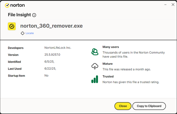

Downloaded the “Norton 360 Remover tool for Windows” but before I ran it, I checked it with File Insight and it worked!
Tried the exe file that gave “We are sorry, something went wrong” and it still gave “We are sorry, something went wrong”
Downloaded a newer version of that file to C:..\Downloads and File Insight worked.
Tried moving the downloaded file from C:..\Downloads to the folded on my NAS drive and File Insight failed with “We are sorry, something went wrong”
The problem seems to be where the file is located.

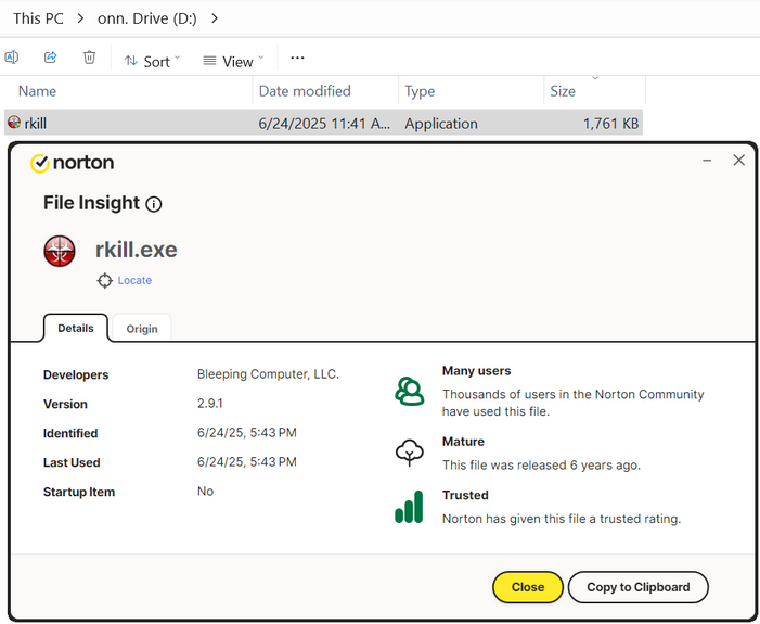

fwiw ~ as test: moved file from C:\Downloads to my DAS drive
