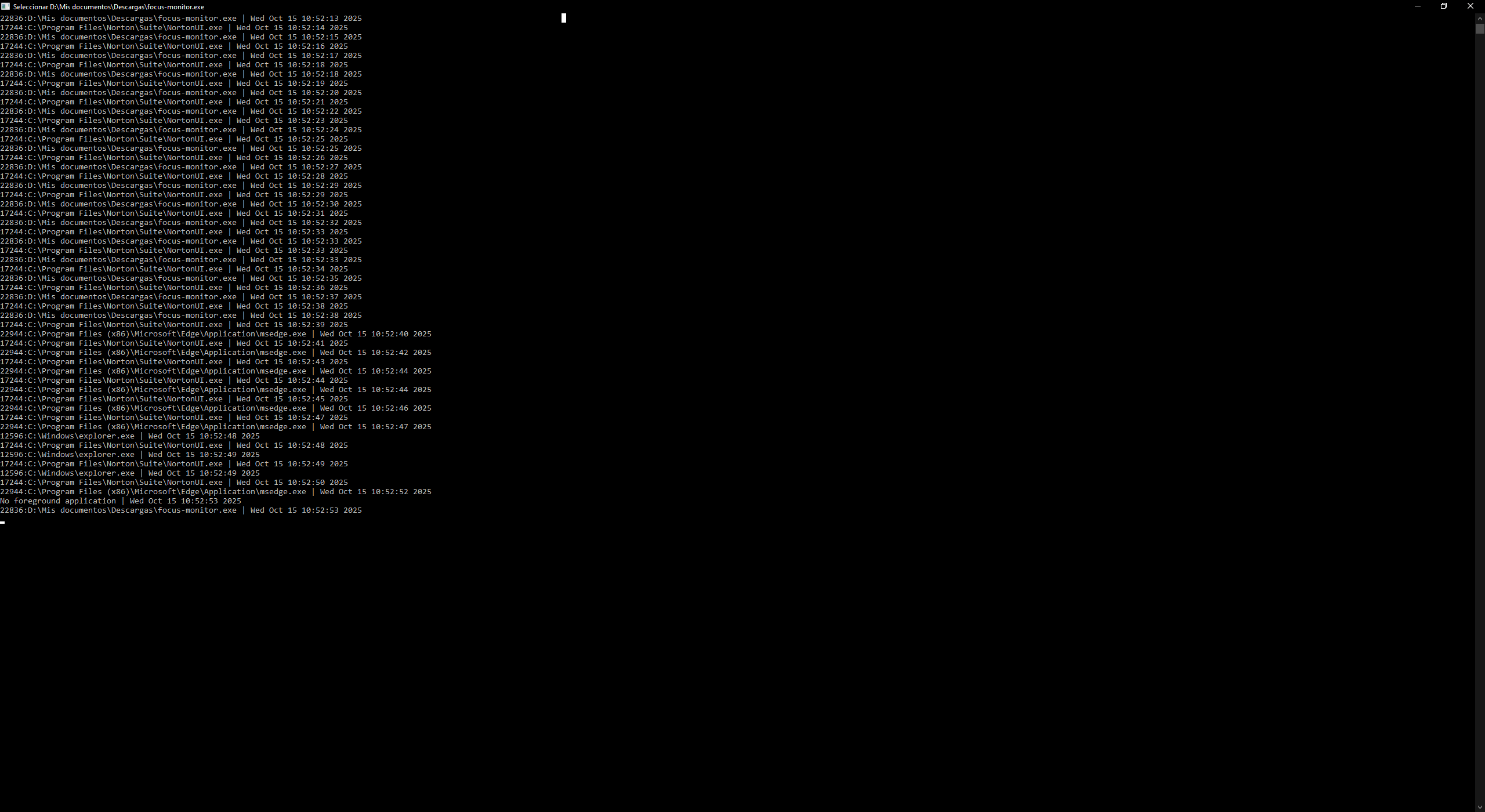

I have checked it with a program which shows the programs taking the window control. Below there is a snapshot of the command line.

@SoulAsylum I used a Focus monitor software because I needed to find out which program is causing the focus in and out from the window I am working on.

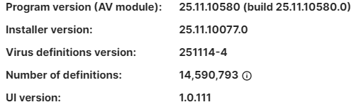

UI Version: 1.0.111 has been released to fix the issue of “Norton360 Makes Keyboard unusable - constantly grabs focus”. Please run Norton LiveUpdate and Restart the system to check if the fix is working.
Guys, the latest release Norton Security 25.11.10580 is of no help. It still DOES NOT fixes the focus issue. Its really annoying and frustating.
