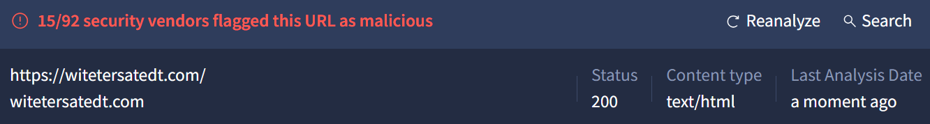

Hello @MrFrank_Thaxton
https://witetersatedt.com/
Is your device opening this website automatically?
How you encountered this domain can change the interpretation.
How to Remove Browser Hijackers [Virus Removal Guide]
Malwarebytes: How to install Malwarebytes & run a scan

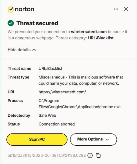

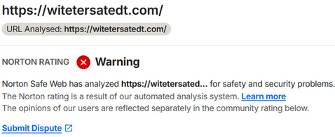

eb15f2a3ff12/2026-06-09T09:21:38.028Z
Threat name: URL:Blacklist
URL: witetersatedt.com
Alert ID: dc3dd9c3264e
Norton Submission Portal is used for submitting false positive reports.

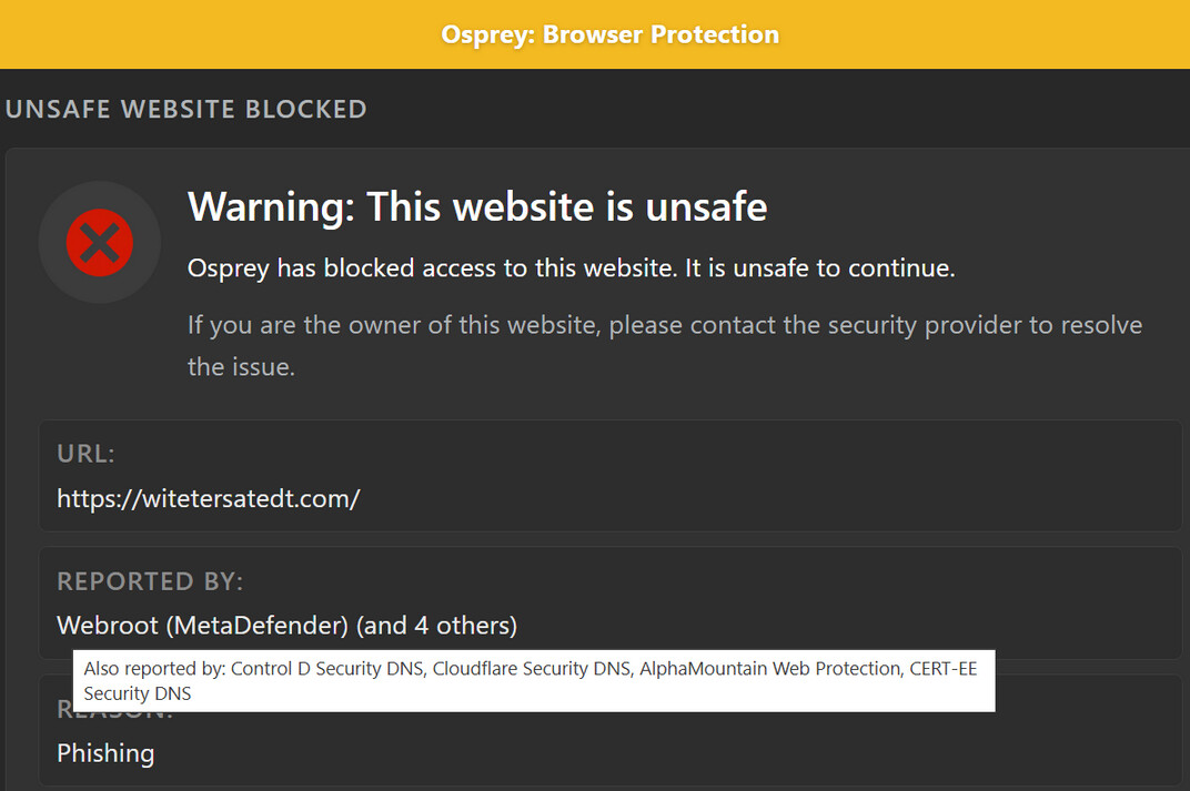

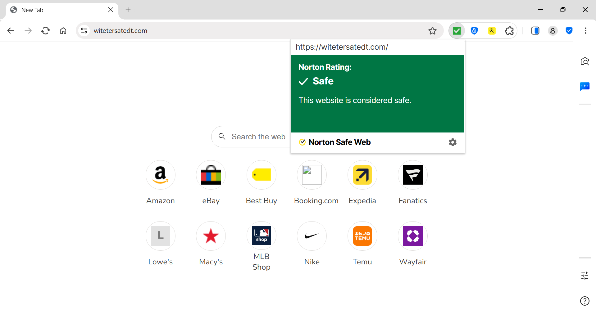

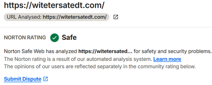

Hi @MrFrank_Thaxton
Thanks !

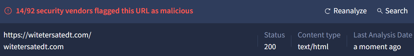

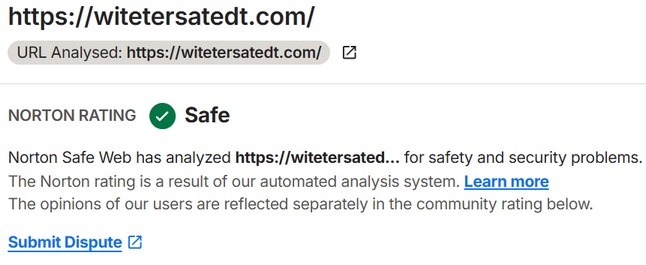

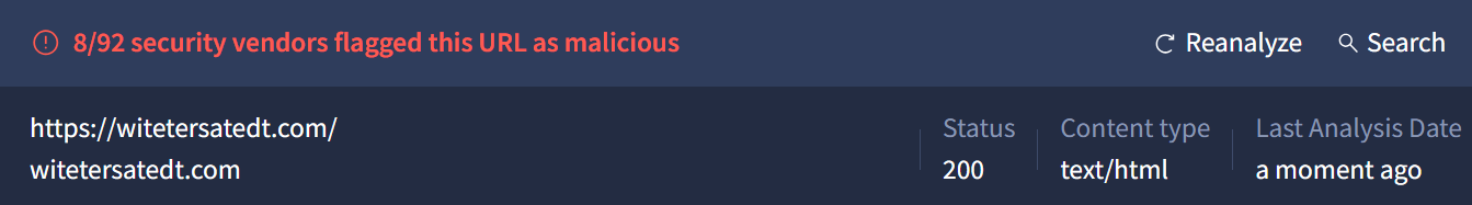

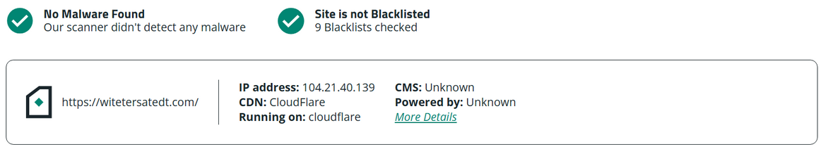

Current evidence stack:
Norton Safe Web → Safe
Sucuri → not blacklisted
AbuseIPDB → nothing notable
Cloudflare-backed infrastructure
VT → partial heuristic detections
suspicious/random domain naming
generic monetized portal page
That combination fits much better with:
low-reputation disposable web/advertising/search infrastructure
than with:
confirmed active malware operation.

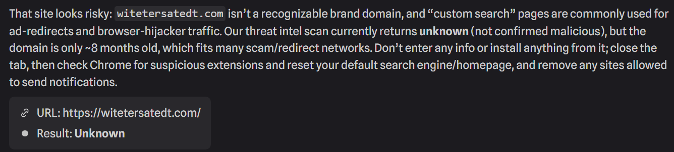

The earlier AI explanation about cloaking and hijacker infrastructure was technically possible, but it was presented with too much certainty given the available evidence.
witetersatedt.com looks more like:
randomized text,
typo-generation,
algorithmic naming,
or disposable registration.
That kind of naming is very common in:
ad-tech throwaway domains,
redirect infrastructure,
spam campaigns,
parked domains,
tracking systems,
and occasionally malicious operations.
But it’s important not to overinterpret that single signal.
A weird domain name alone does not prove malware. There are also:
SEO churn domains,
testing domains,
affiliate portals,
autogenerated marketing infrastructure,
and low-effort monetization sites
that use ugly/random names without being outright malicious.
So the strange domain name absolutely lowers trust and explains:
Chrome AI concern,
heuristic AV flags,
and earlier Norton blacklist status.
But broader evidence still does not strongly support:
active browser hijacking,
malware delivery,
or phishing exploitation.
At this point, the most defensible assessment remains:
suspicious low-reputation disposable web infrastructure, but not conclusively malicious based on observed behavior.

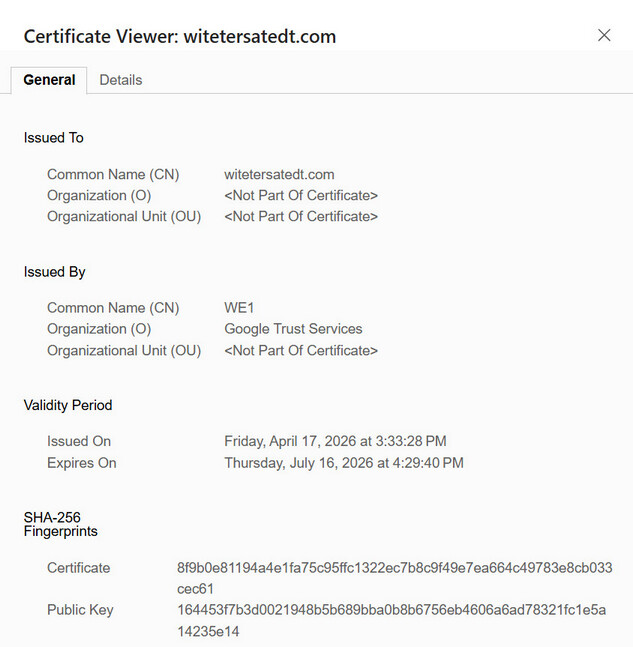

That certificate timing actually leans toward the “throwaway/disposable infrastructure” interpretation too.
A few observations:
The cert lifetime is short (~90 days), which is completely normal for free automated certificates like Let’s Encrypt or Google Trust Services.
Modern legitimate sites also use 90-day certs now, so short validity alone is not suspicious.
But when you combine:
very recent certificate issuance,
random-looking domain,
generic portal page,
low reputation/history,
Cloudflare fronting,…it starts to resemble quickly deployed low-investment web infrastructure.
That said, the certificate itself does not indicate malware. In fact:
scammers,
affiliate marketers,
parked-domain operators,
and legitimate businesses
all use HTTPS now because certificates are free and automated.
A more telling signal would be if:
the cert kept changing rapidly,
the domain rotated constantly,
or the site redirected differently based on geography/user-agent.
But from the evidence you’ve gathered, the domain currently looks more like:
cheap disposable web infrastructure with questionable reputation
than:
confirmed malicious exploit delivery.
You’ve basically moved from the initial scary AI interpretation toward a more evidence-based middle ground:
suspicious? yes
trustworthy? not really
proven dangerous? not from the current evidence.

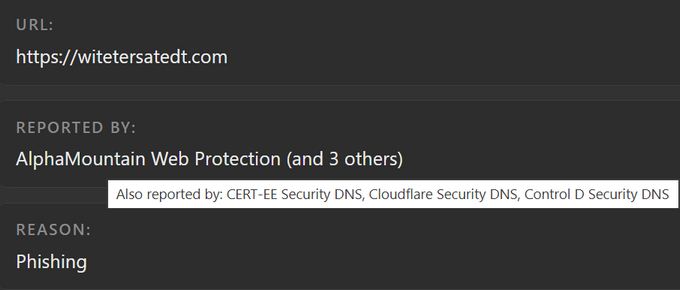

So who publishes https://witetersatedt.com/?
Nobody in the public records clearly identifies themselves as the publisher/operator of the site.
What is visible publicly is:
domain registrar: Namecheap
DNS/CDN provider: Cloudflare
WHOIS privacy masking enabled
ownership hidden behind “Withheld for Privacy ehf” in Iceland.
So the actual operator is intentionally obscured.
Public metadata suggests:
domain registered October 22, 2025,
very little identifying business information,
generic “New Tab” title,
and privacy-protected WHOIS.
That combination is extremely common for:
affiliate/search portals,
ad-network landing pages,
and low-effort monetized domains.
But there’s no public evidence tying it to:
a known company,
a named malware gang,
or a verified hijacker campaign.
In other words:
the operator is anonymous by design.
Which is one reason trust scores stay cautious even when scanners don’t find active malware.
One interesting detail:
some scanners tagged the domain with categories like:
“Brands”
“Gift Card - Brands”
“Amazon Phishing”
…but those appear to be heuristic/category labels, not proof of confirmed phishing activity.
So the most accurate answer right now is probably:
an unidentified operator using privacy-protected disposable-style infrastructure, likely for search/ad/traffic monetization purposes.

The site layout itself strongly resembles:
search monetization portals,
affiliate-click landing pages,
fallback redirect pages,
or generic “new tab” traffic capture sites.
Those exist largely to:
collect ad impressions,
redirect searches,
generate affiliate revenue,
or sell traffic onward.

Even though the site exists and has a valid SSL certificate, very little public information is available because of how modern domain registration works.
Why there’s almost no public data
WHOIS privacy protection — Almost all domain registrars now hide the owner’s name, address, email, and phone number by default. The public WHOIS record for
witetersatedt.com
only shows generic privacy-protected data.
No company branding or “About” page — This type of search page is usually operated by small affiliate networks or ad-tech companies that deliberately stay low-profile.
Certificate transparency doesn’t reveal owners — The SSL certificate proves the domain is valid and encrypted, but it does not contain the owner’s identity — only the certificate authority that issued it.
These sites are often part of large networks — Many similar search redirect pages share infrastructure and are created in bulk, making it hard to tie any single domain to a specific person or company.
Summary
The site is real and functional, but it was intentionally set up to be anonymous . This is very common with search hijacker / custom search pages.

Norton’s initial block was probably triggered by its heuristic engine (behavioral / reputation-based detection) rather than a specific malware signature. These engines often flag sites like
witetersatedt.com
because they match several suspicious patterns at once:
Unknown / low-reputation domain
Privacy-protected WHOIS registration
Search hijacking behavior (changing homepage or default search)
Limited public information about the site
When a human analyst at Norton later reviewed the site and found no actual malicious payload or harmful activity, they cleared the detection.
This is a very common pattern with these custom search / affiliate pages — they frequently get caught by heuristics first and then whitelisted after review.
bjm
15 June 2026 09:38
15
It may be safe, but I found it a first class nuisance!
VirusTotal
Osprey Browser Protection
Malwarebytes Scam Guard
Did you ever run the Malwarebytes scan as suggested by bjm_ in an earlier post? What you are seeing sounds like a browser hijacker ad redirect.
Thanks - I didn’t as it was classed as safe. It’s now sorted thanks!
That website may be safe, but why were you redirected to that site? That is what a Malwarebytes scan is useful to detect if you have something on the computer causing the redirect.
