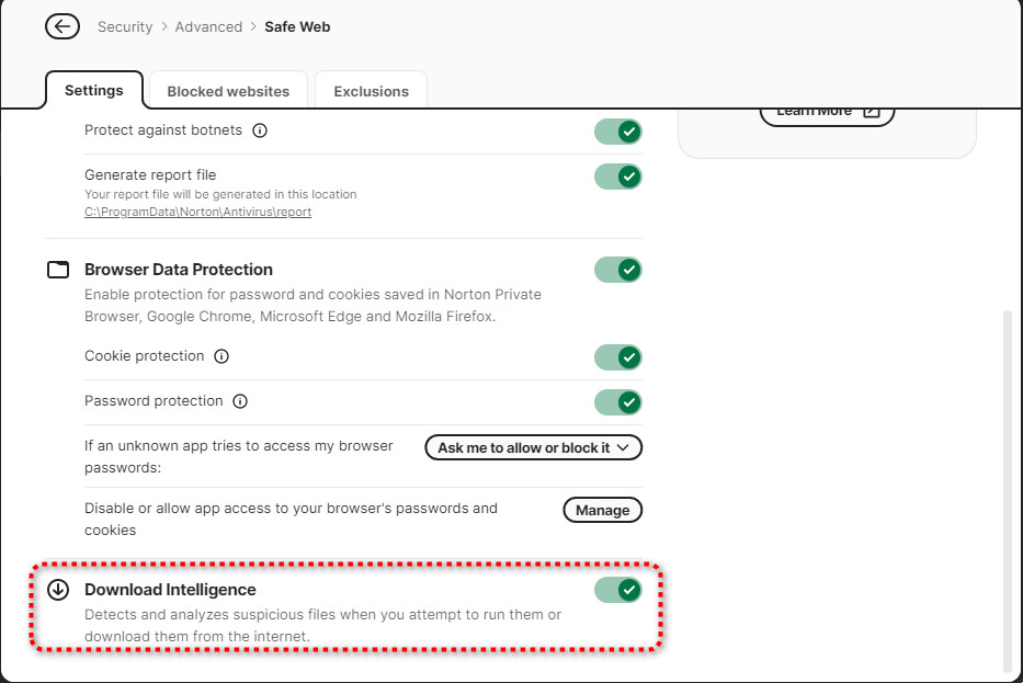

Download Intelligence
Detects and analyzes suspicious files when you attempt to run them or
download them from the internet.
