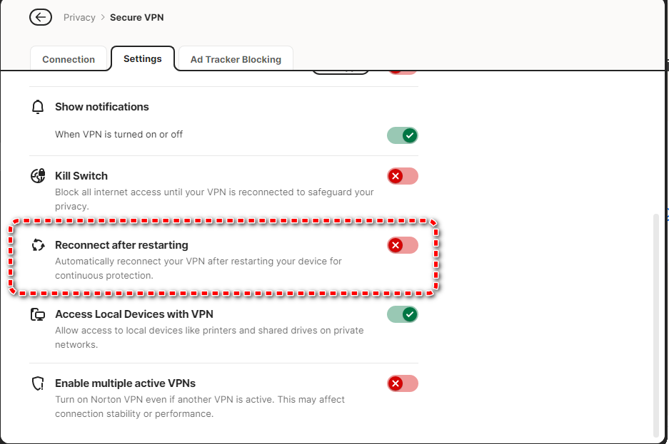

@Elaine1 Check the settings shown in this older thread. Its from the 24.xx release but the settings should be still in that general area. Disable VPN there.

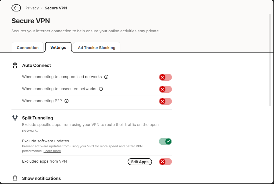

And you’ve reviewed Norton 360 - Secure VPN - Settings ?

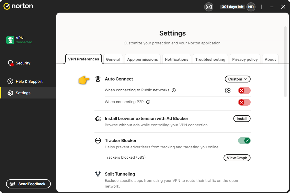

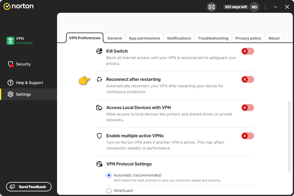

@bjm Thanks for posting the updated screenshots.
Are you bothered by the pop-up menu or automatic connection?

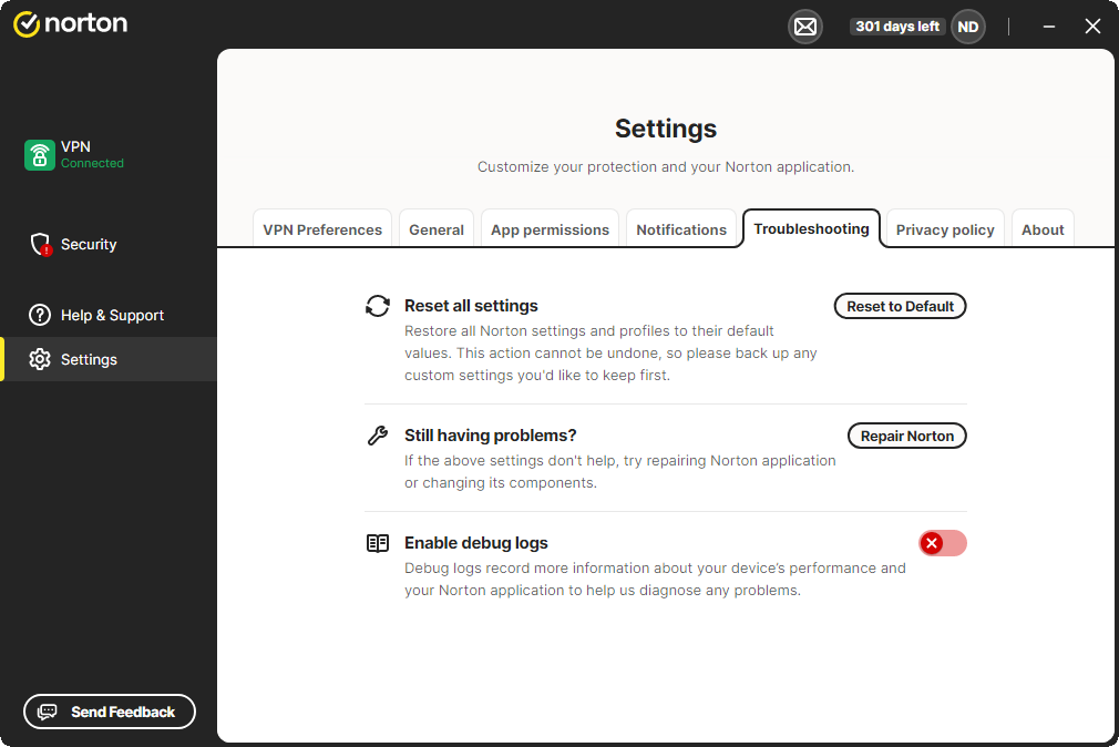

If these settings do not help, you can restore all settings to default.

Thanks for posting Norton VPN plan pics.

Thank you. Yes I’ve tried all these settings, also tried reset to default settings, and even repairing Norton. Nothing has changed. E
