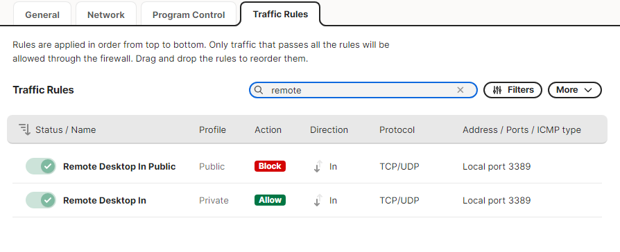

Detailed description: in my router I forwarded port 3389 for the PC I want to remote-control using Mac Windows App on a different network. I set the WAN IP address as the gateway in Windows App. When I try to connect, I get prompted for my credentials, but after a minute or two I get an “Unable to connect” with error code 0x300005f. Googling that error code suggested it might be a firewall issue on the PC. How do I configure Norton’s Smart Firewall to allow Windows App?

It seems weird that Remote Desktop does not appear in the Program Control list given that there are two rules about it.
Norton is definitely blocking Remote Desktop, I got an alert from it.
Try creating a new rule in the traffic rules setting. Click the more button just to the right in the top.
