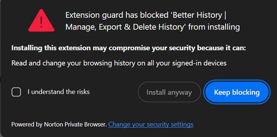

  1. Go to the Chrome Extensions webstore and add pick a good History Manager extension to add to your Norton Browser. I chose “Better History”. This extension has options to export either as a CSV or a HTML file. (I initially tried the Click & Clean extension recommended by Norton Extensions store, but it didn’t seem to do a history export …despite advertising that it did.) NOTE: Norton gives a warning that it doesn’t trust Better History – but at this point I’ve wasted too much time looking for a solution to a problem they created, and just bit the bullet and downloaded it. No viruses yet : ) I’ll uninstall it as soon as I’m done.

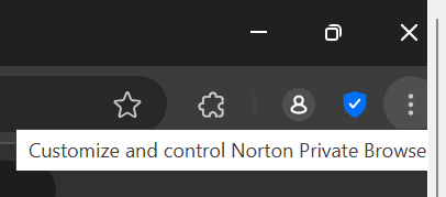

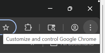

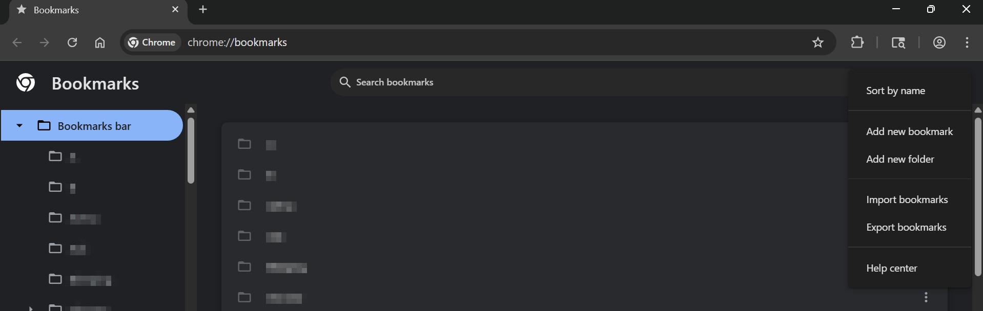

Norton Private Browser is based on Chrome.

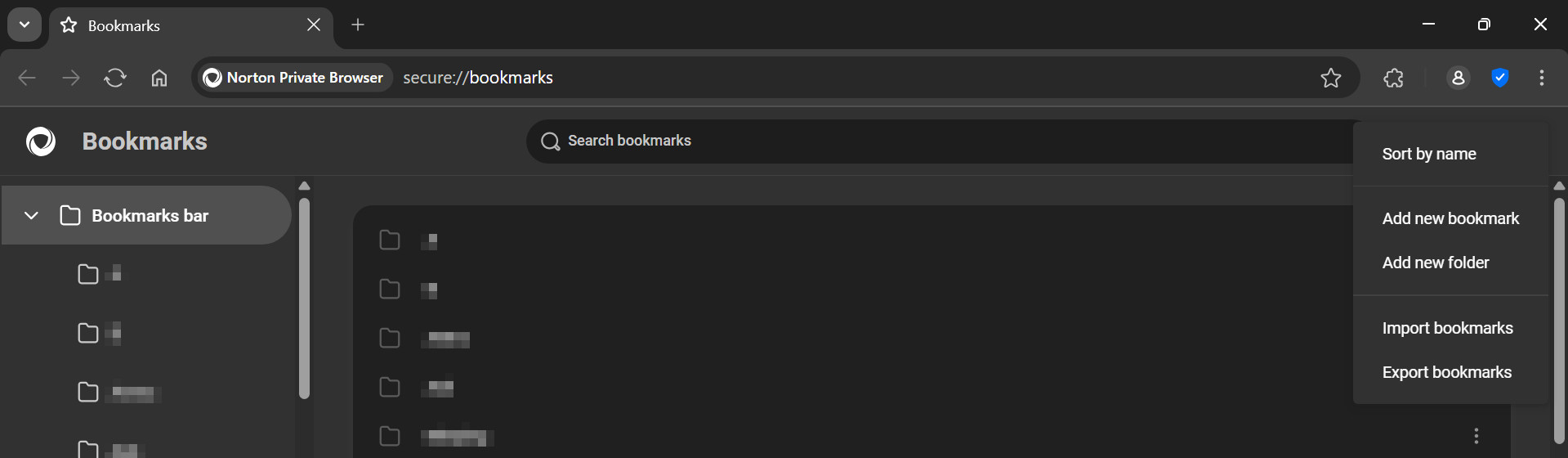

I’m familiar with Chrome…so, I know where to look for Norton Private Browser → Export bookmarks.

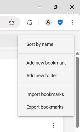

To export Chrome bookmarks, open Chrome and go to the three-dot menu (More) in the top-right corner, then select Bookmarks > Bookmark Manager. In the Bookmark Manager, click the second three-dot menu (Organize), and select Export Bookmarks to save your bookmarks as an HTML file.
Here’s a step-by-step guide:
  1. Open Chrome: on your computer.
  2. Click the three-dots menu: (More) in the top-right corner of the browser window.
  3. Select “Bookmarks”: from the dropdown menu.
  4. Choose “Bookmark Manager” .
  5. In the Bookmark Manager, click the second three-dot menu (Organize) in the top-right corner.
  6. Click “Export Bookmarks” .
  7. Select a location: on your computer to save the file and then click “Save”.
Your bookmarks will be saved in an HTML file, which you can then use to import them into another browser or as a backup.

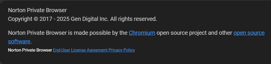

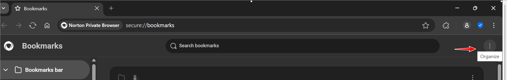

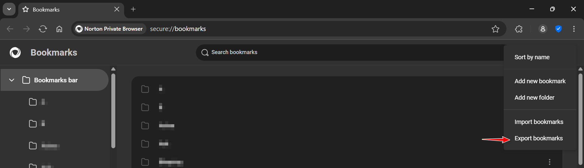

AI Overview
Norton Private Browser is based on the Chromium engine, which also serves as the foundation for Google Chrome. This shared codebase means it has a similar underlying structure but incorporates Norton’s specific privacy and security features, such as built-in anti-tracking, ad-blocking, and anti-phishing tools, to enhance user protection.

Norton Private Browser → Customize and control (three vertical dots)…resembles Chrome.
Norton Private Browser → Bookmark manager…resembles Chrome.

Norton Private Browser → Extension Guard (by my experience) gives a warning for any extension…not from Norton Addons store.

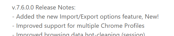

Click & Clean extension recommended by Norton Addons store
https://addons.norton.securebrowser.com/extension/click&clean/ghgabhipcejejjmhhchfonmamedcbeod
Haha bjm, yes Chrome is certainly popular! I don’t use it, I use the Norton browser and sometimes Edge. There are a lot of people (even regular ones! : ) who don’t know how to find tricky features that we don’t use frequently. I found it impossible to find the button, it wasn’t intuitive, and I couldn’t find answers in the FAQ. I was cramming for exams, I needed a fast way to download my bookmarks to do a printed reference list. I was stuck and took me hours to find solution. Just a stressy experience. So it would just really help to include this in your FAQ I feel. That would really help Norton customers who find themselves in the same boat as me :slight_smile:
PS the Click n Clean extension has a version update v7.6.0.0 that references Exporting.
This is why I was so excited for a minute… then loaded the extension and found that it didn’t actually offer it. Maybe they introduced it but later removed it or something . Who knows.

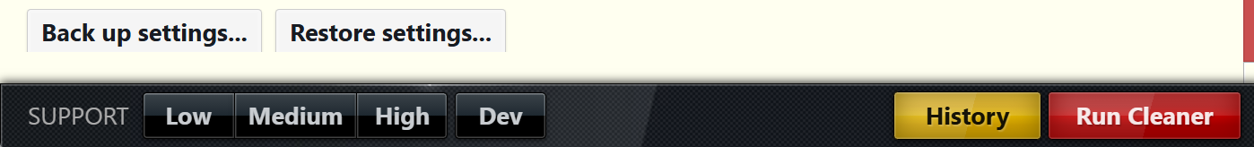

I wonder whether Import/Export might refer to Back up setting… | Restore settings…
I’ve sent an email to support@hotcleaner.com requesting details regarding Import/Export options feature.

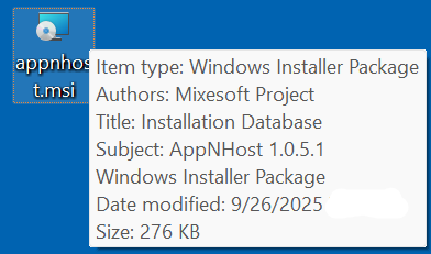

Did you also install appnhost.msi?

Ah right! That might make sense then. Who knew there were other things you could export… (clearly not me :joy:
