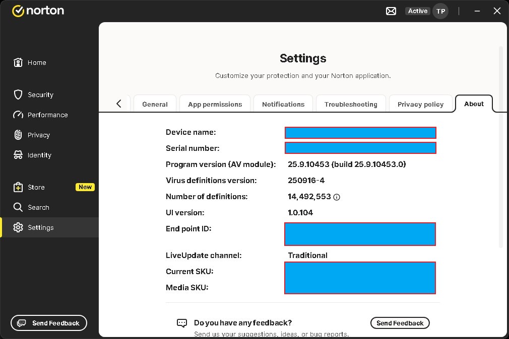

This is what I see on Win 11 and 360 ver 25.9.10453.

@Maryann_Hogan Is your Norton install version 25.9.10453? This is where to look. Also your permissions level is still at new user vice basic. Basic is required to be able to post screenshots unfortunately.
I finally found it, my version is 25.8.10387 (build 25.8.10387.948). I have had Norton for two full years, recently renewed at the end of July for one more year. Why is it still considered new? I just also saw the banner that a new version is available but I couldn’t figure out how to update it.
In September of 2024 Norton released the first NEW version 24.xxx which replaced the 22.24.8.36 series, since then. The latest release has gone to 25.9.10453 and it signifies many bug fixes to the original new core engine Norton now uses for its product. You should run live updates to get the latest release.
Thank you. I could not find the live updates area, but it updated today when I turned it on. I now have the updated version. I still have not found anything where it says scan selected items or anything that looks like the page sent three days ago. Can you explain where I can find that? Thank you
