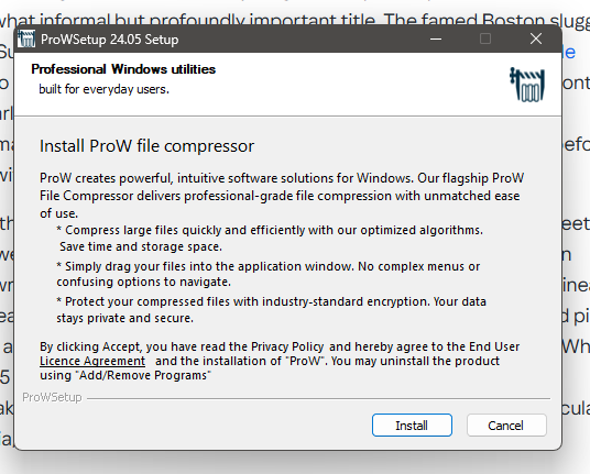

Issue abstract: Unwanted “Prowsetup.exe” installer keeps popping up
Detailed description: I keep getting a popup appearing called “ProWsetup.exe”. I have not executed it, but have tried a full system scan and have ran Norton Power eraser too with the root kit scan turned on. It still pops up about once an hour or so. I can kill the popup in task manager but keeps coming back.
Any ideas how to stop this?

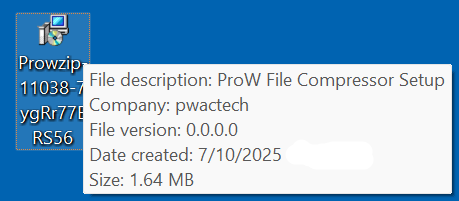

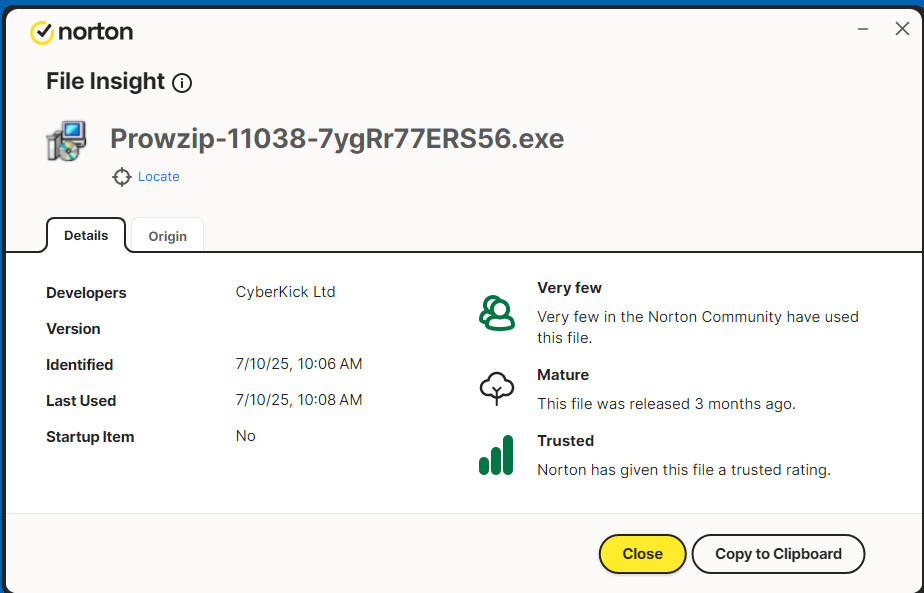

fwiw ~ as test:
VirusTotal report:
here
Details
Threat name: Script:SNH-gen [Drp]
Threat type: Dropper - This threat can secretly install other applications on your computer.
Status: Moved to Quarantine
Options: Report false detection
Detected by: Auto-Protect
On PC from: 7/10/25,
Last Used: 7/10/25,
Startup Item: No
Unknown
It is unknown how many users in the Norton Community have used this file.
Unknown
The file release is currently unknown
High
The file risk is high.
Activity
Path | Type | Status
C:\Sandbox\user\Default\user\current\AppData\Local\Temp\is-3U95U.tmp\dl_1.vbs | File | Repaired
HKEY_LOCAL_MACHINE\Software\Microsoft\Windows\CurrentVersion\Policies\Explorer\NoWindowsUpdate | Registry value | Repaired
