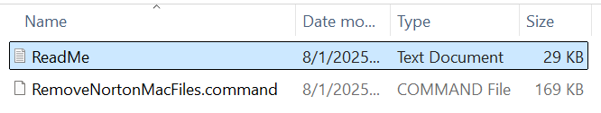

RemoveNortonMacFilestool
Before running theRemoveNortonMacFilestool, make sure that you have uninstalled the Norton device security product on your Mac here -
Remove a device from your Norton account here
AI Overview
The RemoveNortonMacFiles tool is used to completely remove all Norton files and folders from a Mac. It’s a separate tool from the standard Norton uninstaller and is specifically designed to address leftover files after the main uninstall process. To use it, you’ll need to download the tool from Norton’s website, open it in Terminal, and then follow the prompts to remove the files.
Here’s a more detailed breakdown:
1. Download the tool:
Obtain the RemoveNortonMacFiles.zip file from Norton’s website.
2. Open in Terminal:
Locate the downloaded file, control-click it, and select “Open with > Terminal”.
3. Follow instructions:
Enter your administrator password when prompted, then choose option “1” to remove all Norton files.
4. Restart:
The tool will prompt you to restart your Mac after the removal process is complete.
5. Complete Removal:
Restarting ensures all Norton remnants are fully removed, including those in the library folders and elsewhere.
6. Manual Check (Optional):
For a thorough removal, you can manually check and delete leftover files in ~/Library/Application Support/, ~/Library/Preferences/, and /Library/LaunchAgents/.
