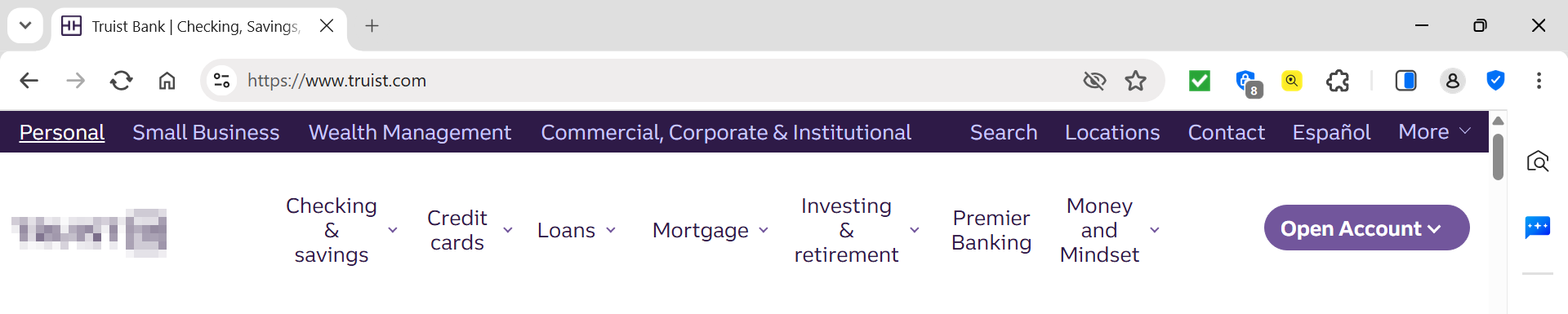

I am having issues loading financial apps (Truist). It does not load, or loads a blank screen or loads the screen but missing buttons descriptions and pages. I am using Windows 11.
I had no issues prior to loading Norton recently for the first time.
VPN off??
HTTPS scanning off?
Care to share the website domain (space name/address to break link)
There is no official Truist desktop application available for Windows 11 (W11). Truist offers official, free mobile financial apps designed for iOS and Android devices, as well as secure web access for Windows 11
Try turning off any VPN or ad blocking browser extensions before accessing that site.
If that does not help, try turning off HTTPS scanning setting inside the Safe Web Settings. From the main 360 interface, click on Settings at the bottom left, then from the Features tab click on Safe Web. Click the down arrow beside Safe Web and then look for and turn off HTTPS scanning, then test the website again.
Not using VPN. Truist .com
Yay !! That worked for Truist. But another will not load at all now, just spinning.

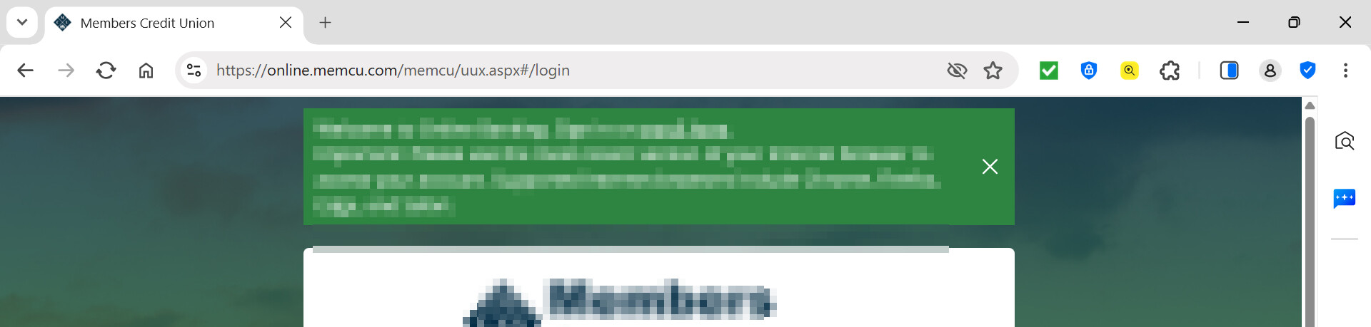

online. memcu. com/memcu
It just loaded, but took a while. Thanks for you feedback. Greatly appreciated.
