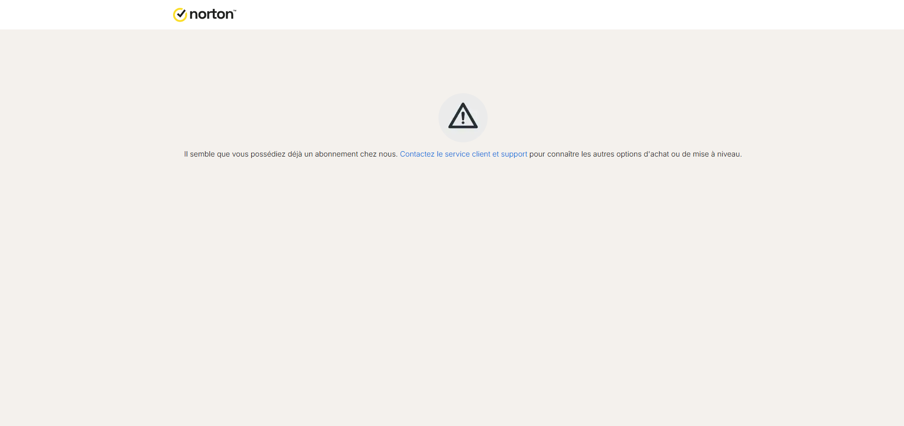

As such i decided to simply get myself a Norton VPN Plus subscription. So i headed to my account page, logged myself in, then headed to the Norton Products section, choose Norton VPN, Choose Norton VPN Plus, and the page shows me this
It says i already have a subscription and that i should contact support for a upgrade or other options of buyout.
Where the issue? Well… i don’t have ANY Norton VPN subscription, as a mentioned above already. So what do i do? I bet it’s the Norton Secure VPN existing inside the Norton 360 Advanced making this conflict…

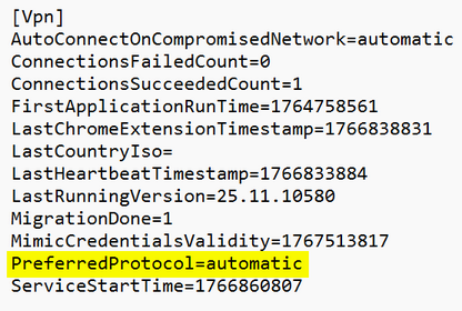

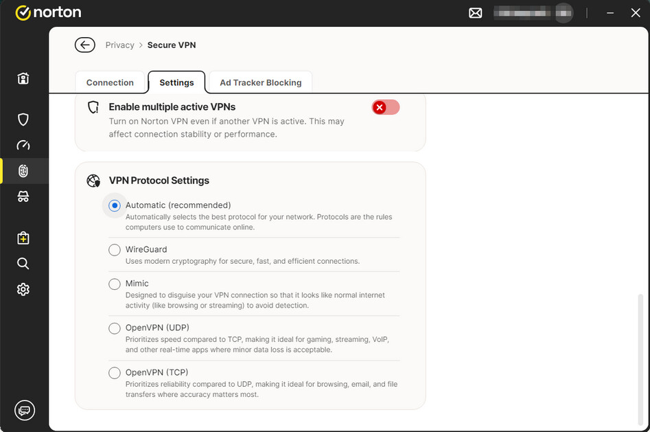

I found this online and tried it! It restored the protocols back to NortonVPN AND to Norton 360 Premium…
Edit the vpn.ini file (Community Tip)
Some users have resolved issues by manually adding a specific protocol to the vpn.ini file to force the protocol selection menu to appear. This is not an official Norton solution but is less risky than editing the registry directly.
  • Navigate to the Norton installation directory (e.g., C:\Program Files\Norton\Norton 360\).
  • Locate and open the vpn.ini file in a text editor (like Notepad).
  • Add the line PreferredProtocol=mimic to the file. This makes the protocol selection visible in the app settings, allowing you to select Automatic or another protocol.

In my Norton 360, the Vpn.ini file is located in the ProgramData directory.
AI Mode
Here is how to locate it:
Enable Hidden Items (Windows 10/11):
  • Open File Explorer.
  • Go to the View tab in the top menu.
  • In Windows 11, click Show and check the box for Hidden items.
  • In Windows 10, check the Hidden items checkbox in the “Show/hide” group.
Navigate to the ProgramData Path:
  • Go to the following directory:
    C:\ProgramData\Norton\VPN\
Locate and Edit vpn.ini:
  • You should find the vpn.ini file here.
  • Right-click the file and open it with a plain text editor (like Notepad).
  • Save and close the file.
Restart Norton 360:
  • Restart the Norton application for the changes to take effect. The protocol selection menu should now appear in the VPN settings.

fwiw ~ as test:
25.12.10659 (build 25.12.10659.961)

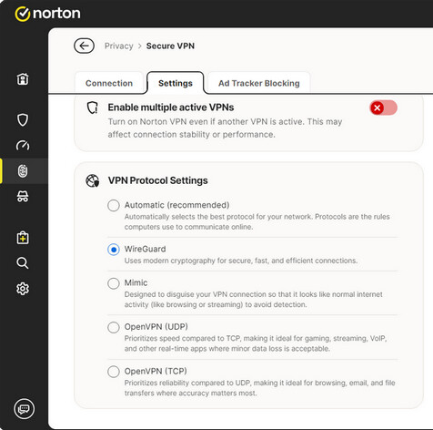

I am using WireGuard and I am very happy with the results compared to the other settings.
So, you’ve tested with “other settings”?
You prefer WireGuard vs Automatic.
Thanks for sharing.

fwiw ~ my VPN Protocol Settings…“tweak”…did not survive.
fwiw ~ as test:
Product Tamper Protection = disabled
Product Tamper Protection = enabled
as test: WireGuard
