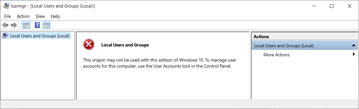

@kare2k Here is some good information regarding account types, their restrictions and how to see what the current permissions level is for the account you are using.
@SoulAsylum Thank you for the additional info. Is the information basically the same for Windows 10? I haven’t switched yet.
For Windows 10 its a tad different:
https://www.tenforums.com/tutorials/21680-determine-account-type-windows-10-a.html
@SoulAsylum Thank you again for your reply and instructions. I’ll work on that and get back to you.
@SoulAsylum OK … all went well until I got to Option 3:
Everything I check shows me as Administrator. Windows 10 was on this laptop when I purchased it, so I didn’t set that up, therefore, I have no idea how a password got there. I guess I could look up my set up notes to see if I have just forgotten it. Also, I remembered that Windows 10 had to be reinstalled in June 2024 with help from HP Support and thought you might need that information. Also, Windows changed my sign in options, so maybe that old password just doesn’t exist now. What’s weird too is that I hadn’t had any problems until June this year when I first posted about the authorization problems. Not sure what to do next. Thanks for your direction and assistance. Have a good evening.
