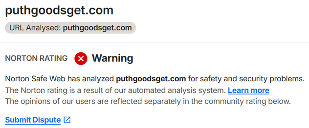

Since Norton Safe Web reports puthgoodsget.com as Warning, I’d be more concerned with why your browser is opening that site automatically. A new tab should normally open the browser’s New Tab page, not a third-party website.

Since Norton Safe Web reports puthgoodsget.com as Warning, please check whether the site has been granted browser notification permissions and remove them if present. However, because the issue occurs when opening a new tab, I’d be more suspicious of a browser extension or modified New Tab/startup setting than a notification permission alone.

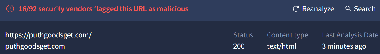

Since Norton Safe Web reports puthgoodsget.com as Warning and multiple security vendors flag the URL, I’d investigate why your browser is attempting to load that domain when opening a new tab. The site itself appears to present as a “New Tab” page. Please check browser extensions/add-ons, startup and home page settings, default search settings, and notification permissions. Also run a full Norton scan and a Malwarebytes scan to look for browser hijackers or unwanted software.
puthgoodsget.com has a poor reputation according to multiple security services and should not be trusted. More importantly, a browser should not be automatically opening that domain whenever a new tab is created. Please investigate browser extensions, startup/home page settings, search provider settings, and possible browser hijackers or unwanted software.

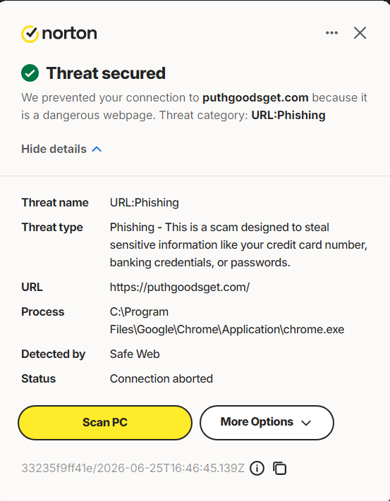

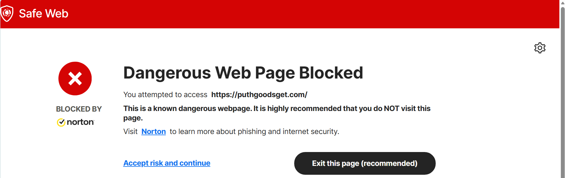

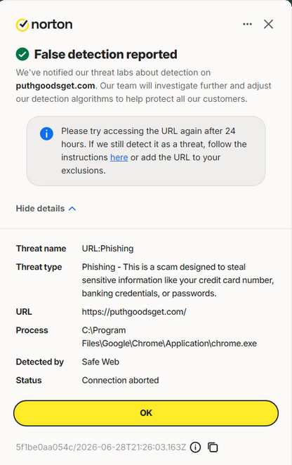

Norton is detecting puthgoodsget.com as a phishing URL. The immediate concern is determining why your browser is attempting to open that site whenever a new tab is created. Please check browser extensions, startup/home page settings, search settings, synchronization across devices, and run security scans to look for unwanted browser modifications.
puthgoodsget.com shows signs of being dangerous and appears designed to trick you into sharing personal information. The domain is also relatively new, which is often a warning sign.
Do not enter any personal details on this site. If you’ve already shared information there, consider changing your passwords and monitoring your accounts for suspicious activity.

https://puthgoodsget.com
33235f9ff41e/2026-06-25T16:46:45.139Z

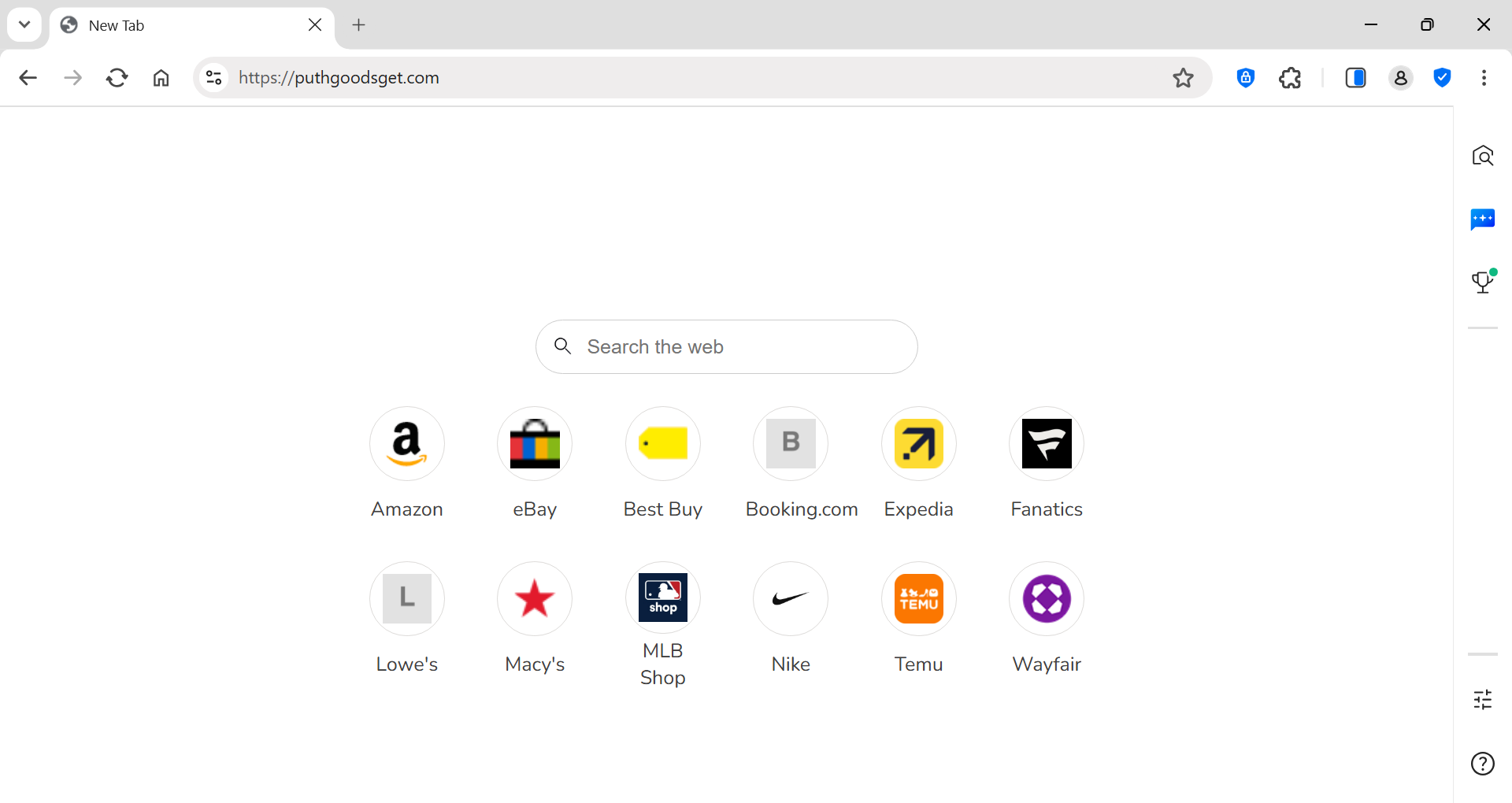

fwiw~ as test: Norton Safe Web/Web Shield disabled and the domain is allowed to load, the destination presents itself as a generic “New Tab” search portal with shopping-oriented shortcut links.
  • No footer.
  • No branding.
  • No operator identification.
  • No privacy link.
  • No terms.
  • Just a search box and monetized shortcuts.
That doesn’t automatically make it malicious, but it does make it difficult to establish any bona fides.
This helps explain why Norton formed a negative opinion of the domain. Security reputation systems don’t just look at malware. They also evaluate trust indicators, ownership transparency, behavior patterns, redirect activity, and associations.

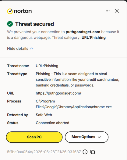

5f1be0aa054c/2026-06-28T21:26:03.163Z
