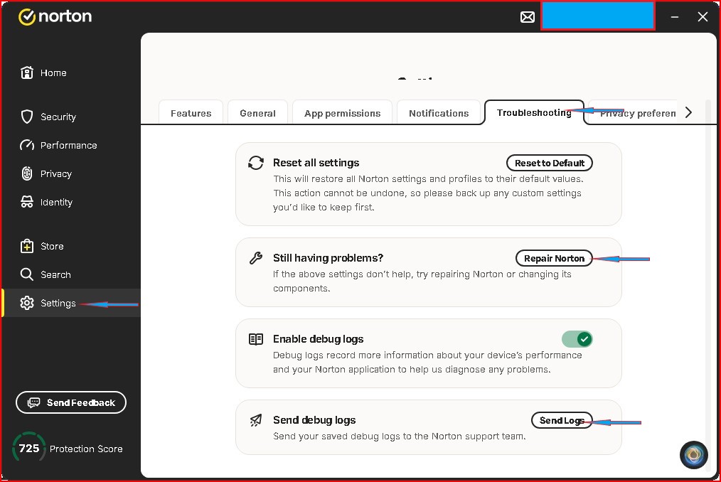

If you also have a free moment, check your systems event viewer for hints. I’ve found information there on several occasions that pointed me in the right direction for issues. Also give repair Norton a go to see if it will find/repair anything.
OK, I did the Repair and afterward RAM usage went back down to a reasonable 39MB. I just checked now, a couple of hours later, and it’s at 47MB. Will keep monitoring for signs of “inflation.” If it balloons back up to multiple GBs’ worth, I’ll report it here. (So, not ready yet to claim victory and call it Resolved!)
Was glad to see that Repair didn’t require a reboot. Didn’t even take that long to complete. If this is the way that function works, then it’s pretty good.
Thanks @SoulAsylum for the suggestion!
Thanks for the post back and status. The Norton repair usually fixes any corruption on installs and restarts to apply that fix. Keep us posted.
