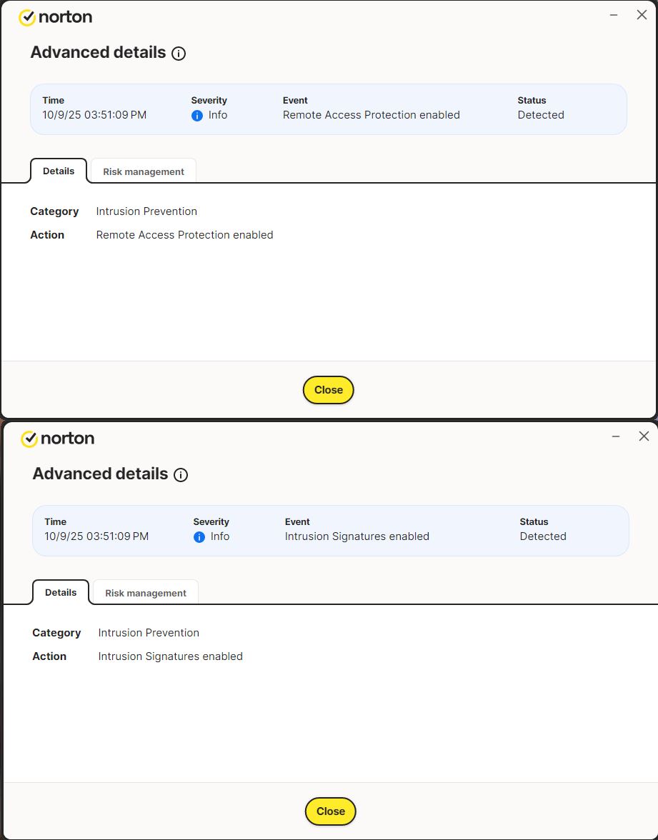

This problem is still ongoing. Checked that Norton is Up to date, Tried Firefox (up to date), Chrome (up to date), and DuckDuckGo (don’t judge me :laughing:), all trigger the same issue. No dropbox app installed on this computer, ever. Problem starts when I click ANY dropbox link from many source. Funny enough, this does not happen on my laptop, which is running the exact same software; links open with no problems there. I tried switching to wireless, disabling Norton’s Intrusion Signatures & Remote Access Protection, Disabling/Enabling network adapter, Releasing/Renewing IP, Flushing/Registering DNS, Unplugging/Plugging network Cable, Disabling/Enabling the relevant port on my switch, and NOTHING brings back internet connection on this machine (other than a full system restart). I don’t know how Norton is handling the connection to this specific website or attempting to communicate with the app (which is not on my computer), but it sure as hell has caused me hours of lost productivity.
Running Windows 10 pro. Norton 360 Premium

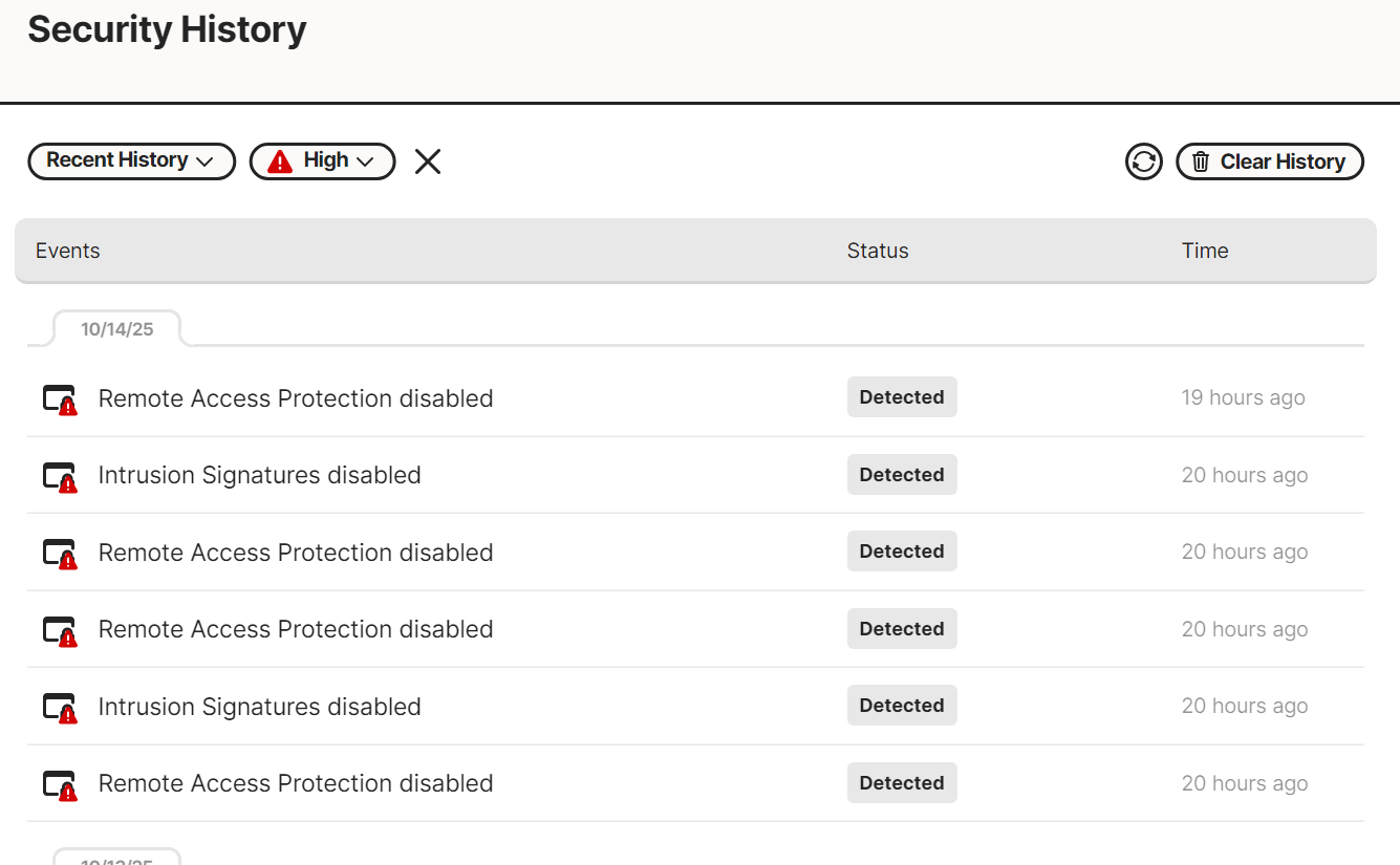

I’m having the same issue. Norton shows that intrusion detection was disabled, and remote access protection is disabled. I have no internet. Every time I click on a drop box link my internet goes down on all browsers.

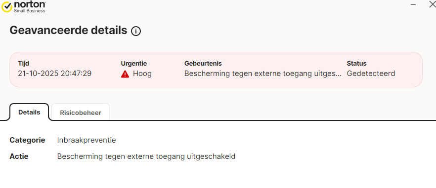

Same problem here, Norton Small Business, visiting dropbox[dot]com is killing the internet, resetting anything doesnt work only a reboot.
When can there be a solution?

Thank you for reporting this issue. We have fixed it in Norton Security 25.10.10528 for Windows. Thank you.
