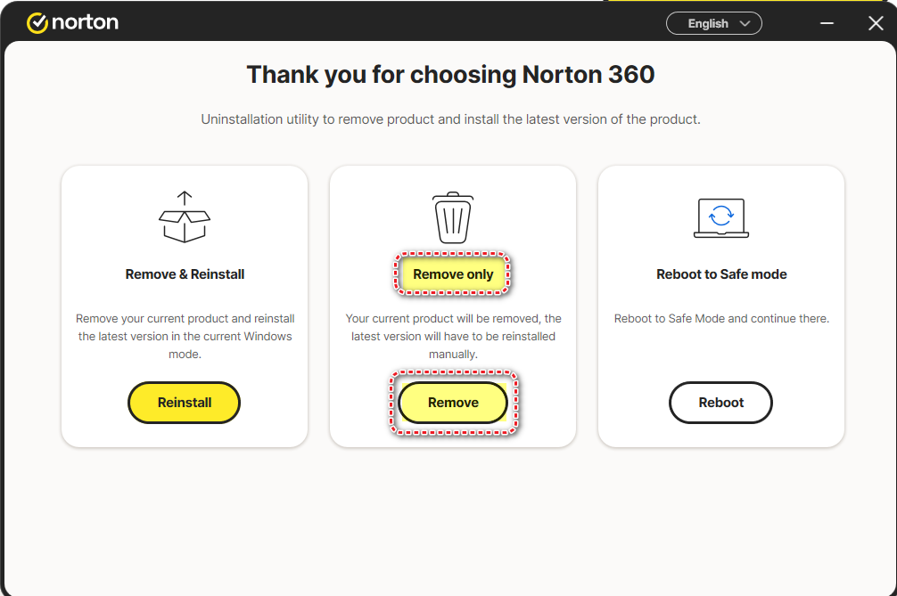

and with Norton_360_Remover tool - Remove only → scour for remnants
can you opt Windows Defender Firewall → Restore defaults → do you have net access?
Norton_360_Remover https://www.norton.com/nortonremover

  • “and with Norton_360_Remover tool - Remove only → scour for remnants” I used the program NRnR.exe to uninstall Norton 360, with the result that I no longer had internet access.

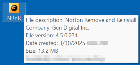

Did you run Norton Remove and Reinstall tool or Norton 360 Remover tool?
Did you use Remove only?
Yes, they both appear to open the same window
But, Norton support (fwiw) told me NRnR tool is for v22 and Norton 360 Remover tool is for v24/25?

  • Did you run Norton Remove and Reinstall tool or Norton 360 Remover tool? Did you use Remove only?” I started with Remove and Reinstall, but the reinstallation of Norton 360 was not possible because I lost the internet connection.
  • But, Norton support (fwiw) told me NRnR tool is for v22 and Norton 360 Remover tool is for v24/25?” Unfortunately, I used the NRnR tool; I wasn’t aware of the Norton 360 Remover tool.

Do you want to try Norton 360 Remover tool? - Remove only → scour File Explorer for remnants…and then try Windows Defender Firewall → Restore defaults
