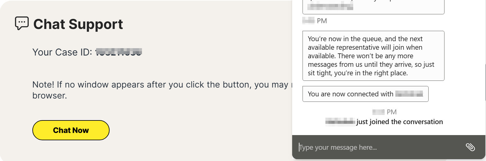

fwiw ~ I’ve never had an issue reaching live Chat support agent – regardless of which product I select. If you want to reach a human support agent. Simply get past Norton’s attempt to push DIY help articles and Norton’s attempt to gather telemetry. If your goal is to reach a human support agent. Just click any presets or whatever satisfies you. Your goal is to get past Norton bots/presets and such.

May be best – for you – to document/report “issue” directly via Norton support.
Norton support will likely request remote session – to see – as you see.
Note: for an official Norton support response – open a support case:
Contact Norton Support → Let’s get started.

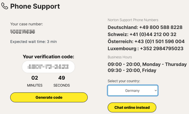

Hello @Andre_Korb
The published business hours clearly apply to the listed phone numbers. Norton does not appear to publish separate Chat hours on that page, so it is unclear whether Chat follows the same schedule or is routed through a broader support network with different availability.
The published business hours on the Germany support page apply to the listed phone numbers. If those hours don’t fit your schedule, you could try the Chat option during the evening or weekend and see whether agents are available when you’re online.

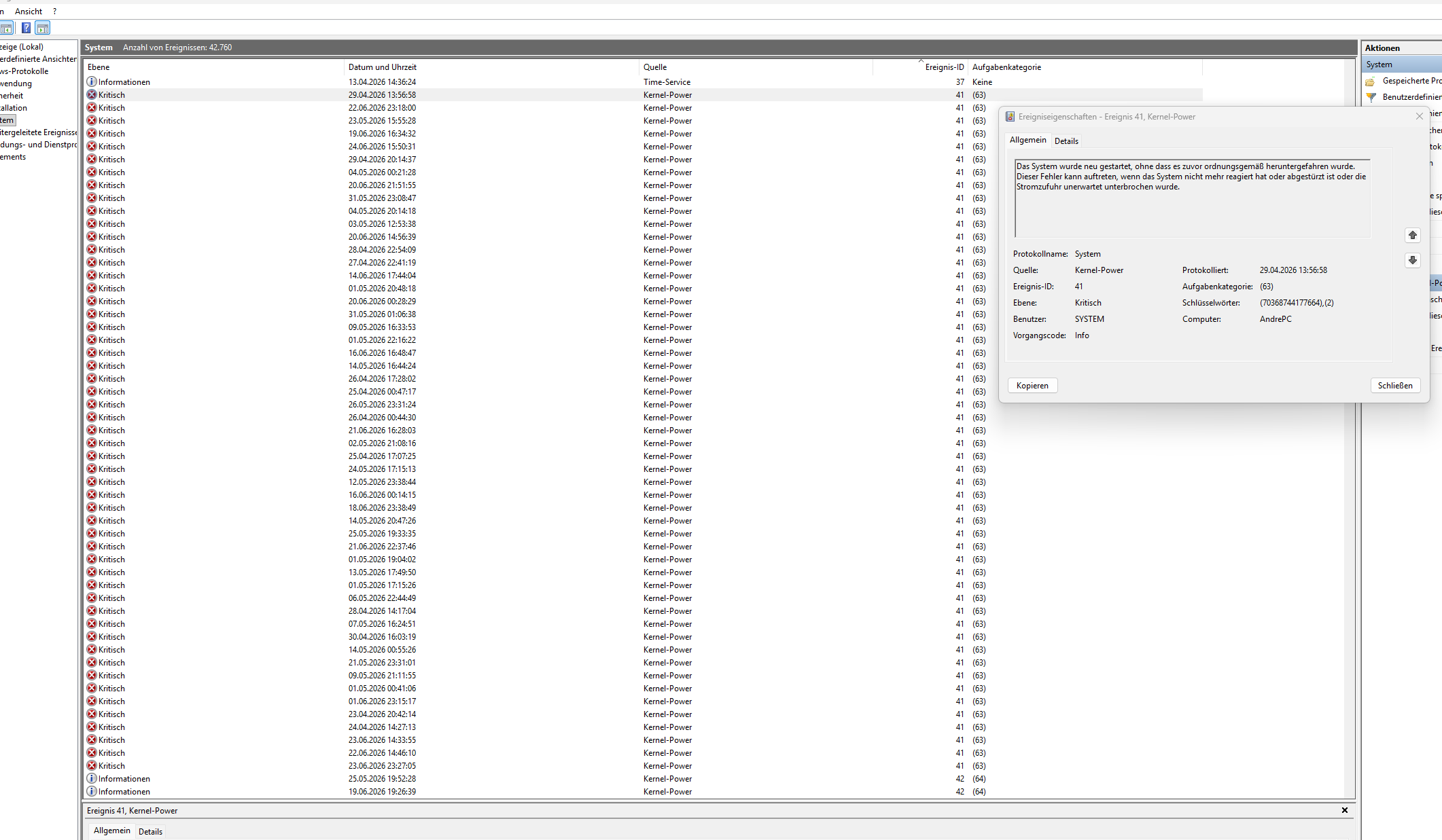

@Andre_Korb @SuperDaniel_274_de @wtj87 Just an observation from an event that happened to me this morning. Would each of you open your Windows Events Manager and look for an event ID 41 being logged, and filter manager entries prior to that. Also, check your Norton history for entries to corelate with those time stamps in event viewer.

That’s really interesting, because yesterday I lost my program control list again and after checking the Windows Events Manager, there was an entry with event ID 41 a few minutes before.
Since March 2026, I have 25 entries with ID 41. If I had to guess, that would be roughly the number of Program Control failures/loss I’ve had in the meantime.
ID 41: “The system has rebooted without cleanly shutting down first”
My BIOS is up-to-date, also all drivers. Win 11 Pro with all updates.
Thank you, W.

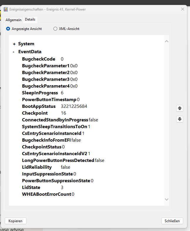

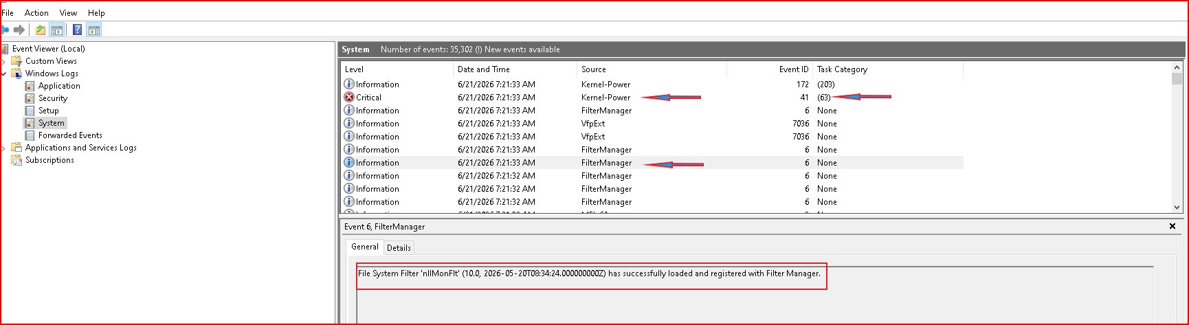

@wtj87 Opening one of those event ID 41 entries and reviewing what does this tell you? Does the entry(s) contain the statement where you see “nllMonFlt” within it? This should show under event ID 6 and, does it correlate with the time stamp of the event 41 entry? If so, I have already reported it and have a support file with an ID. Please advise.
