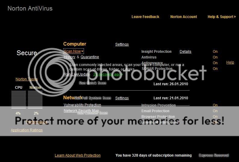

Hello,
I have been searching both Norton's own website and the net for possible solutions without success. My Norton AntiVirus have, whithout any reason I can think of, turned black / transparent. The buttons are still there and possible to use, as long as you know where they are, however it is quite annoying.
http://i661.photobucket.com/albums/uu337/Zimriz/NortonAntiVirusProblem.jpg?t=1264532075
As you see in the link, it is a screenshot of my Norton AntiVirus userinterface. What you see here is that I have pushed the 'Scan Now' button, so you can see that the list that appears is transparent, and that the majority of the interface's graphics have turned black.
Please do respond to this, and feel free to ask questions - I will try to answer them.
Thanks!

I don't use VISTA but it and Windows 7 do have a setting that is something to do with transparency (part of Aero?) and I wonder if that is doing something to your display of the Norton screens.
This is what I see in XP Pro when I click on Scan Now which I think is what you did and show?
I'll go and have a look in WIN & to see if it comes up any different but from memory it looks like that there also.
I'm in WIN 7 32 bit now and the screen looks just the same so I doubt it is anything to do directly with VISTA but it might be a setting?

It may have left some traces or it may be in that Aero effect I refered to. I'm not sure where it's settings are in VISTA but you could Right Mouse Click on a blank part of the desktop and look for Appearance or similar; or go into Control Panel and look there, possibly Display ....

I have Windows Vista Ultimate 32 Bit and I'm sure it's nothing with Aero, because without Aero the problem is still there.
Any help would be very nice, it's very strange.
I have another PC with Windows 7 Ultimate 32 Bit NIS 2010 17.5.0.127 and there alle works fine.

Indeed mkpcxxl, I am not using the Aero effect in my settings, so it is not that.

Do you know if you have the latest drivers for your video card?
After I rebooted the PC, it did update twice. The updates were bigger than normal "fixes", though on Help and Support > About it says I still got version 17.1.0.19. Tried the Run LiveUpdate option and it states I got the latest updates.

Julie -- I know you said you are on VISTA Home Premium but have you installed any/all the Service Packs? If you need to check this -- Hold down WINKEY and PAUSE (usually up top right of the keyboard) and it brings up System Information with details of your Windows -- that should show Service Pack 1 or 2 . BTW YOurs is 32 bit WIndows not 64 bit? Almost certainly is 32 bit but please check on the same screen and see if it says 64 bit.
Sorry if you posted this already.
If you aren't uptodate on the Servivce Packs and on your Video card driver it would be worth doing that.
On the updating to version 17.5.0.127 you seem to be in a similar position to my XP Pro recently which downloaded the two substantial updates (63 and 16 MB I think) but would not change version ID -- if you click on the Show details after  LiveUpdate finishes -- not those exact words I think but the meaning is that and it's a blue link that comes up a while after the screen says Completed!
If you look in there I bet you will find one entry about an Engine upgrade cannot be completed.
What I did was, as soon as it became available on line the other day, to download the complete NIS 17.5.0.127 file and install lthat on top of the existing 17.1.0.19 installation. The new one will say it's found an earlier version and is going to remove it and will then work, reboot and finish the installation and Bingo I had 17.5.0.127 AND the Outlook Express OffLine bug was fixed.
New NIS 2010: Click on this link NIS 2010     This will download a single 90+MB file which you should save on your hard drive where you can use it again if necessary -- Do not select Run but use Save when asked and remember where you put it!
That link is for the USA/CAN version -- if you are located elsewhere then adapt it to your local Norton Website, usually by adding the 2 letter country code somewhere in the URL.
Hope that helps and not confuses .....

I recently ran into more problems with Norton. It couldn't fix itself after a resart with a few complications. So I ran the Norton Removal Tool to get it completely off the PC, and then simplt reinstalled it and ran the updats. Now it is working! Don't ask me why I didn't do this earlier, I have no idea - I suppose I expected I'd run into problems then too, as I have done previously (with older Norton).
