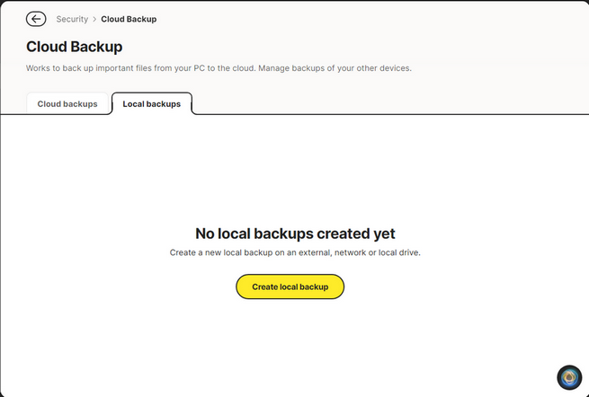

Not sure just what features you are looking for, but you did mention local backups. That feature was restored some time ago. There is still no Norton Backup Drive in Windows Explorer.
Norton 360 Local Backup Summary
According to official Norton documentation and technical support updates for the 2025–2026 product versions, Local Backup remains a core feature of Norton 360, though it is now integrated into the “Cloud Backup” module.
Key Technical Details from Official Docs
  • The “N360” Folder: When you back up locally, Norton does not create a simple copy of your files. Instead, it creates a folder named “N360” on your external drive. This folder contains encrypted, chunked data that can only be read or restored through the Norton software.
  • Engine Rewrite (2025 Warning): As of mid-2025 (version 25.5 and later), Norton updated its backup engine. Official documentation notes that local backup sets created with older versions may be incompatible with the new engine. If your old backups are missing, you may need to create a new “Backup Set” specifically for the new version.
  • No Storage Limits: While Cloud Backup is limited by your subscription (e.g., 50GB or 100GB), Local Backup is limited only by the size of your external drive. Norton does not charge extra or limit the volume of data backed up to local hardware.
  • If the drive is a network-mapped drive, it may require a “Full Trust” setting in the Norton Firewall’s Network Trust level to be visible as a backup destination.
  • Check if the drive is recognized by Windows File Explorer; if Windows can’t see it, Norton won’t either.
The “Norton Backup Drive” that used to appear in Windows File Explorer (under “This PC” or “My Computer”) has undergone significant changes as Norton transitioned from version 22 to the newer v24 and v25 architectures.
What Happened to the Drive? :hammer_and_wrench:
In older versions like v22, Norton created a Virtual Shell Extension that looked like a hard drive in Windows Explorer. This allowed you to browse your cloud and local backups as if they were regular folders.
  • The Engine Rewrite (2025): Around June 2025, Norton released version 25.5, which included a complete rewrite of the backup engine.
  • Removal from Explorer: In this new architecture, the virtual “Norton Backup Drive” was removed from File Explorer. Norton moved all backup management directly into the Norton 360 app interface.
  • Incompatibility: The new engine is often unable to see or manage “Backup Sets” created with the old v22 engine, causing the drive and the associated data to seem “lost” even if the files still exist on your disk.
Current Limitations :warning:
The removal of this drive has caused several functional changes that long-time users find frustrating:
  • No Individual File Deletion: Without the Explorer drive, you can no longer right-click and delete a single specific file from a backup set to save space. You can generally only delete entire backup sets now.
  • Encrypted Storage: Local backups are now stored in a folder called N360 on your external drive. Unlike the old system, these files are “chunked” and encrypted, making them impossible to browse without the Norton app.
How to Access Your Backups Now :laptop:
Since the drive is gone, you must use the internal Restore feature to see your files:
  1. Open Norton 360.
  2. Click the Cloud Backup tile (even if your backup is local).
  3. Select Restore Files.
  4. Click View All to see a list of all your backup sets (local and cloud).
  5. From here, you can browse the file tree and select items to restore to their original or a new location.
Pro Tip: If your old local backup set from v22 is not showing up in the new version, it is likely because the new engine doesn’t support the old format. You may need to create a new Backup Set and run a fresh backup to ensure your data is protected under the current version.
