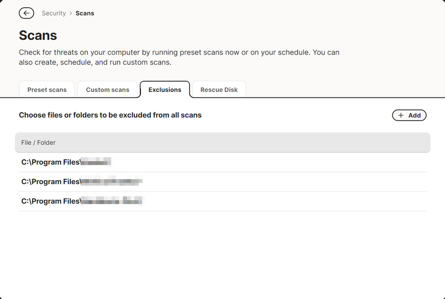

Where do I check to add Antivirus & Scans Exclusion?
I do not know what you mean by " Can you create work product folder and exclude folder with Antivirus and Scans?"
I was wondering whether you can work from (use your Development app) an excluded folder. Maybe, your Development app need access to the live system.
OK when I exclude the folder, I do not get the error but when I try to compile, it attempts to compile, and then just exists. The only way I can get the compile to work is disable Auto Protect.

Actually I have this resolved now. Looks like I was using the wrong folder to exclude scanning.
It is working now. Thanks for your help.

The key is to create one master folder for all your projects. Then exclude that folder from the noted scans.
