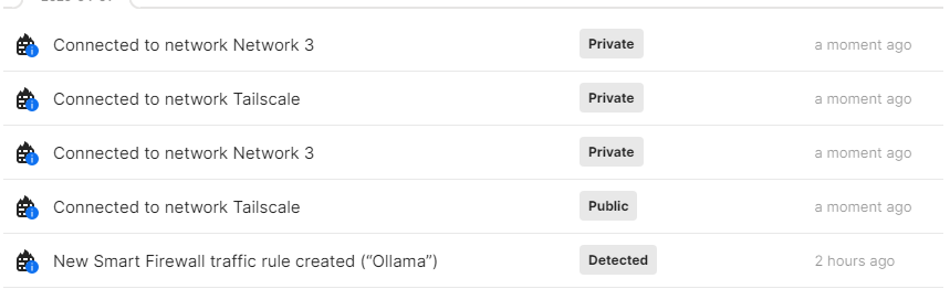

Can you post a screenshot of the block within your Norton History for review? Thanks in advance.
no blocking messages , just the changes I made.
Wondering if this info may help!! From what I view Norton isn’t blocking Tailscale. Can you assist us with specifics of the rule you created for Ollama as well?

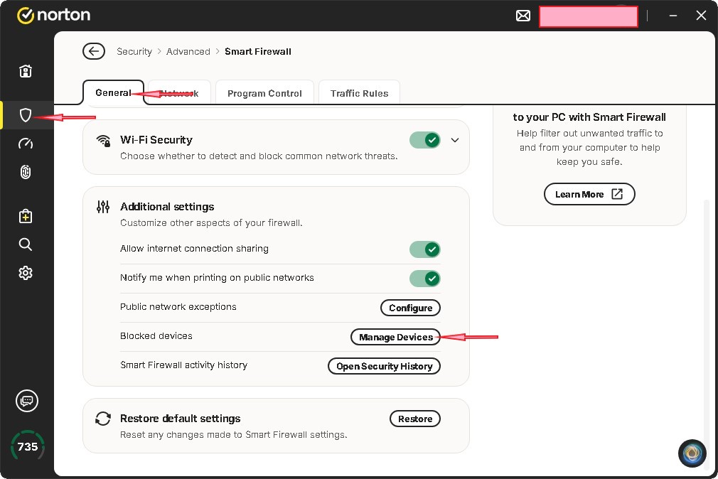

The only setting within the Norton firewall I can recommend checking is below.

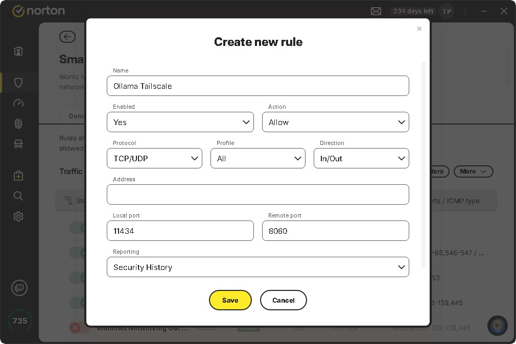

allowed TCP 11434 , in and out, ip blank. I tired with tailscale ip as well . I even did a test , I forwarded the port from 11434 to 8080 and port 8080 works. traffice passes.. norton is blocking port 11434

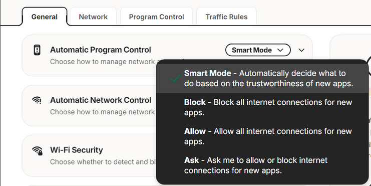

  1. Disable “Automatic Program Control”
    Norton’s Automatic Program Control can sometimes supersede manual port rules if it doesn’t “trust” the application using the port (like ollama.exe).
  • In the Smart Firewall settings, find the General tab.
  • Toggle Automatic Program Control to Off.
  • When prompted, choose “Until I turn it on again.”
  • Try the connection. If it works, you need to manually set the specific program to “Allow” in the Program Control tab.

Thanks. In the rule you created edit again and add UDP to TCP. Retest.
Re-Order the Rules. done that already.
Disable “Automatic Program Control” you cannot disable this. Norton does not have that option.

Allow | Ask

I wasn’t referring to re-ordering rules but rather editing the one you created to appear something like the one below:
Hi I already tried that. I tried so many different combinations. created multiple rules as well.. You should est it on your side and see for yourself. ollama on docker on windows good luck.
