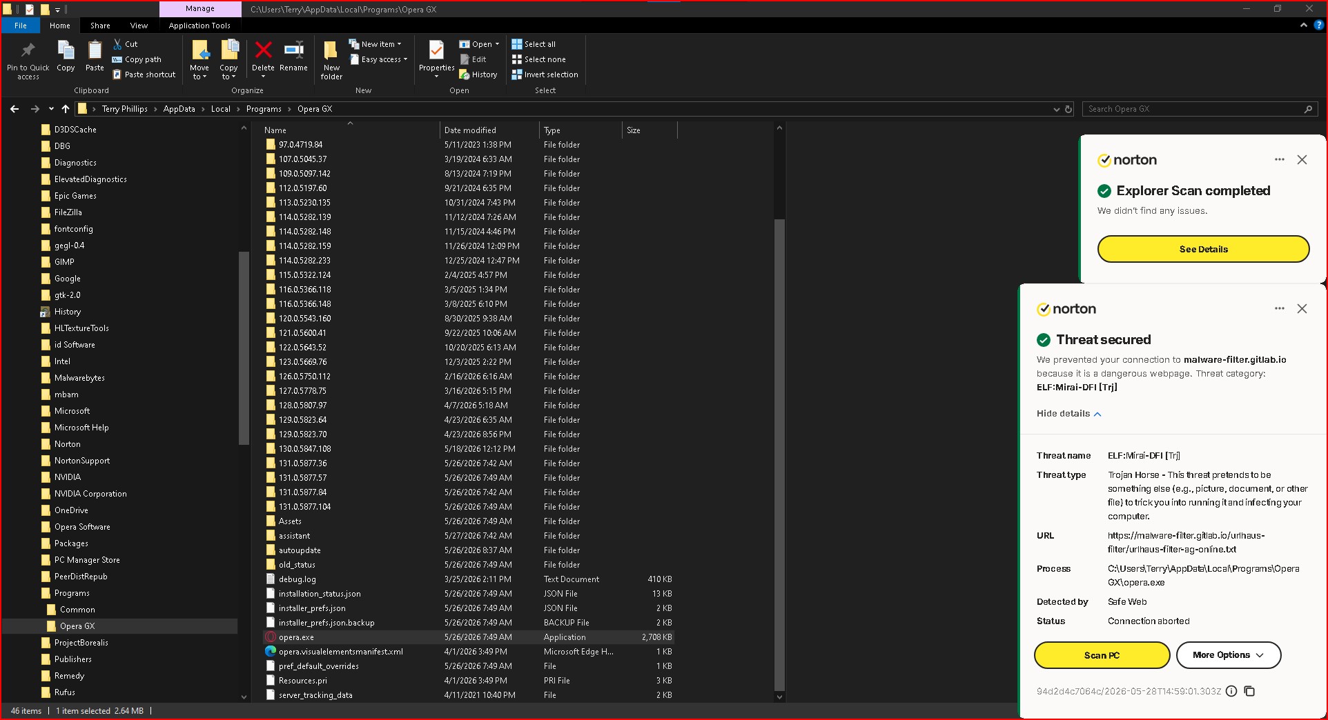

Incredibly frustrating issue where Norton is popping up an alert informing me it has blocked a text file from loading. This file is related to uBlock Origin’s Online Malicious URL Blocklist.
uBlock fails to load the list because Norton is blocking it, leaving me potentially vulnerable.

What browser? Do you have a screenshot to share? Just a bit ago, I am seeing something similar with Safe Web nailing a URL from Github ( text file no less ) and, purporting Opera.exe is infected. Happens every time I open my browser and/or open a new tab. VERY annoying. I have reported it as a false positive after having ran scans with RKill, Malwarebytes and MetaDefender services.

My screenshot is the same as yours only I use Firefox. I have also reported it as a false positive. This is super annoying. Absolutely zero issues with Norton and uBlock Origin prior to this.
Amen to that, allow me to push this to an Admin who is also a Norton employee to see if we can get some action regarding a fix. I have cleared ALL cookies and caches on both Edge and Opera GX, cleared system temp files repeatedly as well and rebooted several times. Thanks for posting back.
@@Selvakumar.S This is a super annoying plain as the nose on our faces, false detection, purely AI in the cloud. Please ask someone your side to have a look. I have done the homework already so its not an infection to the OS. The is labeling the executable for my browser as something its not. Thanks in advance.

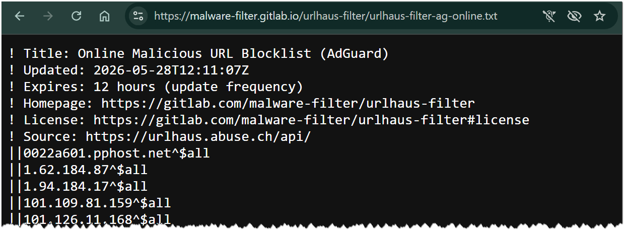

Um, is this the address you’re calling?
https://malware-filter.gitlab.io/urlhaus-filter/urlhaus-filter-ag-online.txt
Yes. This is working for me now. Just forced an update and it was successful.
That is the same URL my side with the last t missing. My side its Safe Web not UBlock Origin.
